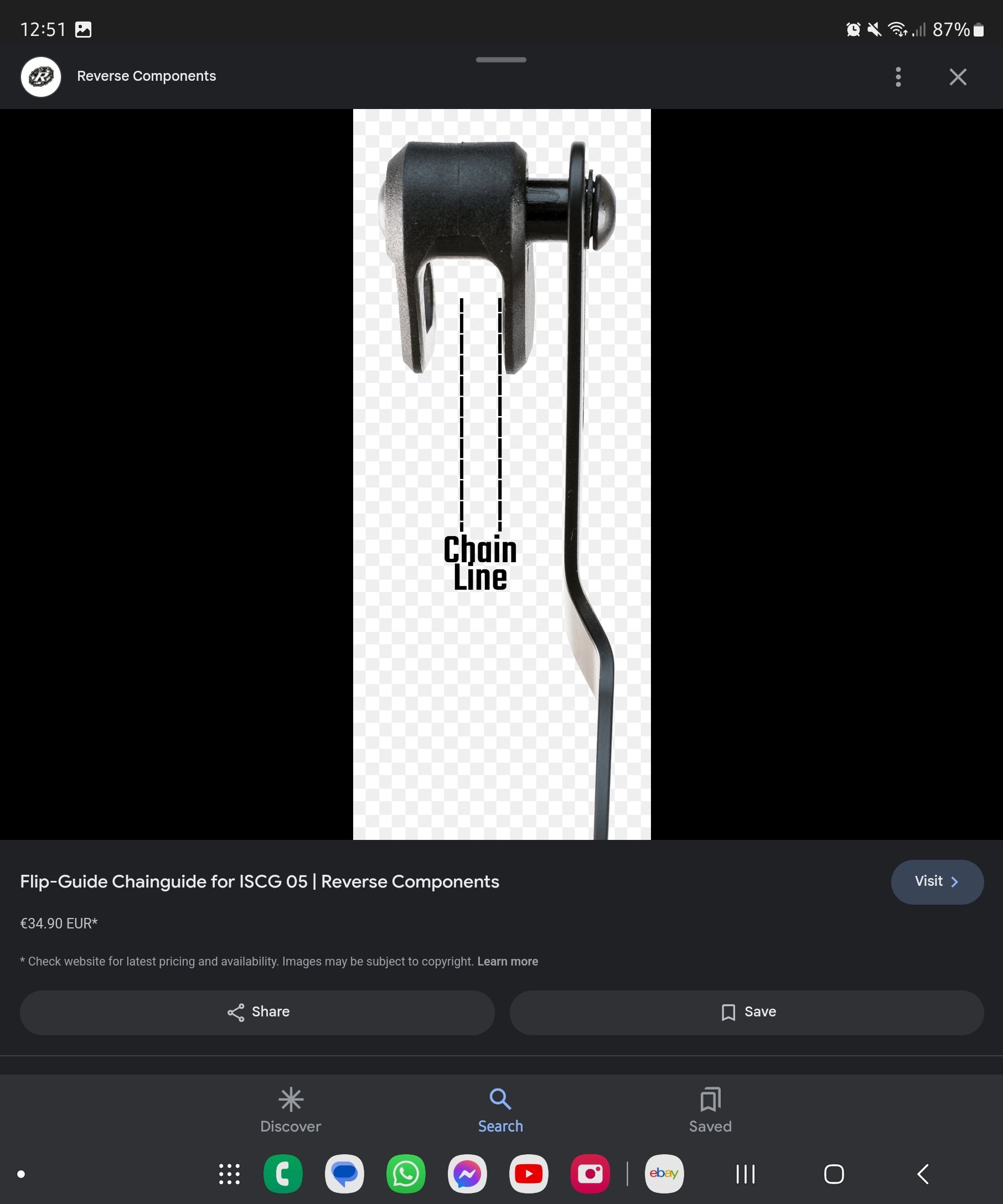

I used "REVERSE Components Chain guide ISCG 05" which fitted using the original bolts (on 2022 Trek Rail 5). Flips up when you want to clean or take the chain off the chain ring.

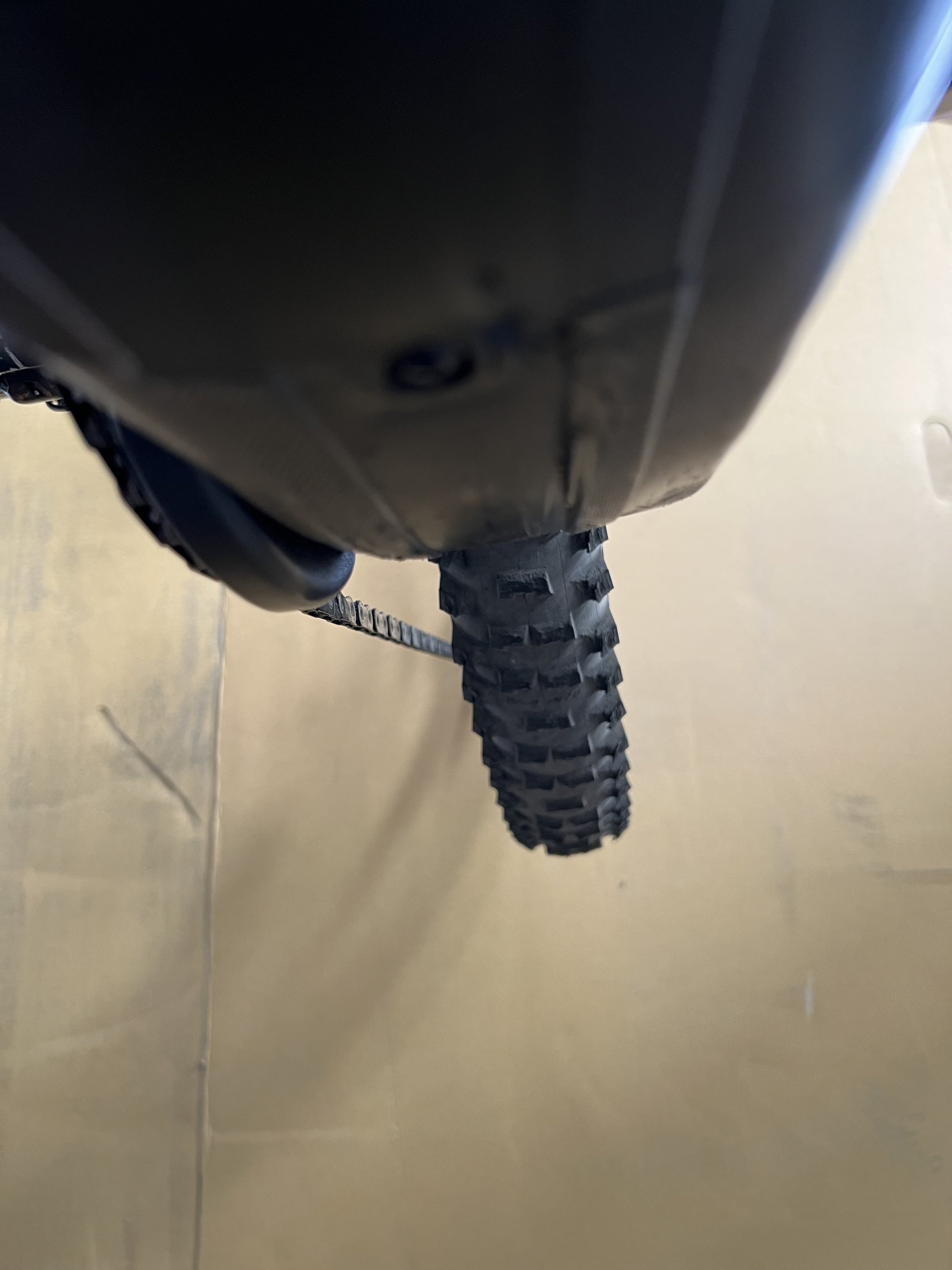

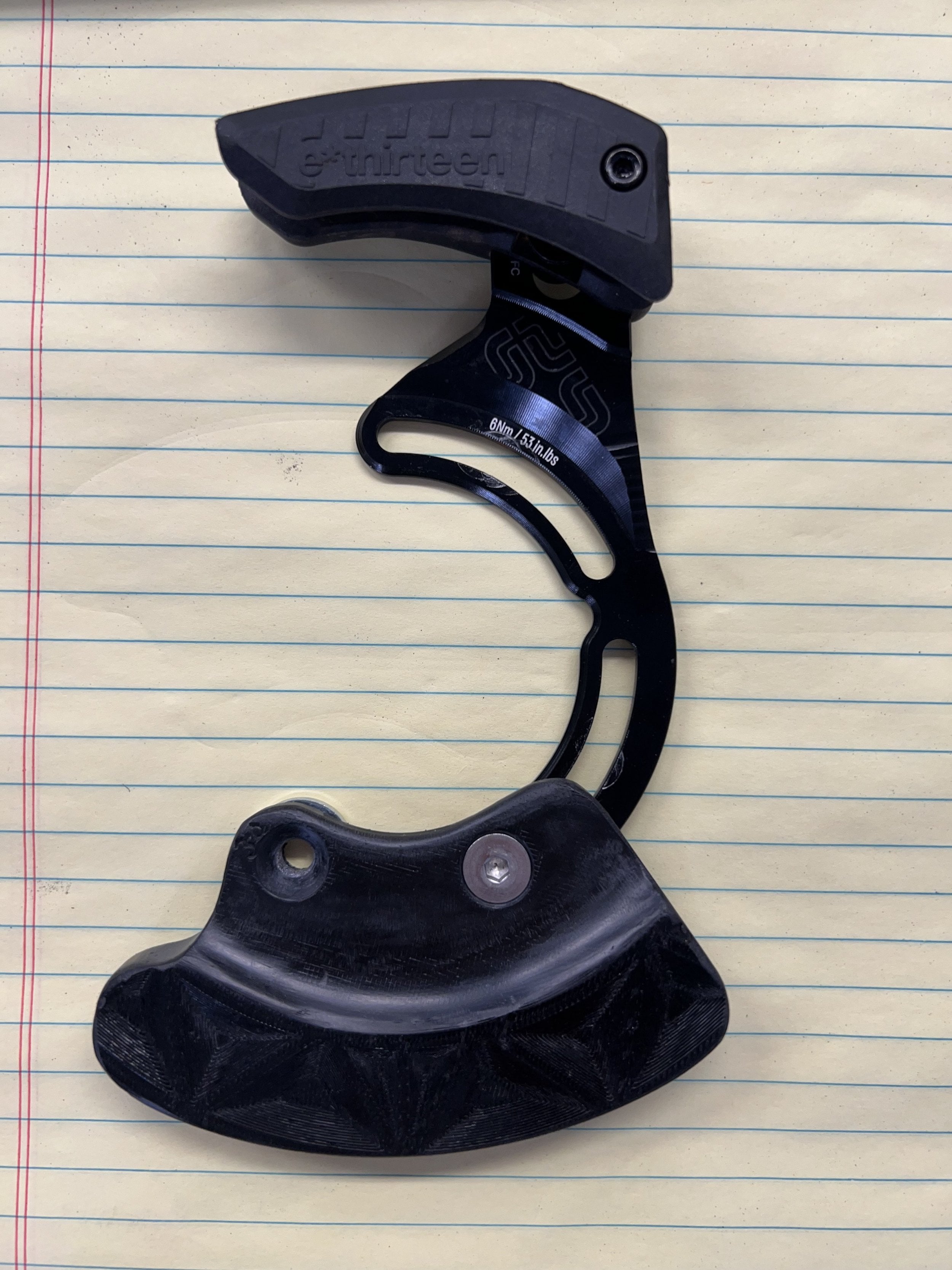

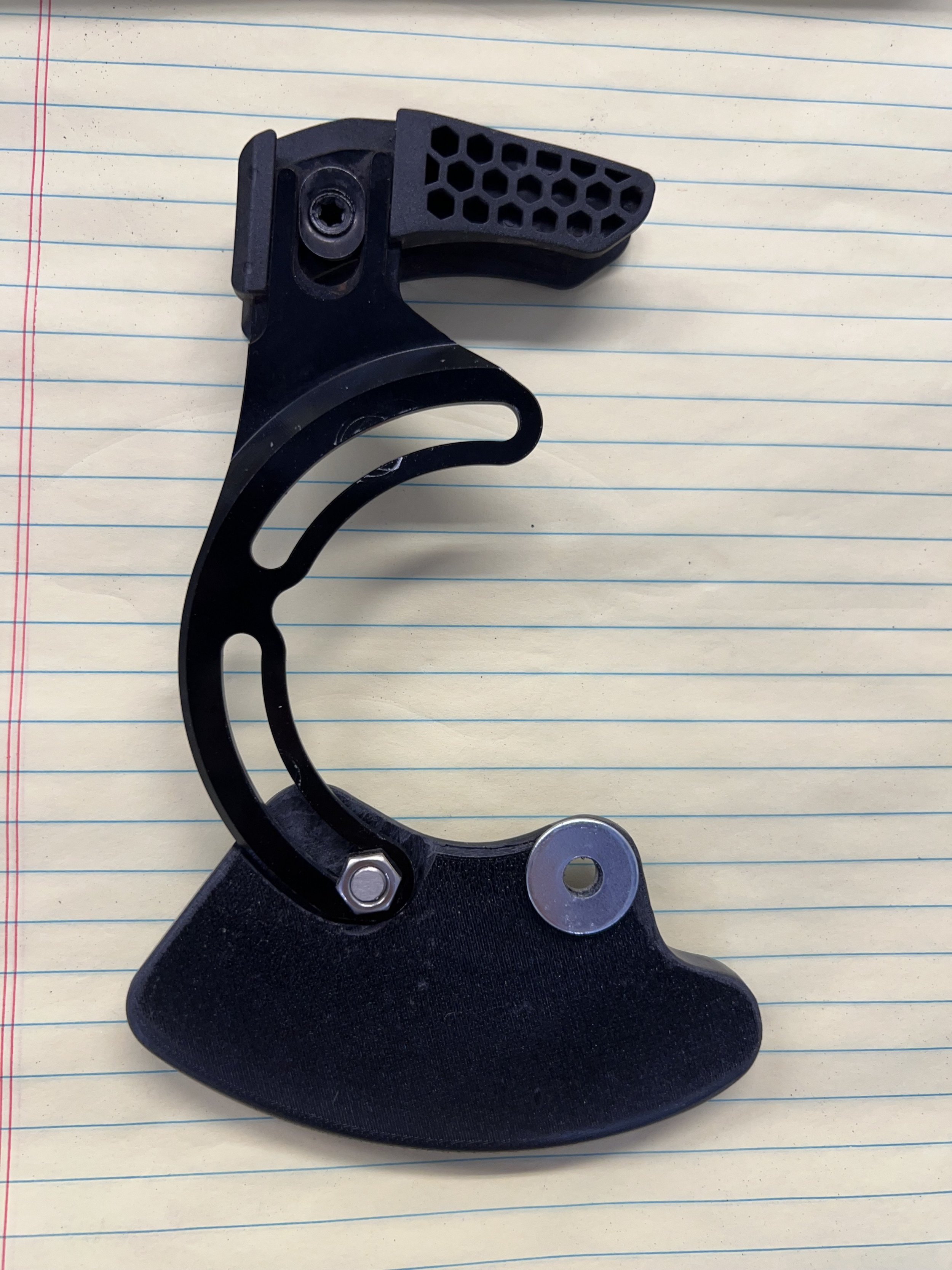

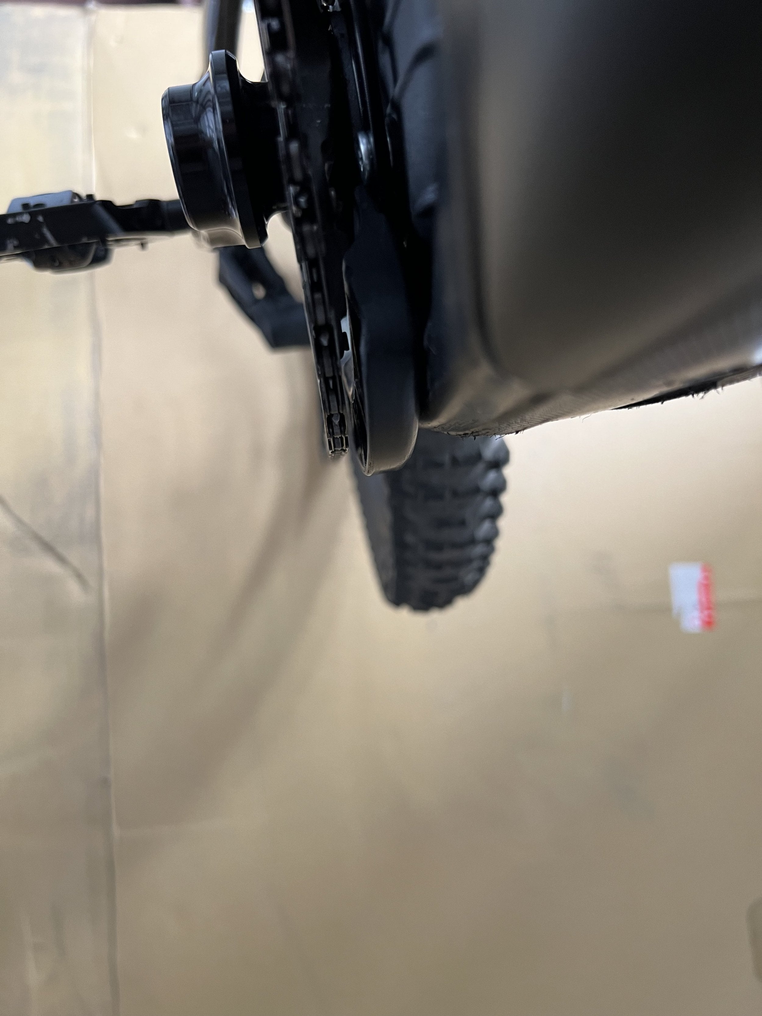

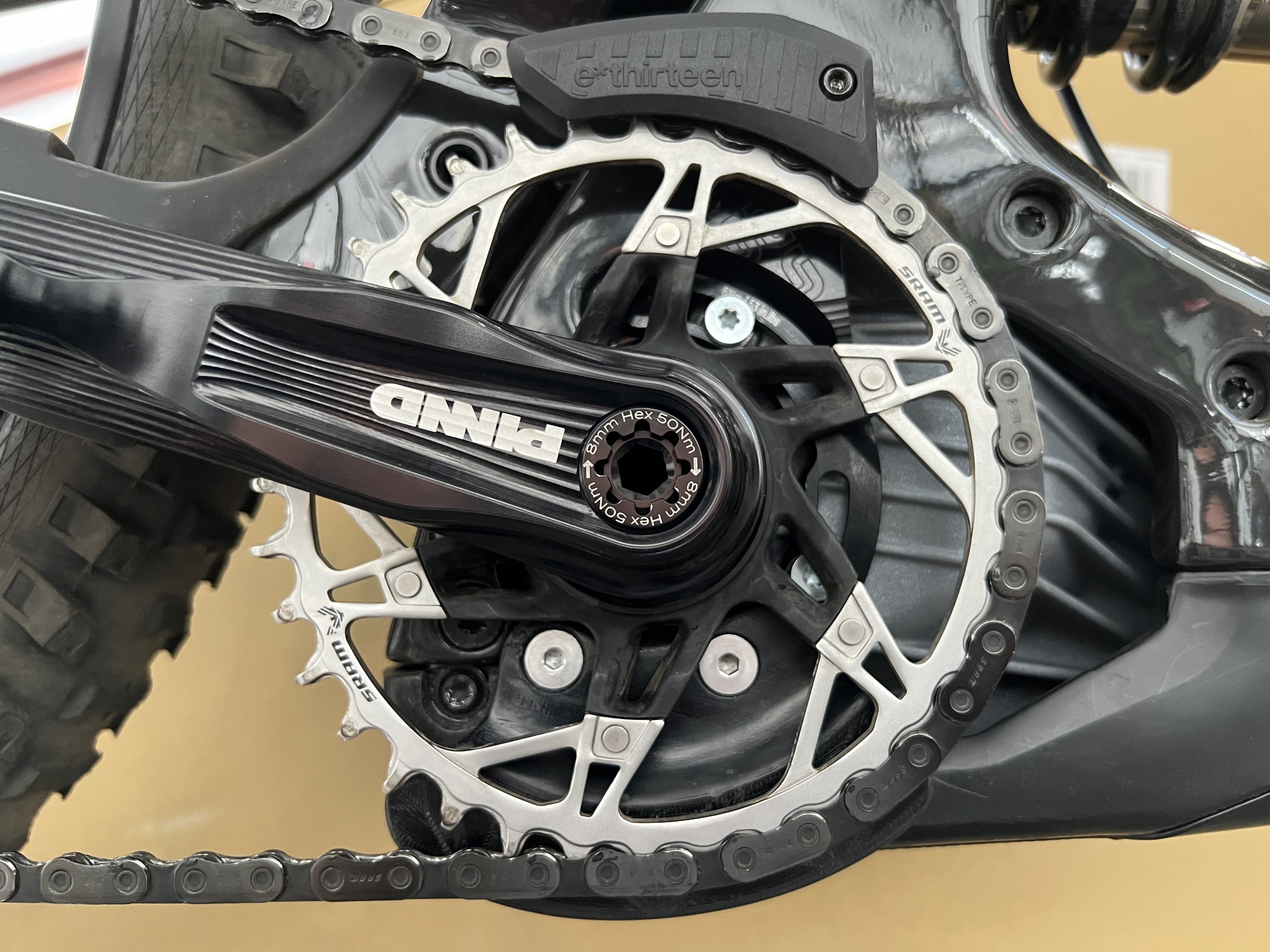

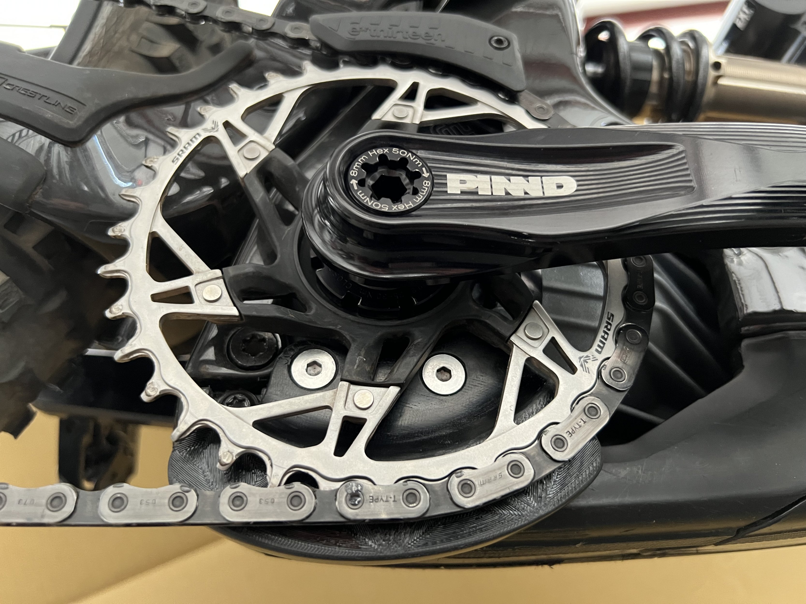

I ended up purchasing a 3Pinnovations printed BashGuard and modified it to bolt to my existing e*thirteen mount. The other bolt threads into an unused threaded motor bolt hole. Luckily I bought several of these bashguards and modified them all so I can replace as needed. They are now unavailable on Amazon, and my first one installed has already taken a few hits…..better than my chain and chainring.
IMG_6657.jpeg IMG_6656.jpeg IMG_6664.jpeg IMG_6672.jpeg IMG_6665.jpeg IMG_6666.jpeg
I'll take a look at that one cheers, I have the cube action team the carbon frame cones out past the motor at the top a good half inch so with the nukeproof one and others I'm thinking I may need 3 bits of tub ING ti use as spacers from the motor mounts to bring the plate out and inline with the rear of the chain ring. I'll maybe try 3D print one as a prototype just to check the actual fitting as looking at the frame I'll be lucky to get one on the cube stereo from the BB area! There is 2 mounting holes for cubes own in the frame around whare you would find a front mech but in the fat carbon seatpost, I might go for the easy option and put an outter solid disc round the chain gaurd like on old DH bikes I had
View attachment 134732 View attachment 134733 View attachment 134736 View attachment 134737 View attachment 134738 View attachment 134739
Perfect that one
Found this it should fit the cube stereo it's the bend I need to clear my frame as wide over top of motor thanks for everyone's help
