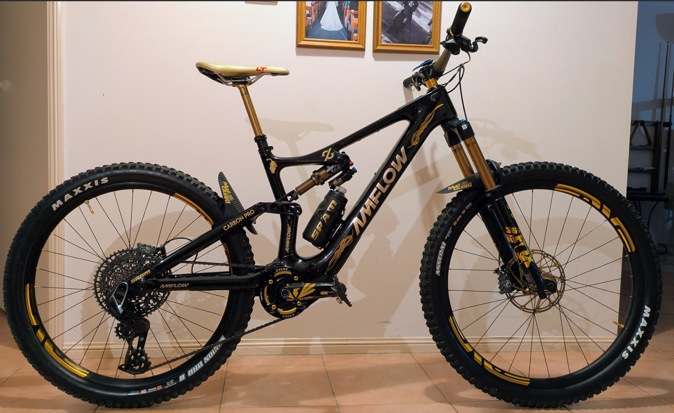

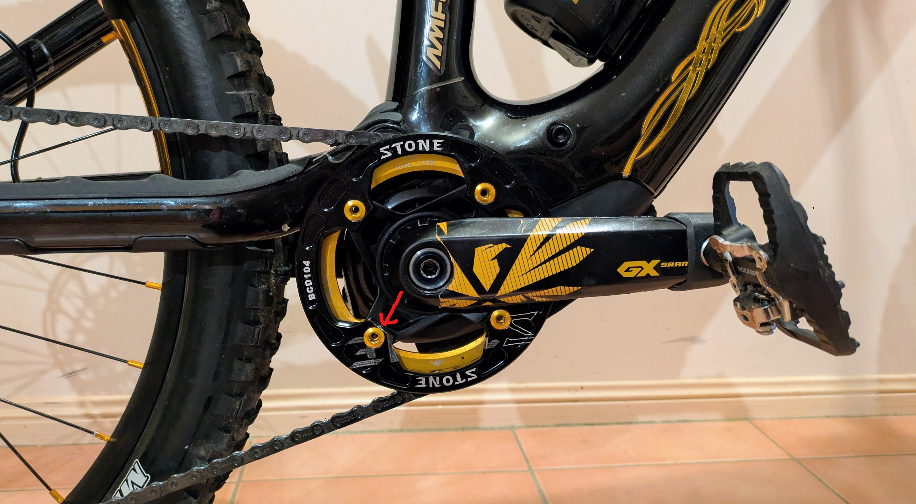

I have mounted it on the outside of the spider and left the original amflow cranks on, and there was the tiniest rub along the 4 edges where I've marked in red. I filed these edges down, then touched up with paint and it fits perfect.
I have the 34T MOTSUV alloy chainring, and the height is damn near perfect. 1.5 - 2.0mm higher than the chain.
I think it looks fantastic too with the gold chainring bolts. Much better than the all gold Chainring Guard.
