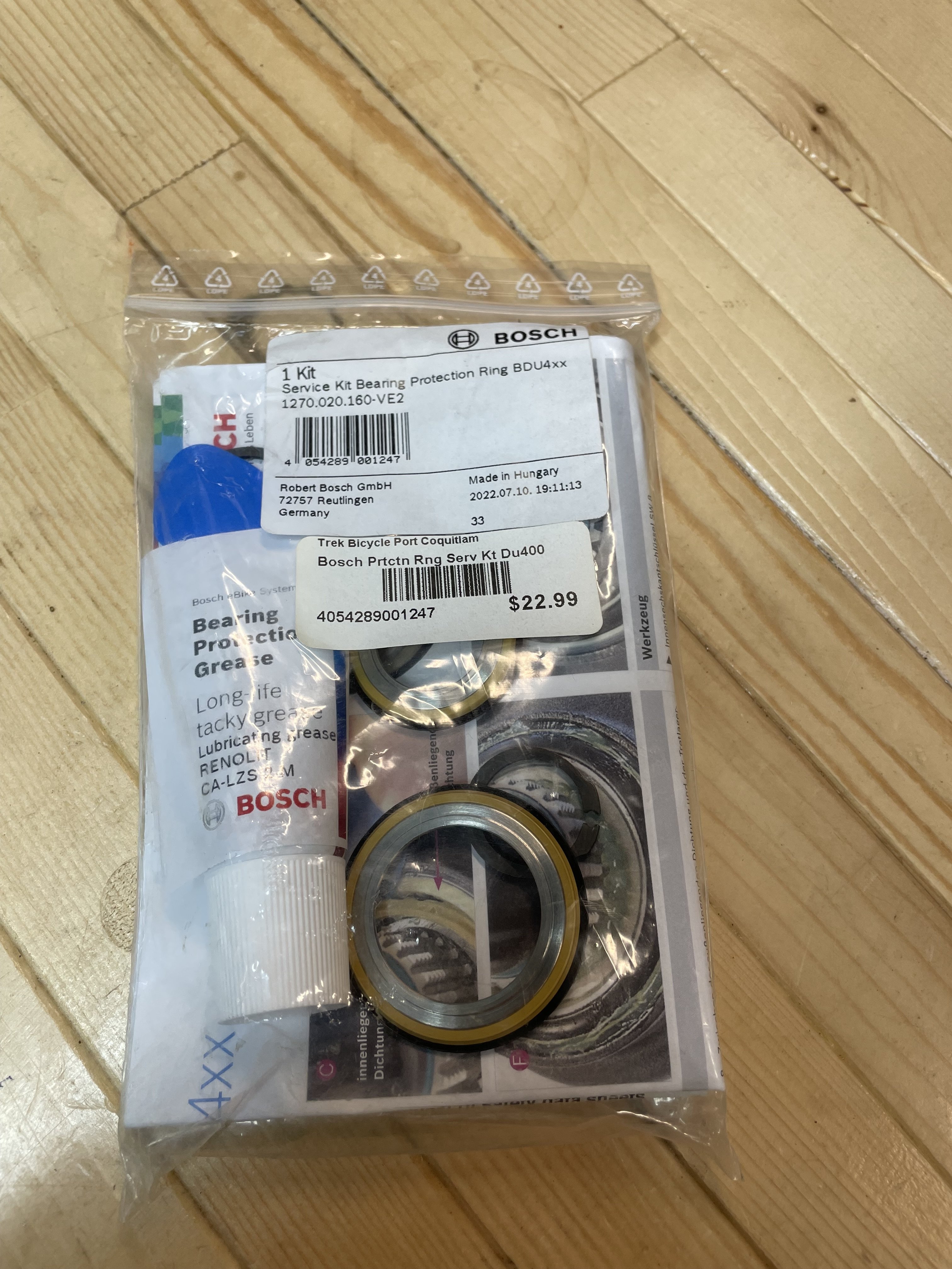

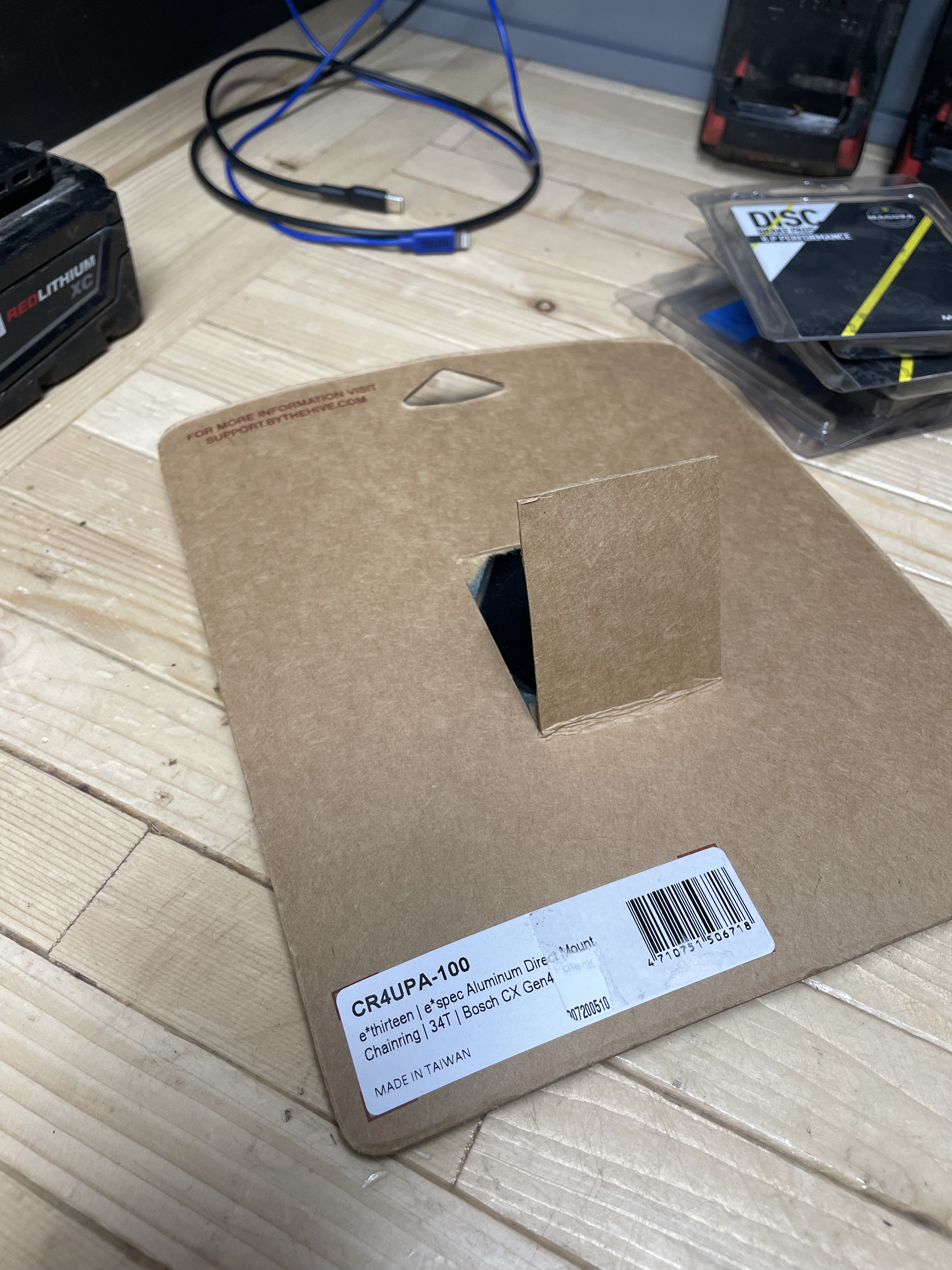

Hmmm, interesting 🧐.
Here’s a pic of the ethirteen chainring I used and the bearing seal kit.
Maybe there are slight differences between the different years? I’ve had good results with mine so far.

I used the same bearing seal kit as you Stilldog but I went with steel for the chainring, not aluminium as you did.
Funny, I just spoke with a guy about steel vs alloy chainring. His original is steel also and needs changing.
So far the alloy chaining has held up reasonably well (ethirteen) but I bet the steel one lasts longer.
I’ve ordered 2 bearing seal kits. Motors are overdue and it’s a fairly cheap maintenance procedure. Once you do it once …it’s easy. 🧐😎
