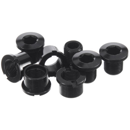

It's a Giant trance e+2. The praxis chain ring is threaded direct.
Should be able to get a bolt kit to enable fitting other sprockets.
