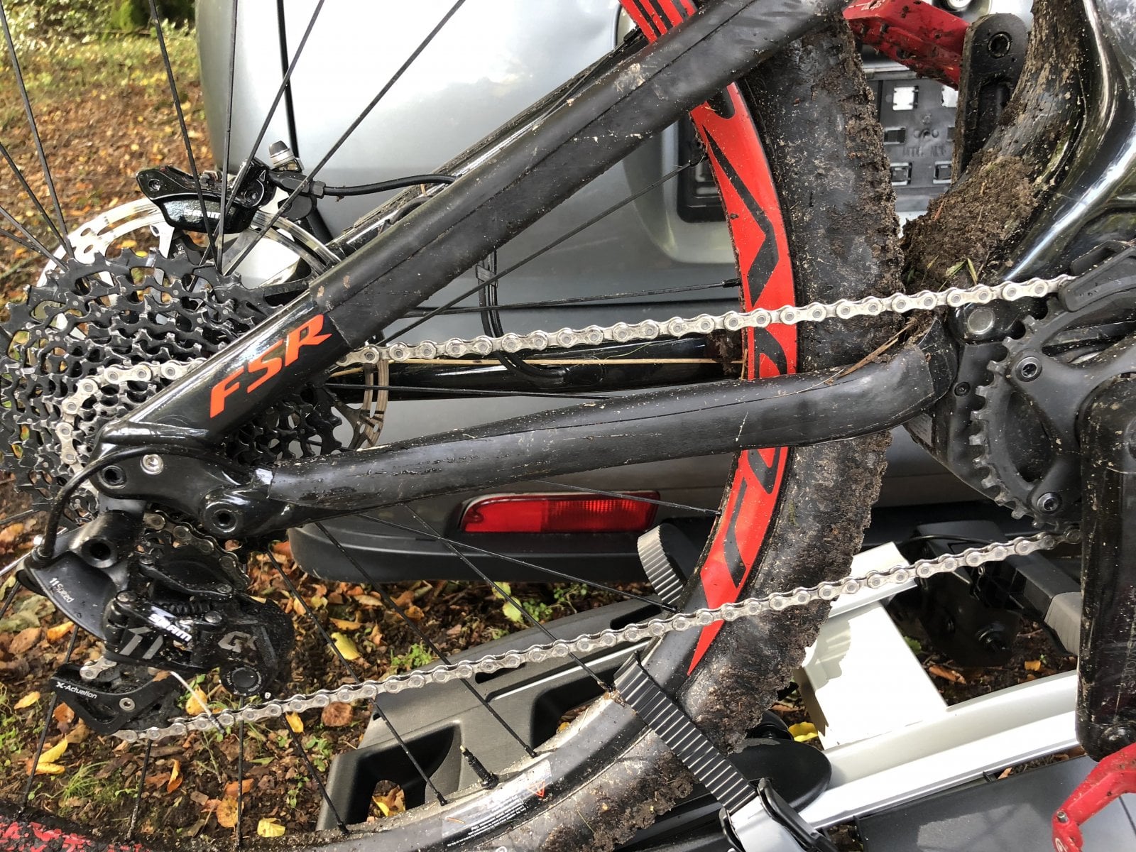

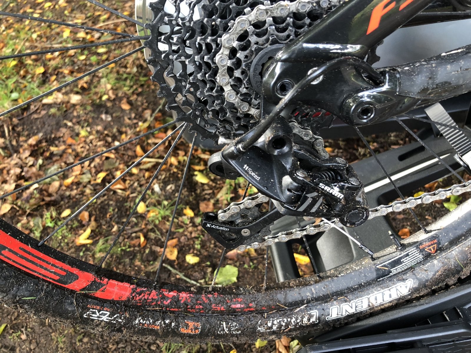

This is how my driveline looks like after a 2 hour very muddy ride in the forest today, it’s now 130 km since I lubed it and it can easily take another ride before it’s time to re-wax it. No dirt is sticking to chain/sprockets so it’s simply to rinse with water when home again :cool:

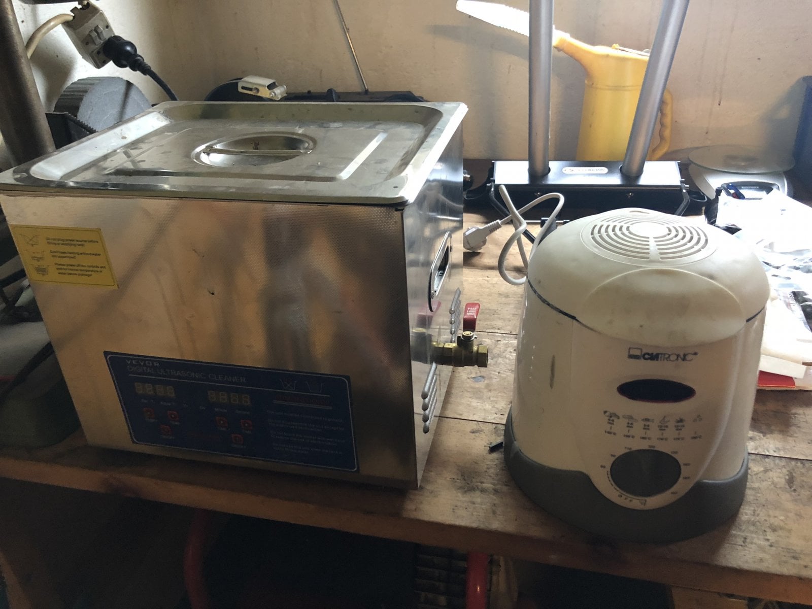

I do use wax where I initially clean my chain in a ultrasound cleaner and then afterwards melt my secret formula wax with the very clean chain inside for 30 minutes. It’s a bit extra work but I have 2 chains for my Levo and preparing one while riding with the other. Using this type of waxing the chain means that no dirt stick to it - this is how my chain looks after 100 km of wet dirty riding:
I’m on 300 km with each chain and no measurable wear so far.
My cleaning and lubing kit:
Karsten
Exactly the same technique as me. I also put the molten wax and chain in the ultrasonic cleaner (in a cake baking container) to ensure the wax gets right into the pins. Never use oil now. The chain never gets black and the wax is very resistant to mud and water wash off. Similar to you, the molten wax is mixed with paraffin oil to make it softer.
