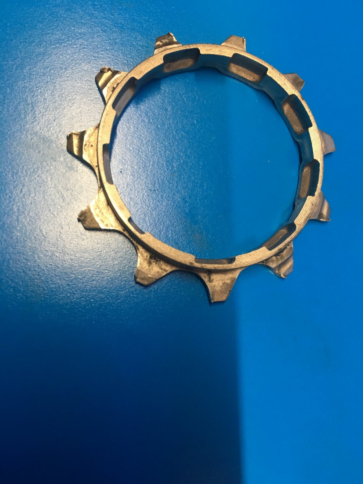

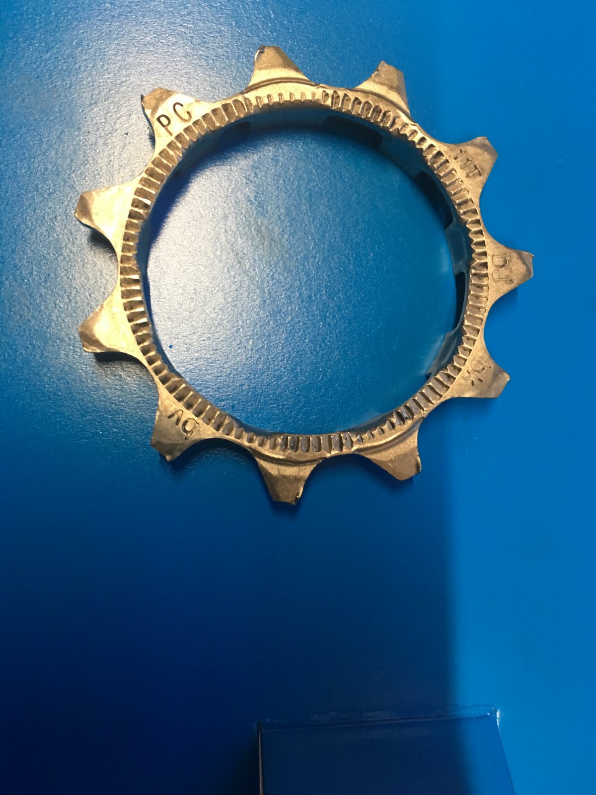

When i picked it up from the shop it still had the worn cassette and chain on as Giant refused a warranty claim. I rode it with the worn cassette and chain for two 30 mile rides in eco mode it only slipped on the second ride so i'm guessing the LBS had checked and adjusted the H,L and B screws as it was much better than when i took it in. Today i have replaced the cassette and chain with the parts i ordered from Bike discount.de, I have not riden it yet hopefully later.

Yes I have a bike stand and have adjusted the H and L screws before as well as the indexing. I've just watched a video about the B screw as I had never touched that before.
Those cogs are knackered. The burrs show that the chain has been engaging on few teeth and pushing the material aside, hence the burrs you can see. The chain running on that is also knackered.
