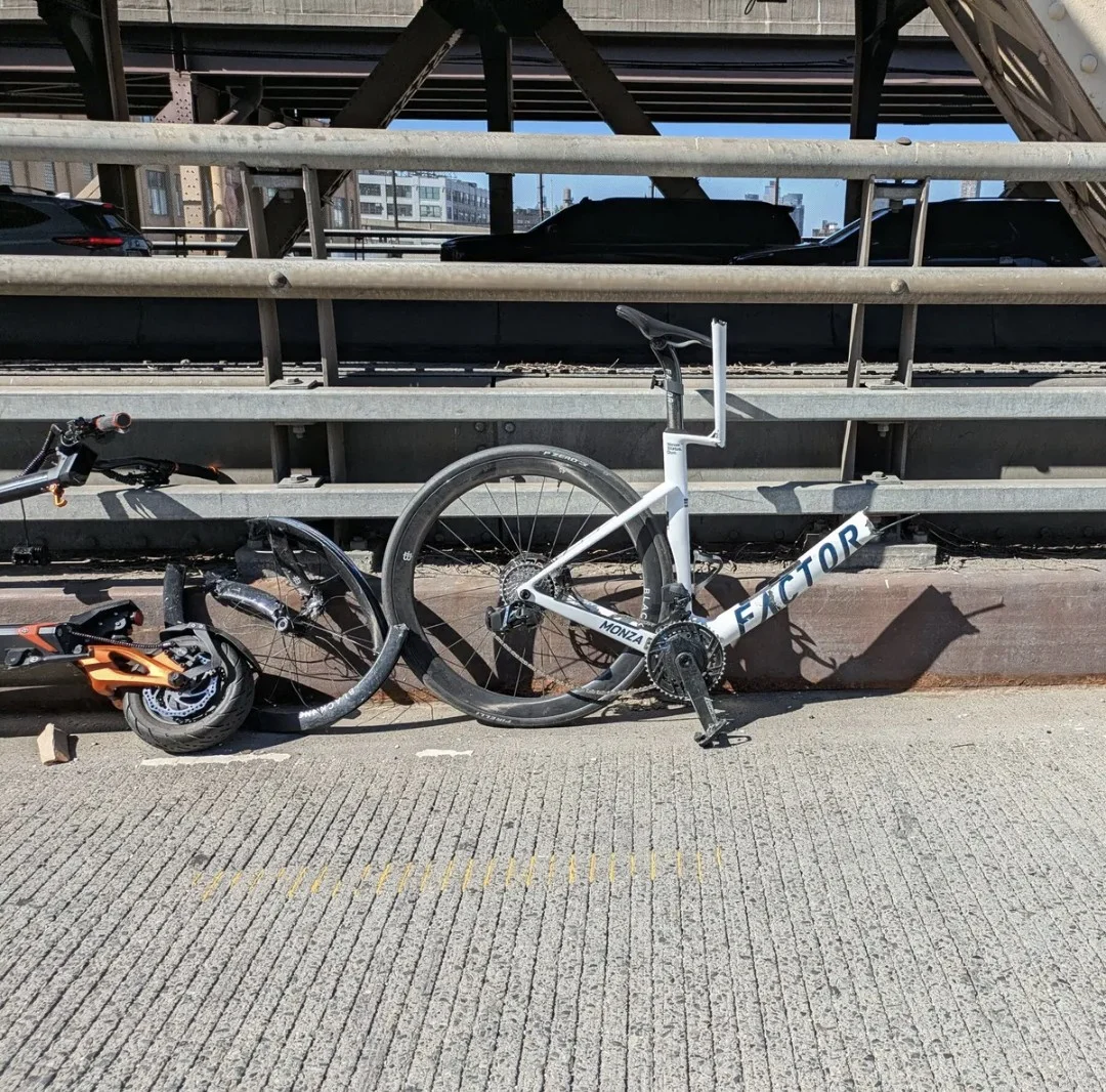

Stronger and more durable, unless the force comes from an unexpected direction !
