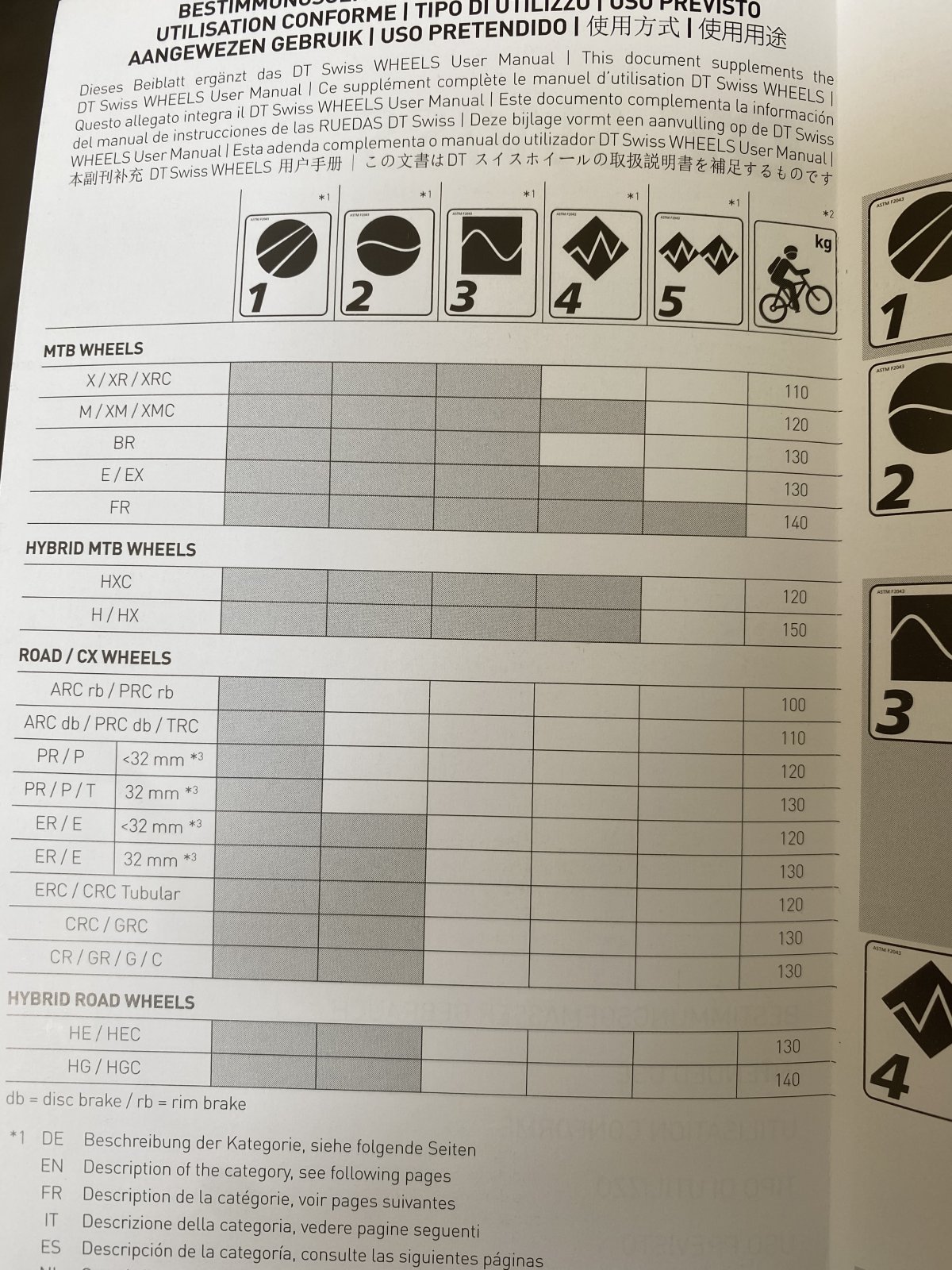

Actually this came from a review
Our test bike, the size L MERIDA eONE-SIXTY 10K, weighs 22.3 kg. The gross weight limit (i.e. bike + rider) is only 120 kg due to the carbon rims on the flagship model. The more affordable models are cleared for 140 kg.
But it has the hybrid wheels so should be ok for 150kg?

This is in the package for the wheels and clearly states 150KG for the HX series of wheels BUT 120 for carbon!
So I’d say it’s a definite 120KG for HXC and 150KG for HX. Sorry for confusion!

My understanding was that all DT Swiss Hybrid wheels were 150KG rated. It refers to 150KG a few times here:DT Swiss - Mission Hybrid
