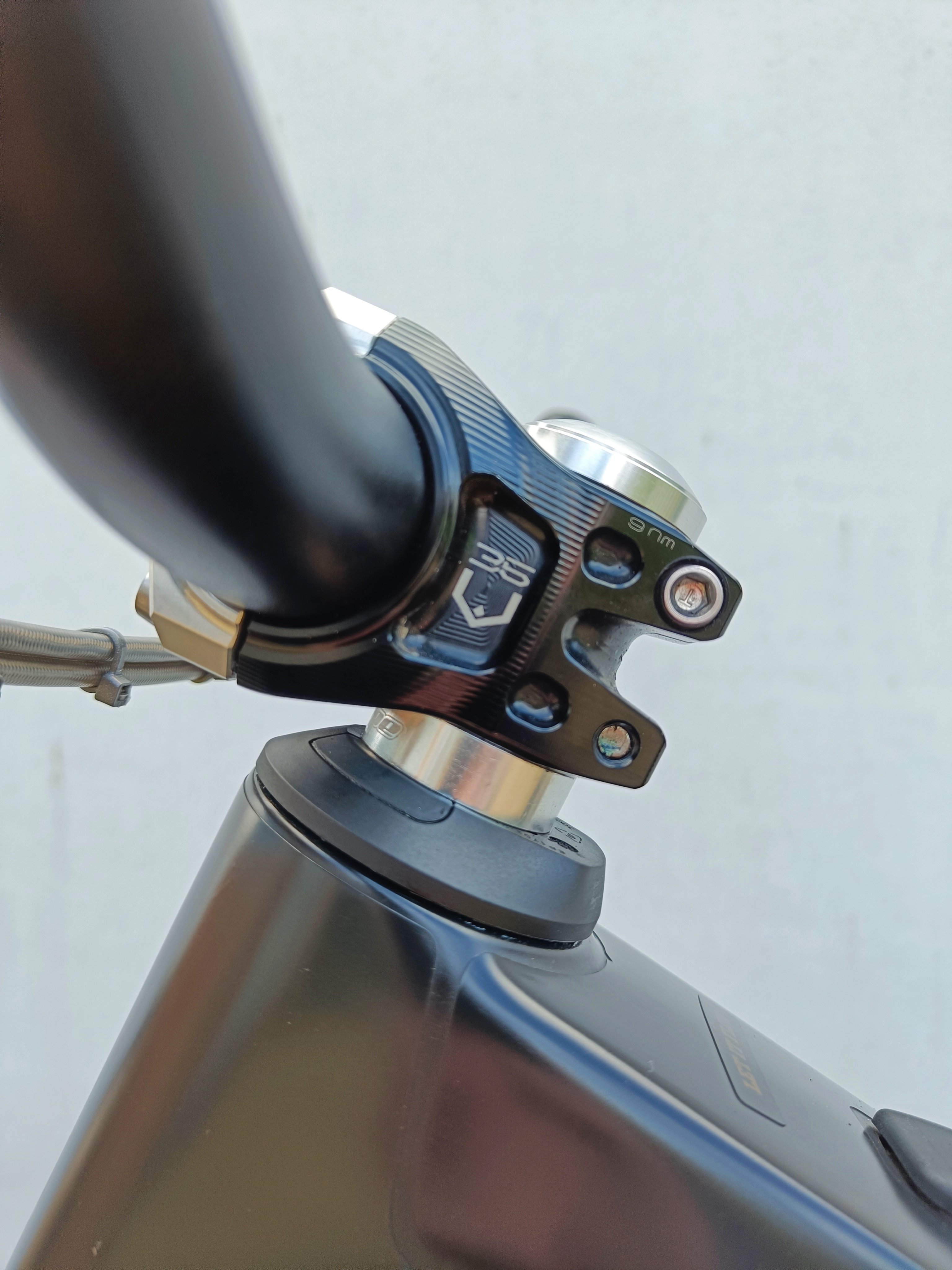

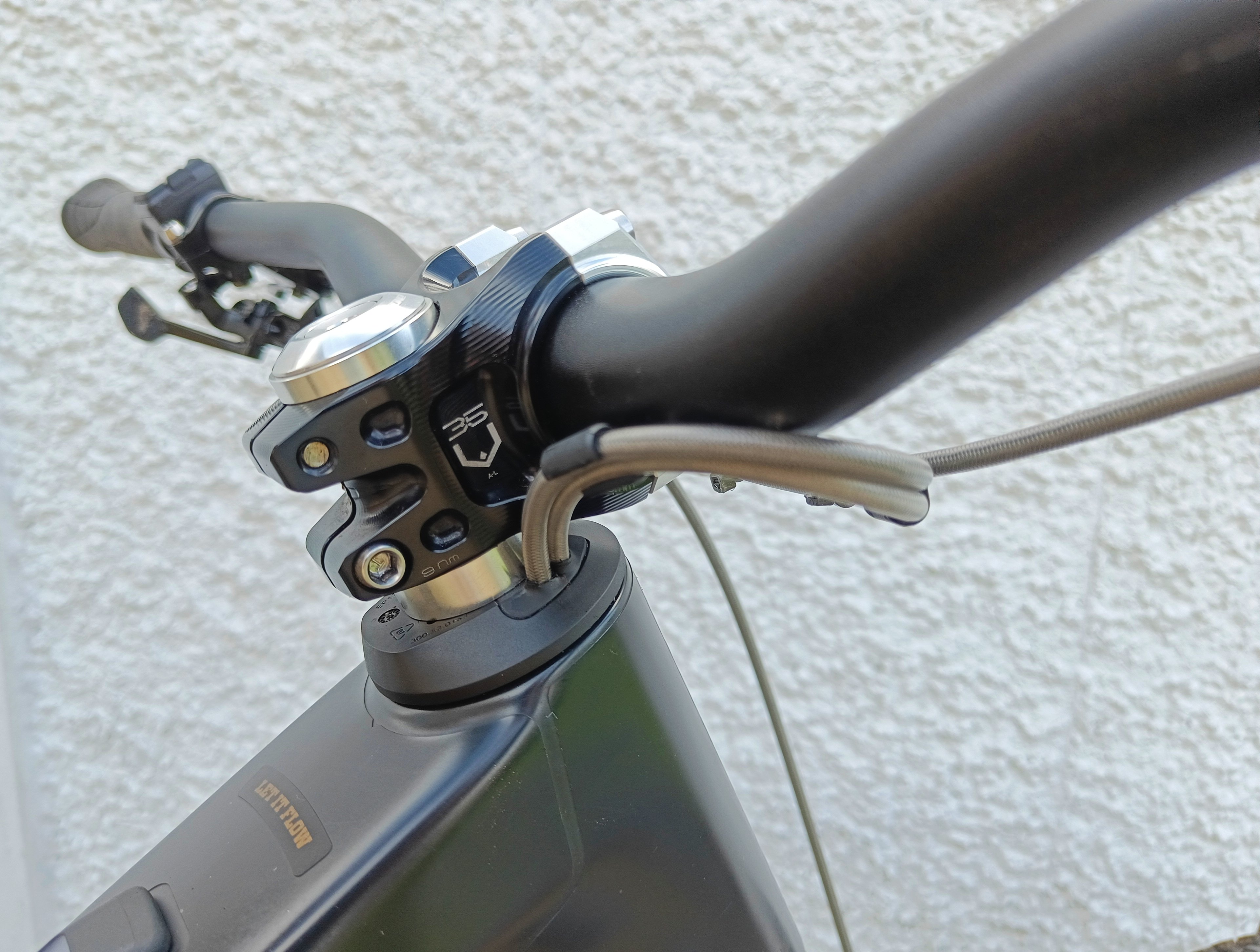

Hello guys))

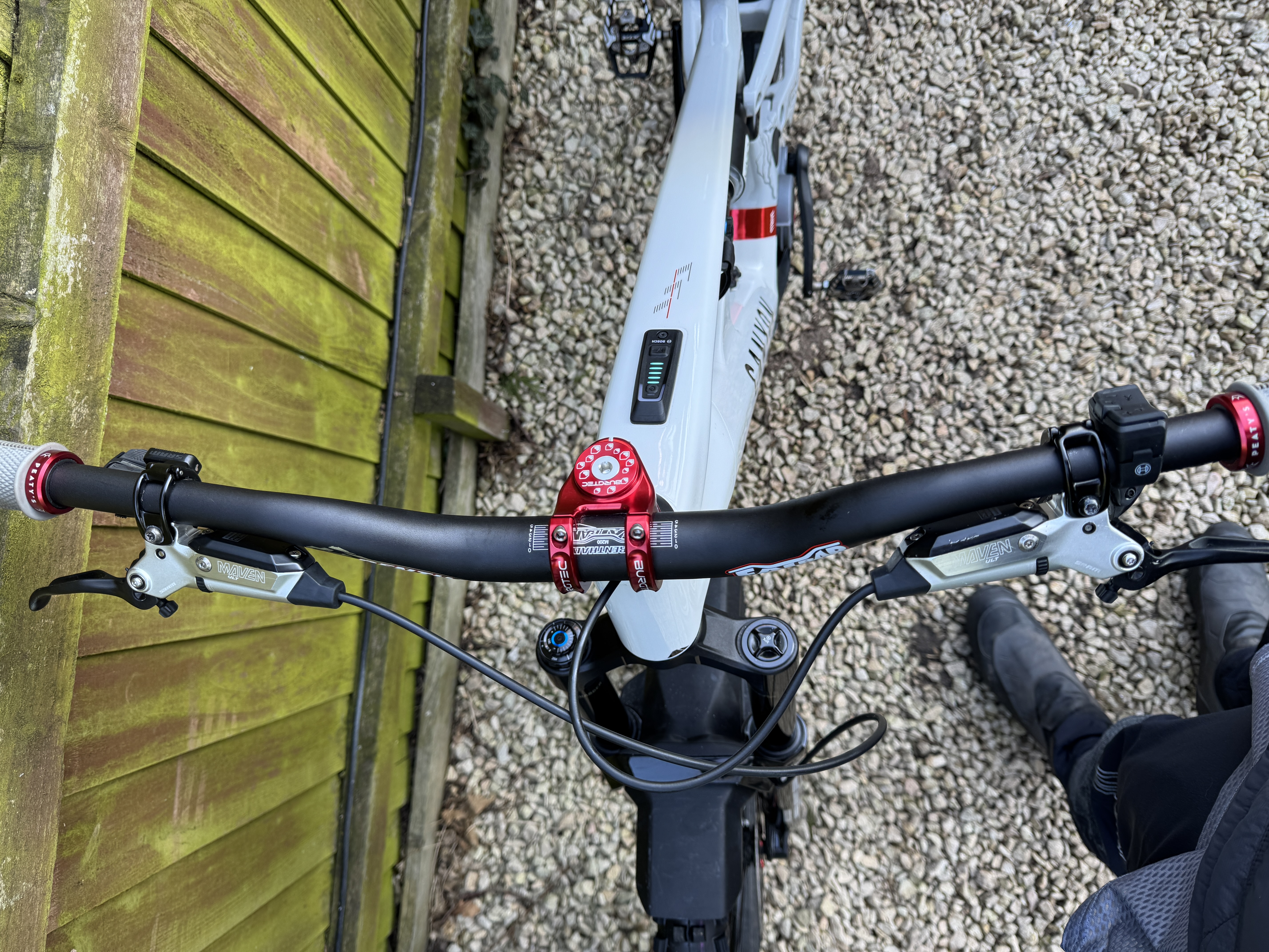

I have a Canyon Strive ON that i am thinking of changing to different stem,but can i use standard round spacers above the bottom ovale spacer that the cabels run through?(the ovale spacer)
Thanx alot

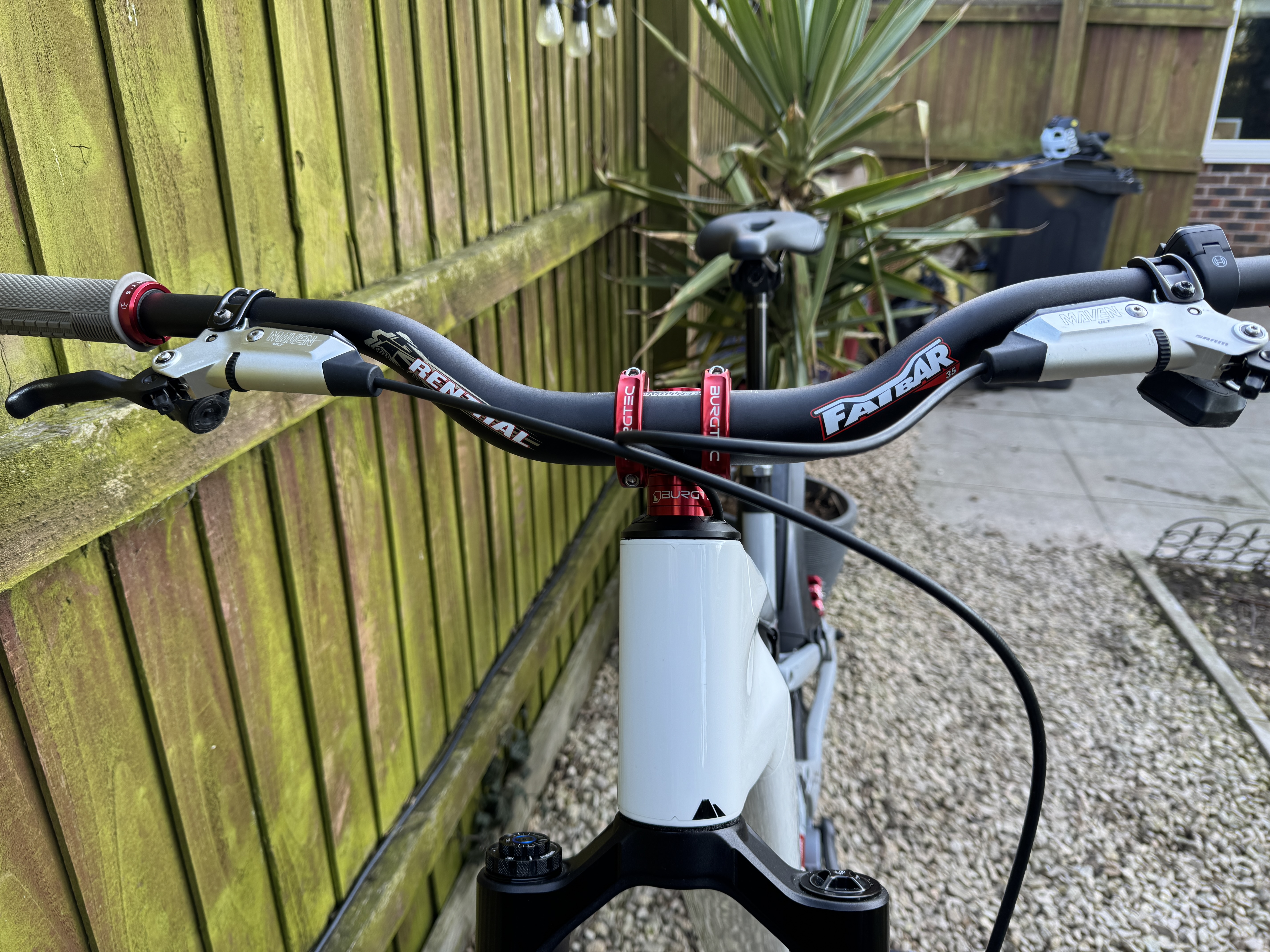

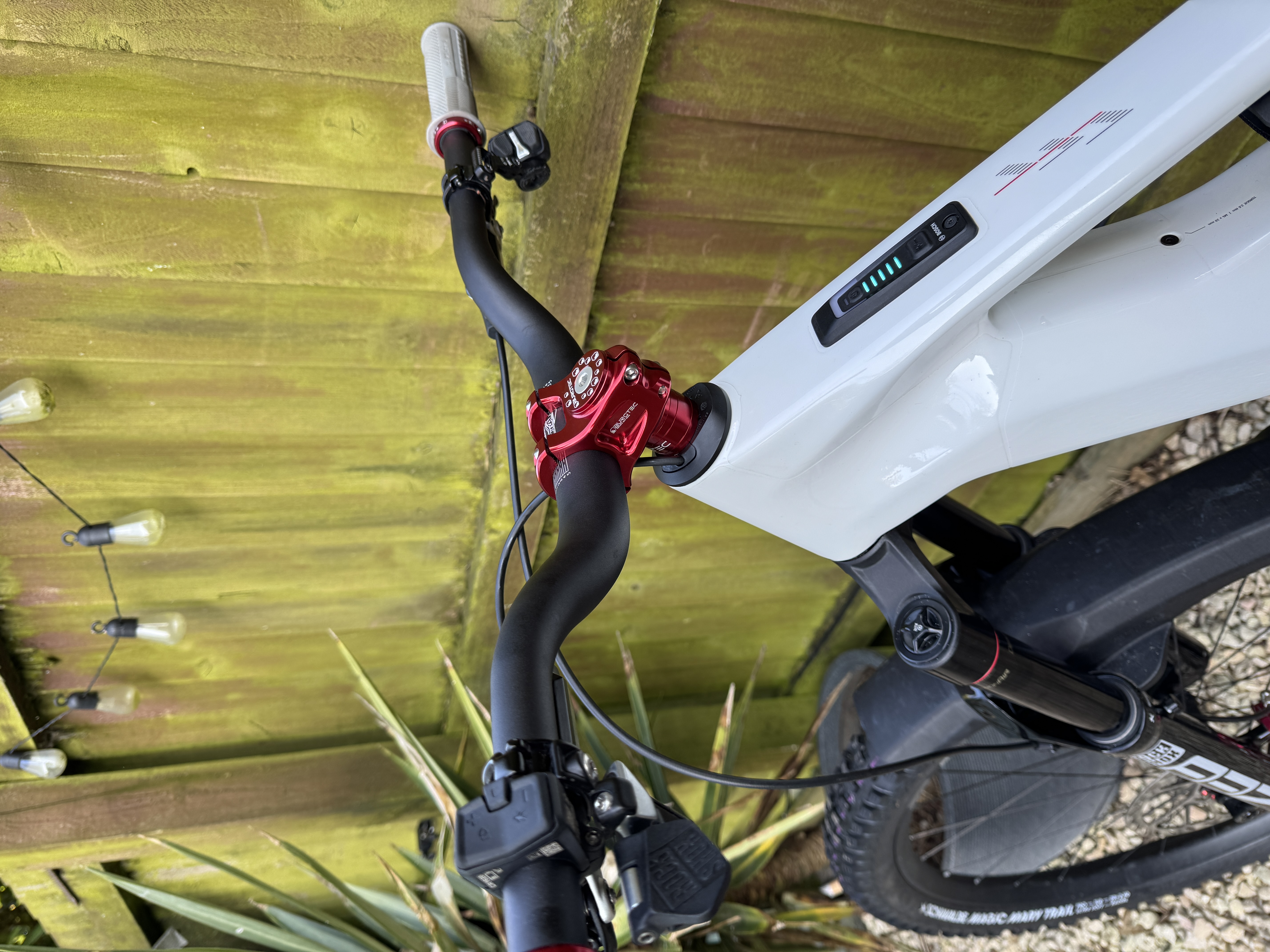

Hello Bjorn, yes you can use normal round spacers.
I removed all the Canyon spacers and put the round spacers above the top cap with the rubber plugs in so that the round spacers sit on the rubber plugs, it works fine.
