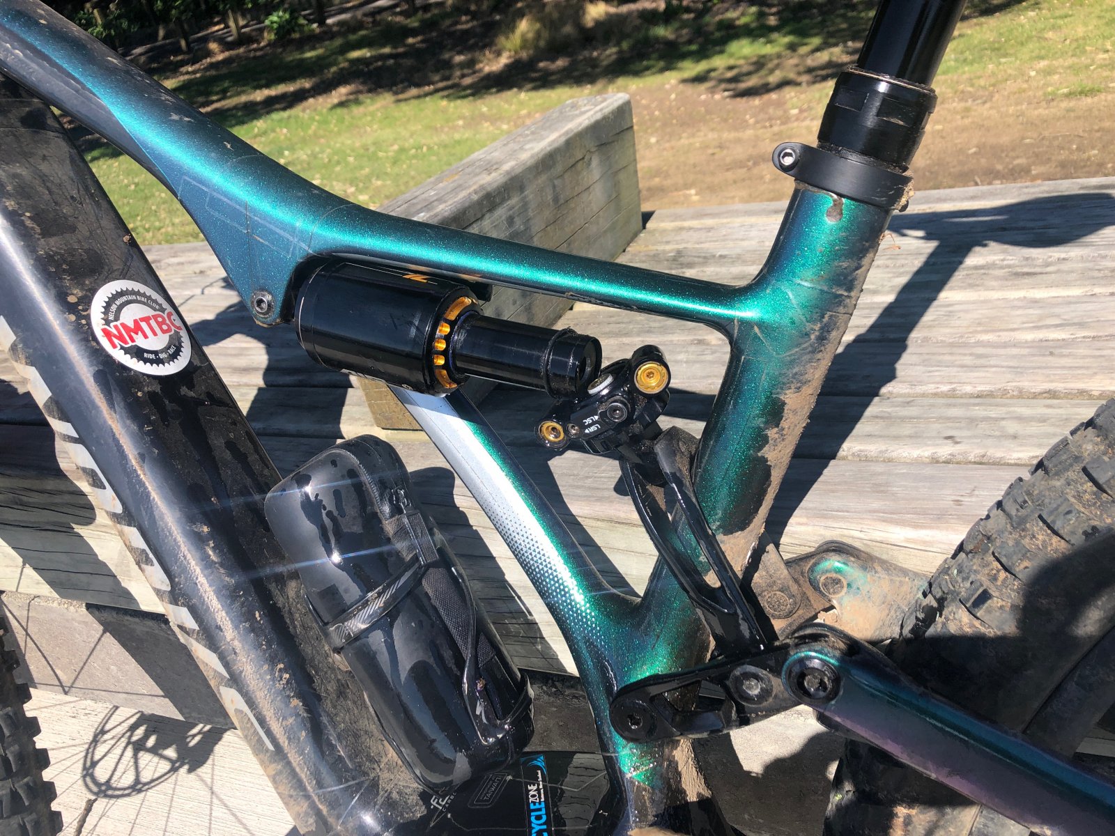

Anyone tried this shock...specifically as fitted to a Levo ( my19 Comp)?. I am looking to upgrade the existing RS Deluxe and really wanted to avoid the piggyback options so originally looked at the RS Deluxe Ultimate and that is certainly an option. The Cane Creek is a bout the same price but has a lot more adjustability. I have already upgraded the fork to a Lyric Ultimate 160mm and the shock is well overdue for a service so considering just upgrading it instead.

Cane Creek does recommend the inline you just need to buy the correct updated version! Is it any good? Why yes, I have one on my SL and it is great, you can't just chuck it on and go ride though! Buy one from JTech or TF and you'll get close to your settings but it'll take a bit of trial and error to get it perfect. All my full suss bikes run CC shocks and in my experience they out perform the big 2!!

Just checked with CC you need to get shock with part no BAD2345 as the head needs to be clocked 45degrees so as not to interfere with the frame.

hi don't understand really why tf won't recommend cane creek db coil il or air il .as they did have a problem at first but that was fixed 2 years ago .bought a db coil il with 600lb coil easy install .bikes now rides like a magic carpet i am a big boy 110kg with gear and i am not going back to air shock any time soon .
