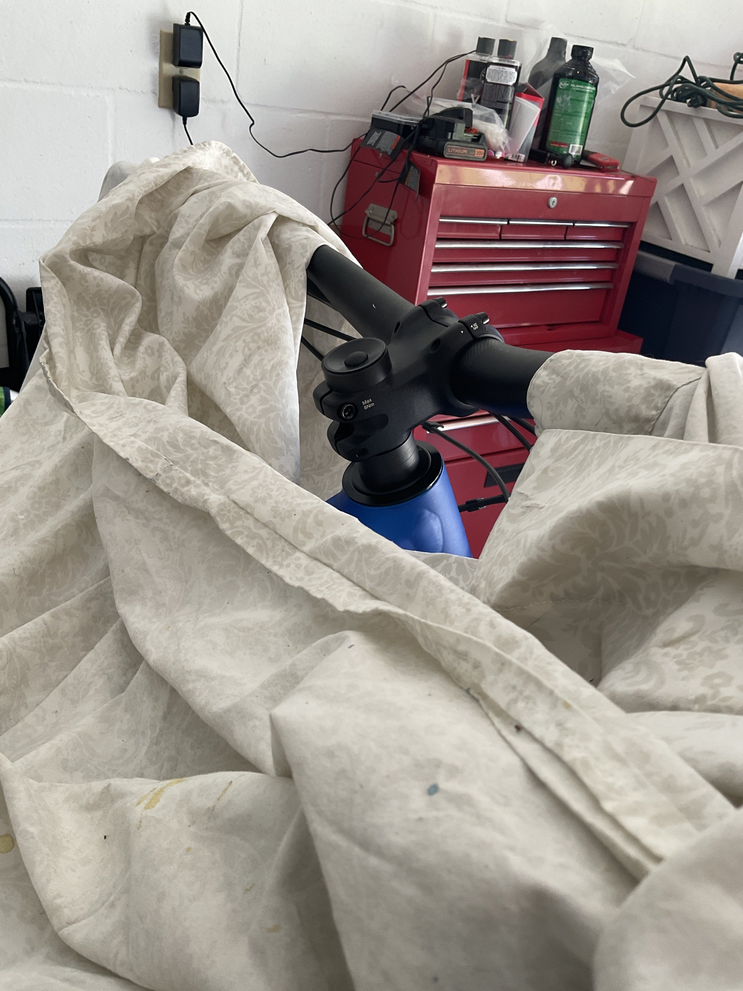

Why did you want change the rise of your bars in the first place? Spacers (shown in RED) adjust the placement/height of the stem which holds the bars on the steer tube. You may have extra spacers above the stem (you always need at least one spacer above the stem) which could be placed under the stem to get a little more height if that is what you are looking for.
If you are feeling too much pressure on your wrists maybe a bike fitting is a good idea as putting bars with TOO much rise can be difficult to ride.

Under the stem, on the part of the fork that comes up through the bike, there are circular spacers that can be used to raise or lower the level of the stem. That way you can adjust the height of the stem/bars just by adding or removing those spacers without changing anything else out.

It looks like there’s a spacer above the stem on my bike. So I guess I can still move it up
Probably not. You need at least one spacer above the stem. You might be able to buy two 5mm spacers and split the difference as long as there is still enough distance for the steer tube bolt to press down on the spacer on top of the stem.
As long as there's a gap, you don't need a spacer above the stem. If there's no gap, you do.
@force11111, I've replaced stems and bars on my ebikes a few times. While you can adjust stem height by using different spacers above and below (the stem) to your personal preference, always make sure to leave a ~3mm gap between top of steering tube and top cap.
It is also recommended to have a 5mm spacer above the stem and not to exceed ~50mm of spacers below the stem.
Take a look at the photo below. It should look like this.

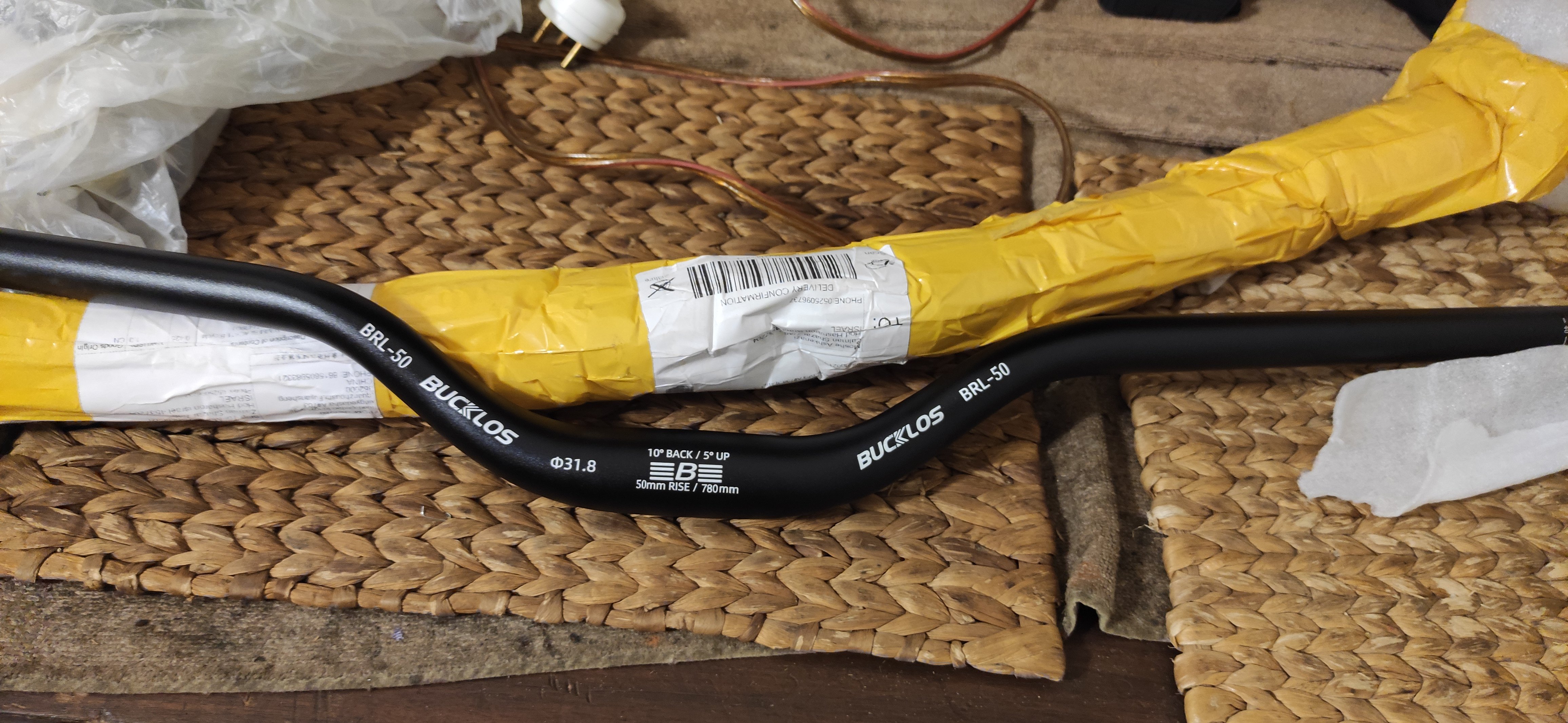

I changed to a 31.8 handlebar with rise 50 mm and stem adapter for 35 mm, excellent.
