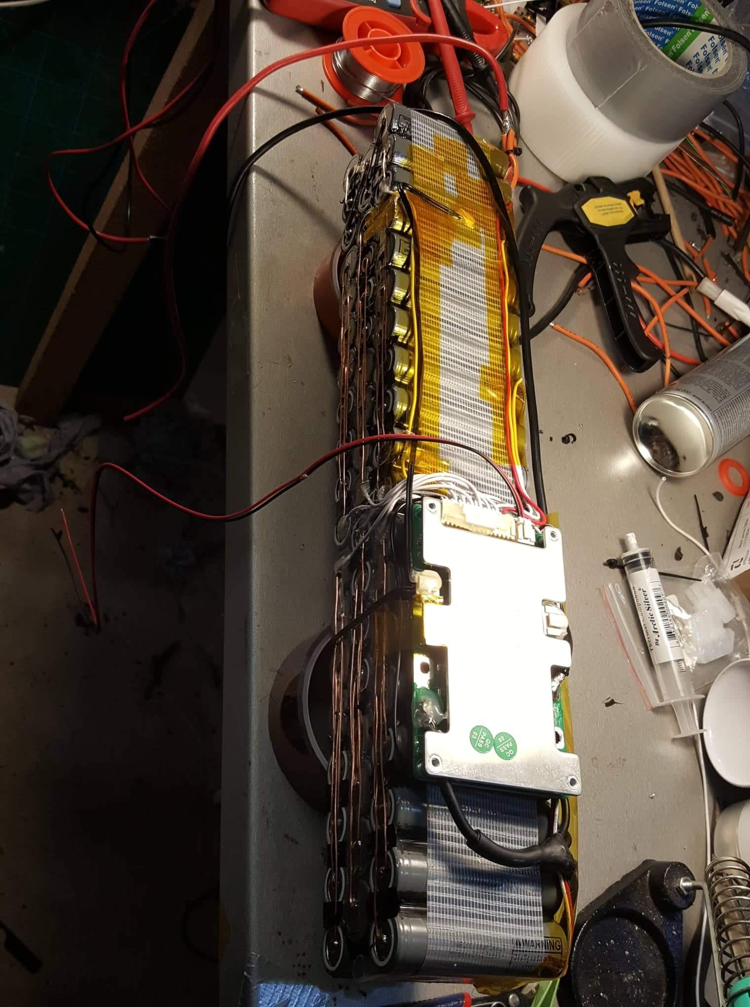

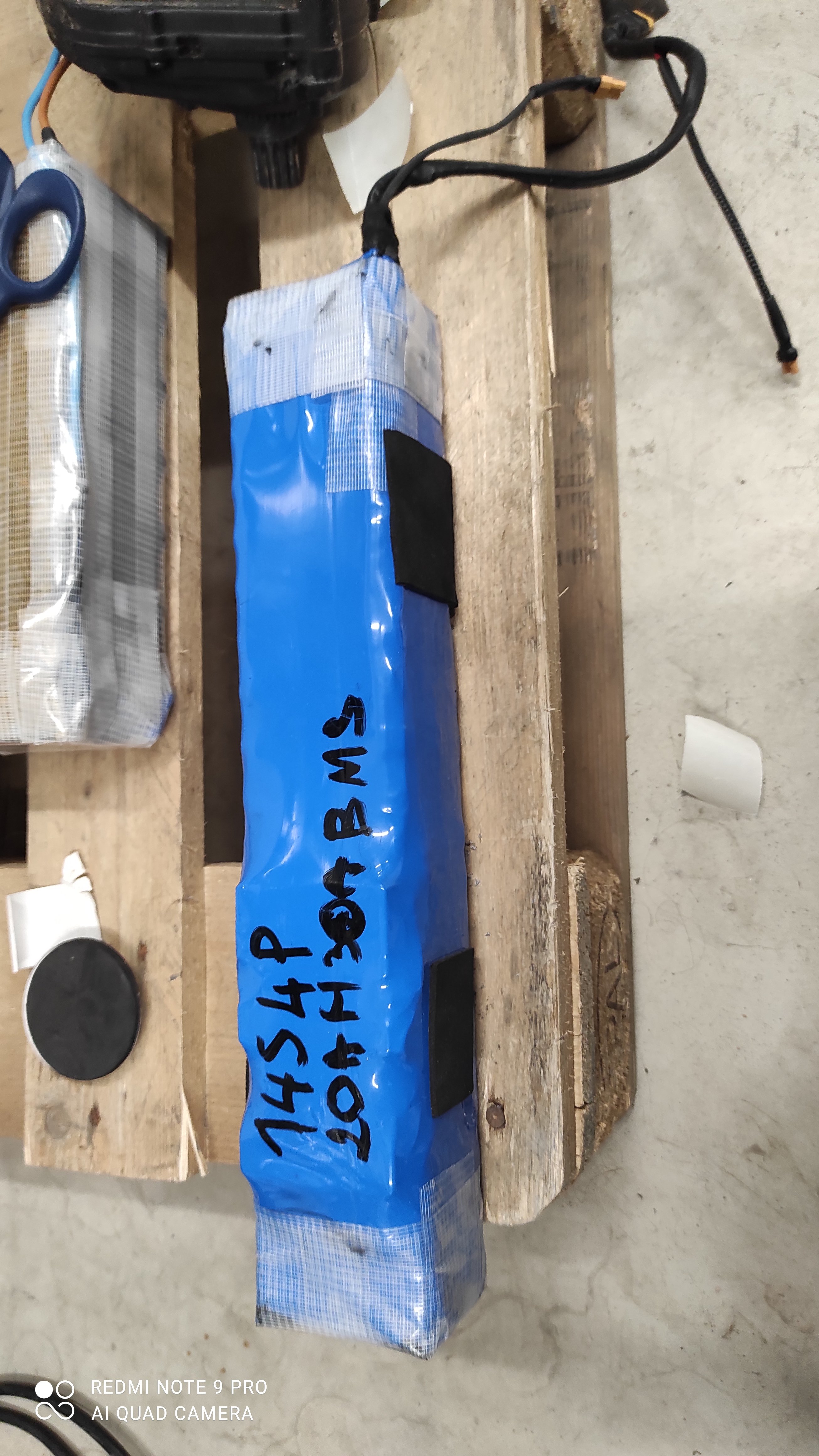

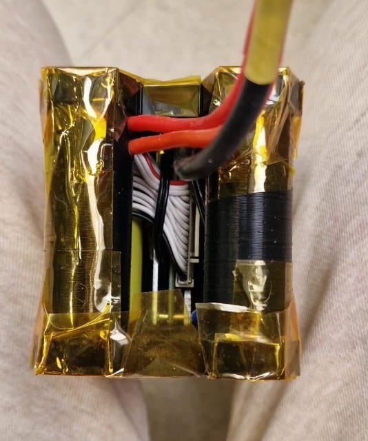

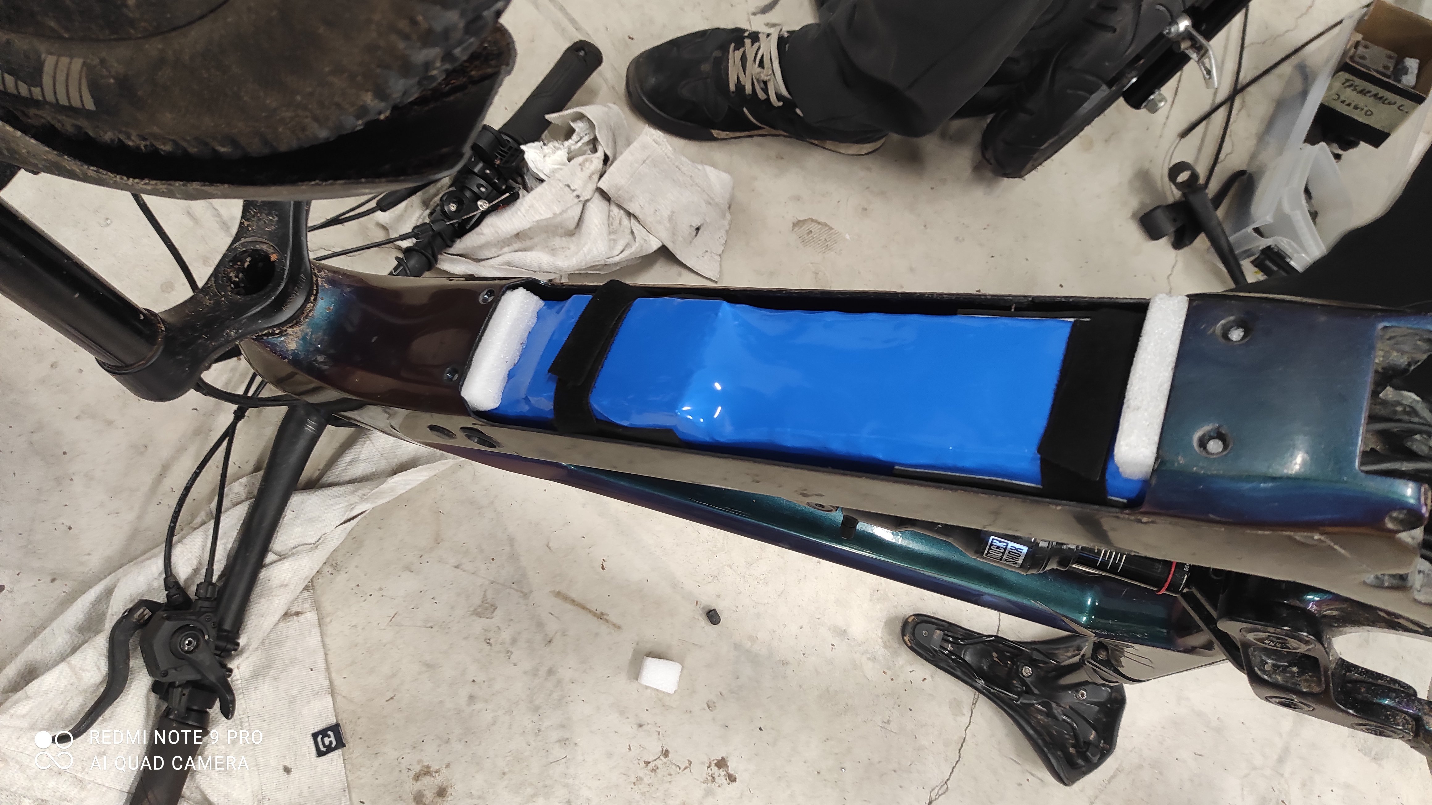

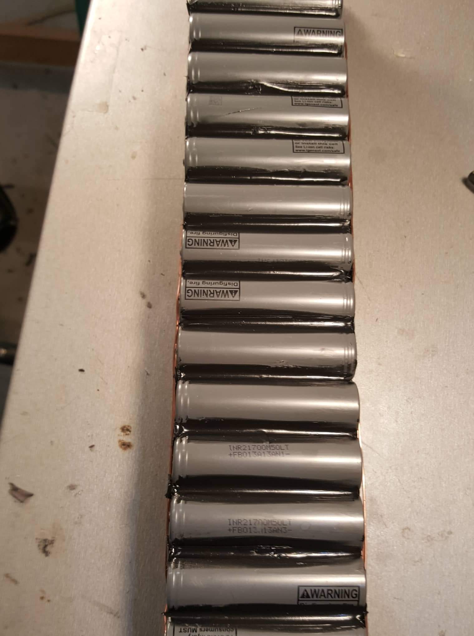

To whom it may concern: yesterday finally got my custom 14s4p 52v 20ah battery for E10. It took me a lot of time to get this battery due to having to wait for 14s BMS which turned out to be faulty and then needing to wait another month for a replacement one. But finally it came and I have the battery installed.
The battery was a very tight fit and it wasn't easy to get it in. On the bright side there is very little play left in the frame and it's secured my velcro straps and some dense foam padding.
Got a chance to test the battery today and was pleased with the performance. I believe there's some noticeable power increase, but difficult to judge due to weather conditions changed drastically. Half of the ride was on the snow covered trails with snow about 15cm deep. But the bike was doing well and I was able to ride through using 60-80% of max current. Used about 7v on my 31km ride which is not bad considering the conditions
I am attaching some photos below to show the insights and the fit
View attachment 102709 View attachment 102710 View attachment 102711 View attachment 102712 View attachment 102713

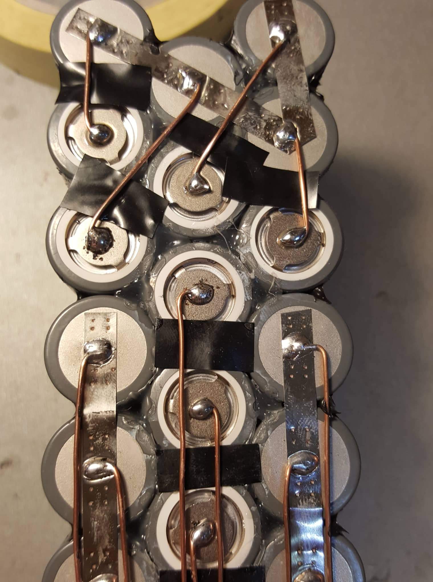

I've made many packs over the years. I wouldn't be happy with this one, corners have been cut - and the soldering iron tip wasn't big enough or hot enough.

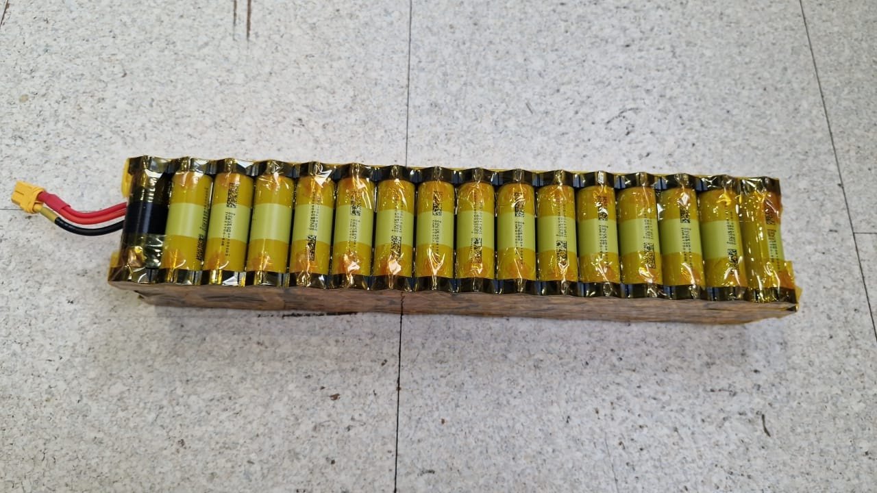

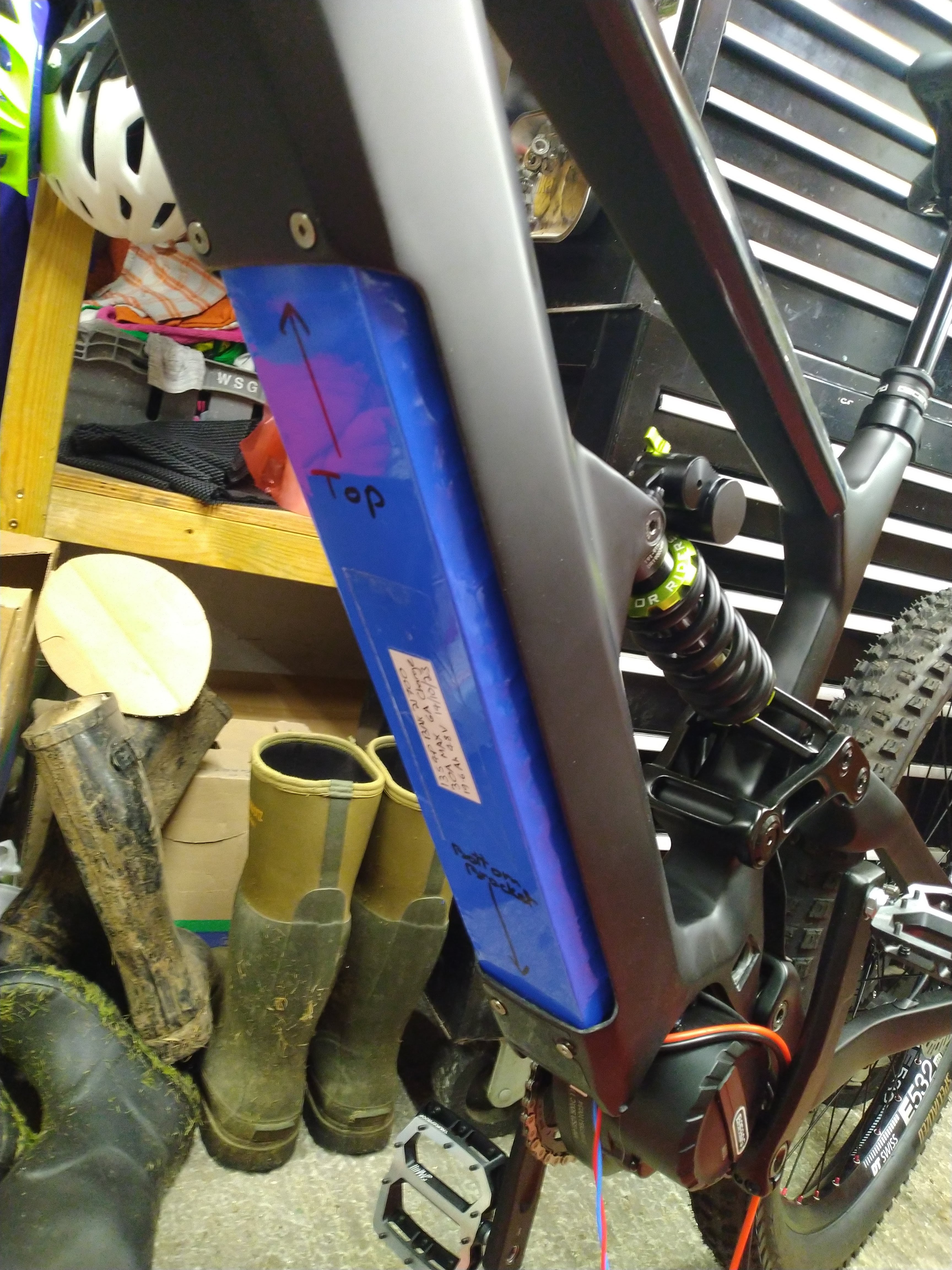

You can indeed use 21700 cells width ways. I've made a 13s4p pack that mounts to an aluminium plate that picks up on the existing mounting holes.

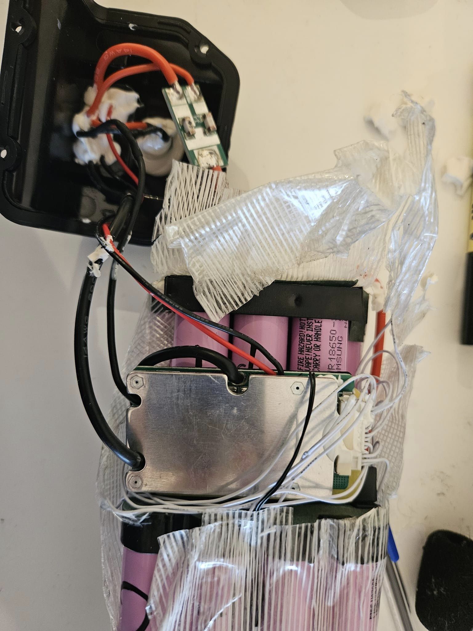

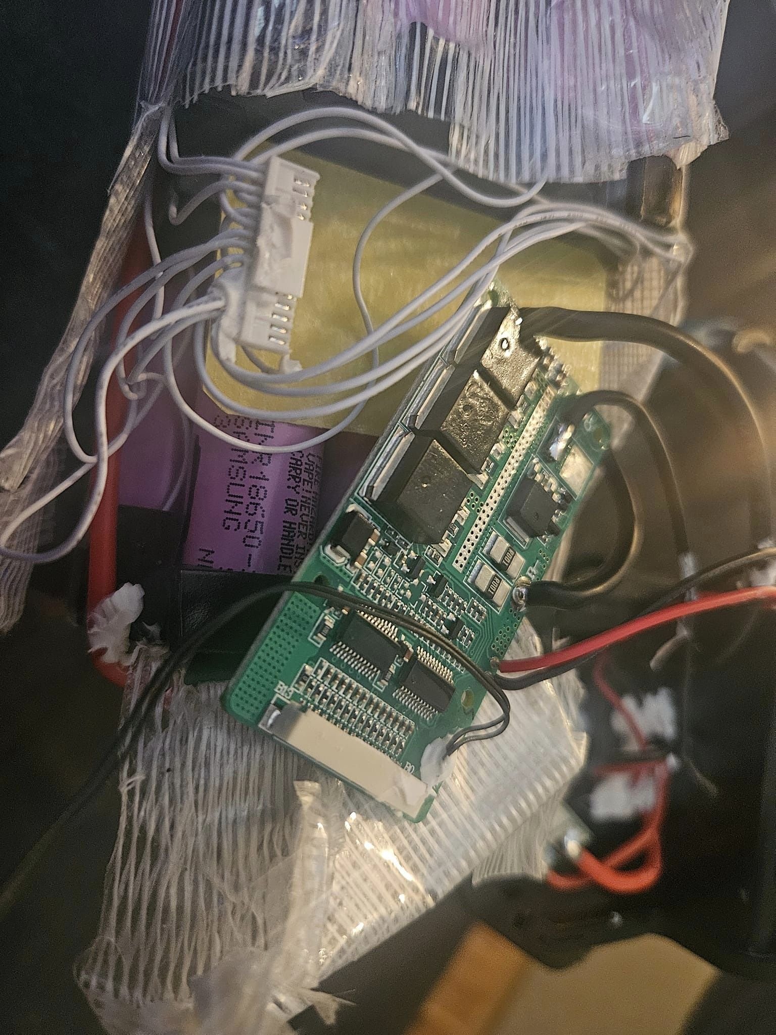

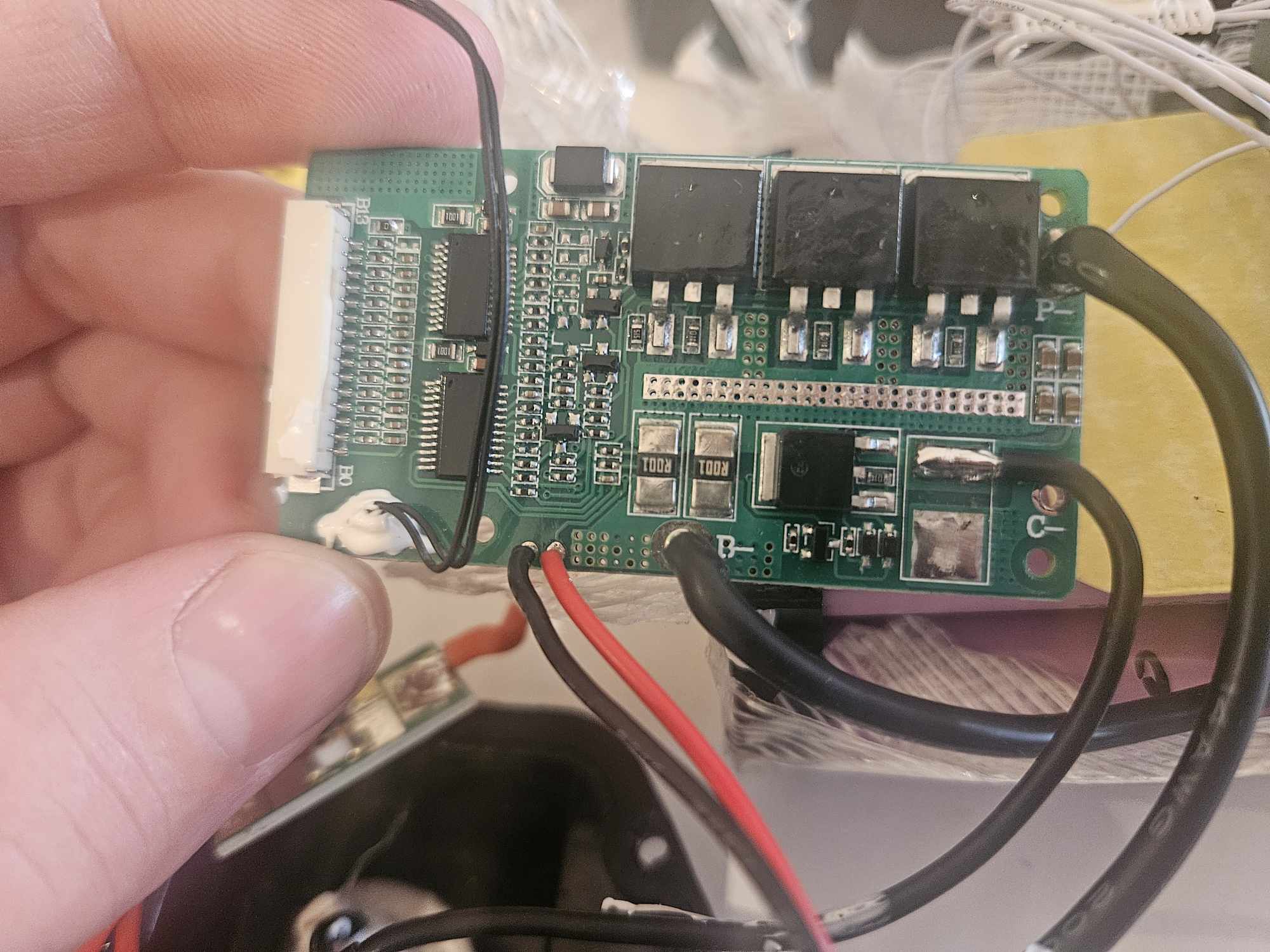

My E10s battery wont charge. It has 70% of power left, and it works in the bike. The problem is that it doesent charge. After a lot of trubleshooting I am 100% sure that the BMS is failing.
Question is where can I buy a new BMS?
The specification should be 13S 30A BMS for 48V battery and size is 35mm x 65mm x 7mm (it need to fit inside the battery-case). It also have a temp-sensor.
Connections is:
B-
P-
C-
Switch -
Switch ?
Hopefully its posible to get a new BMS with the same connector from the battery cells.
I dont need the power switch.

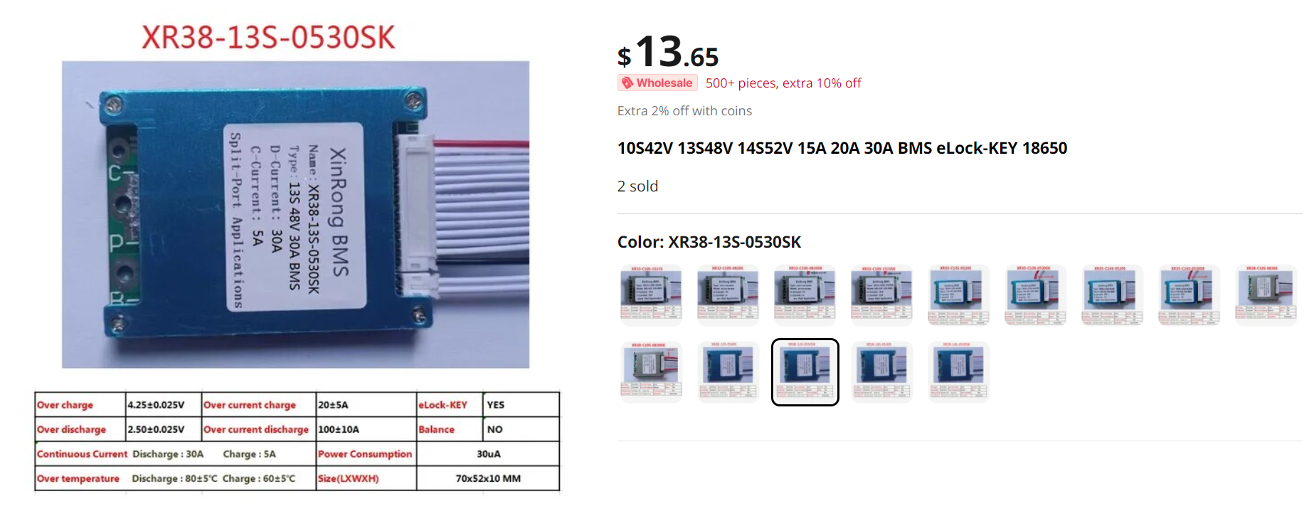

GreenBikeKit.com sells one BMS thats rated for E10 battery, but from what I can see it does not have C- connection
432270052_10161664156119697_3593575361386540754_n.jpg 435197670_10161664156049697_9133903728388757458_n.jpg 431979893_951339456375997_3576797527699395464_n.jpg
I had the same issue.
I bought the one above on aliexpress as a replacement.
I have yet to install it and test it.
I HAVE NO IDEA IF I GOT THE RIGHT ONE ;) DON'T BLAME ME IF YOU HOUSE BURNS DOWN!
Let me know if it looks right to you!
I hope it helps. Here's a link
EDIT:
I installed this and used the stock harness. It DID NOT WORK. There was some magic smoke (but just a little). I'm guessing it was coming from the resistors trying to balance the strings. I got cold feet and removed the board. the voltage readings were oddly low too. My other guess is the individual string wires were in a different order so when I plugged in the "strip" something was amiss.
I have to admit i'm new to BMS systems so I don't know how to troubleshoot.
That said the new BMS is a very tight fit FWIW. Maybe too tight. But it looks like it could have fit.
I'd look for a different board or if anyone can tell me what was wrong Or can direct us to the correct board. I'd love to know too.

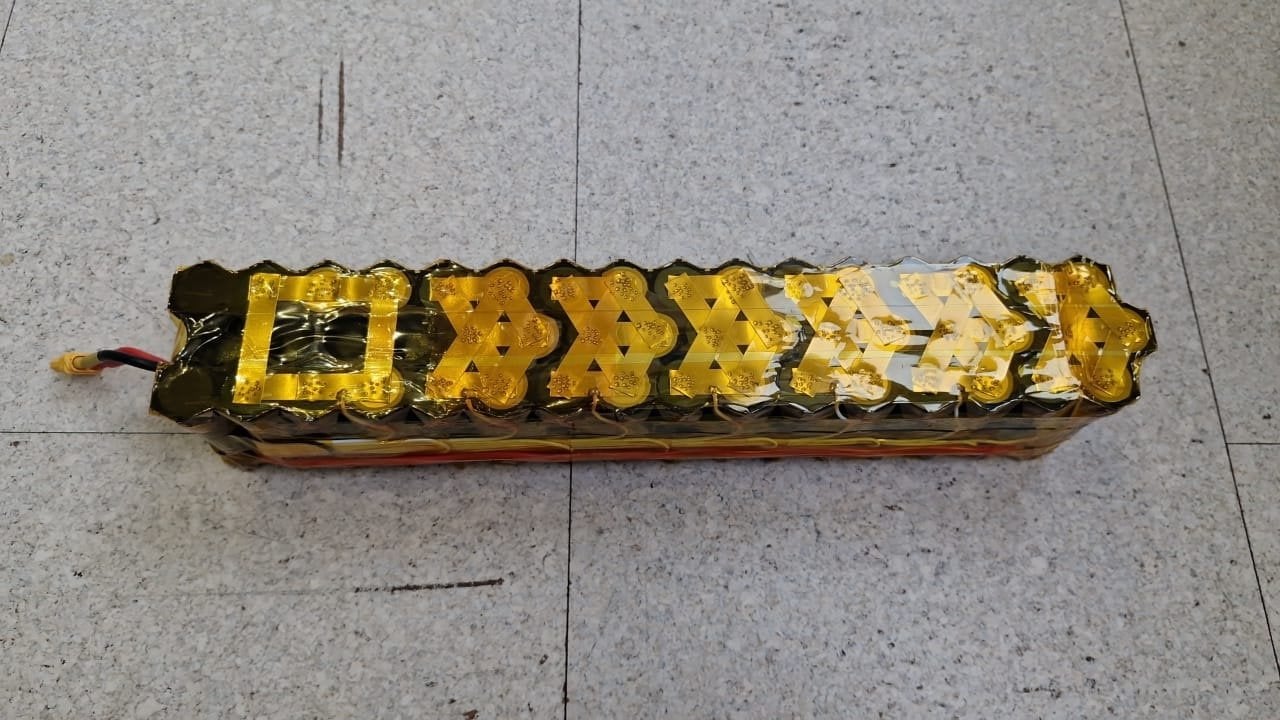

It's been a while, in the meantime does anyone have any photos to share on how the battery is assembled?
Cell layout and soldering.

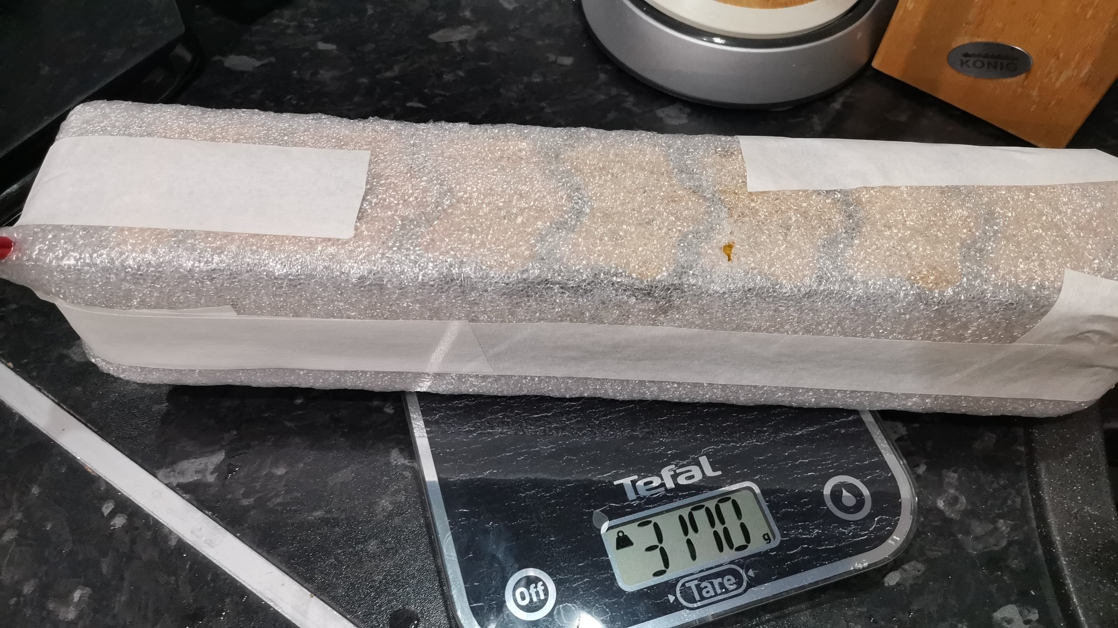

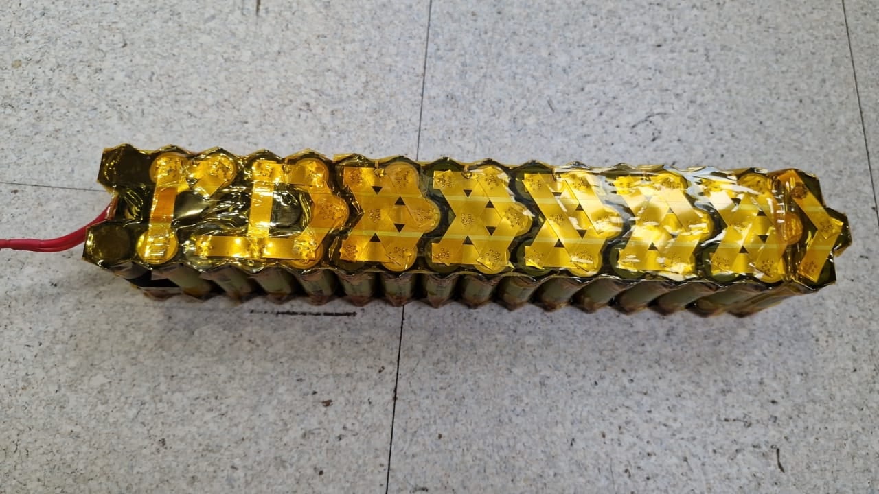

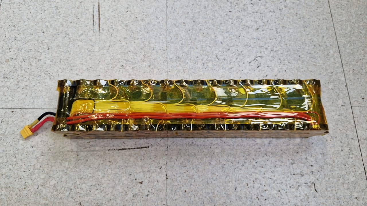

This is an example of an E82 frame battery. Suitable for E10. Battery 21700 14.4A 52V 750W. The weight is 3170 without the case. Size 375x65x75mm
WhatsApp Image 2025-03-02 at 19.14.44.jpeg WhatsApp Image 2025-03-04 at 15.35.17.jpeg WhatsApp Image 2025-03-04 at 15.35.24.jpeg WhatsApp Image 2025-03-04 at 15.35.31.jpeg WhatsApp Image 2025-03-04 at 15.35.43.jpeg WhatsApp Image 2025-03-04 at 15.36.04.jpeg
You cannot put this one in the original case.

The case is designed for 18650. My battery is built at 21700. This is an example of a battery that is included in the frame. If you don't have any experience collecting batteries, then you definitely shouldn't do it. The 18650 for this case requires a lot of soldering and wiring connections.

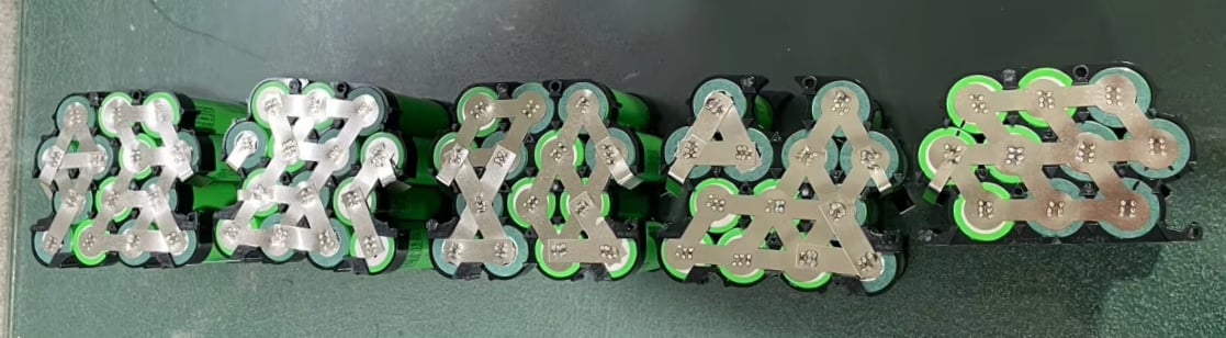

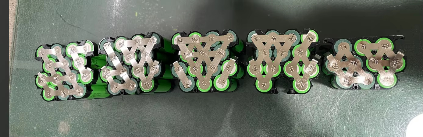

The battery case supplier sent me these photos to show me how to assemble the cells.
Does anyone have any other information?
