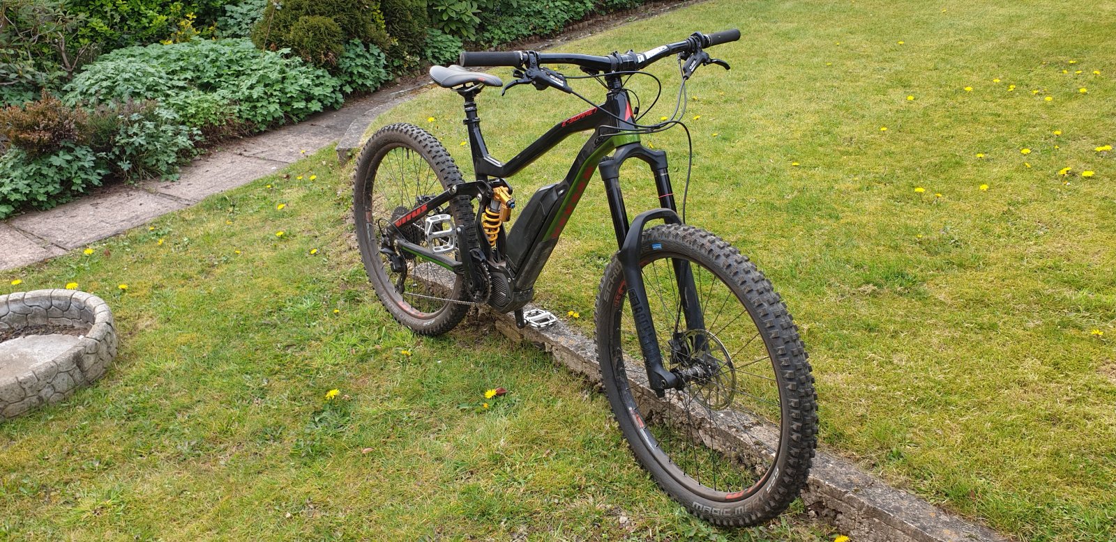

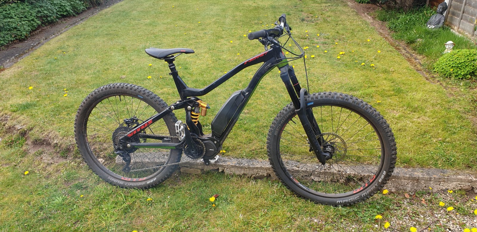

So I fitted the coil shock on Friday, also put 2.6 magic Mary up front and a hans dampf 2.6 at the rear. Always thought the standard tyres on the vitus were a bit disproportional. I can say that the larger tyres combined with a 35mm stem have significantly improved the look of the bike, and the shock really sets it off.
Anyway, down to the important stuff and how it rides with the ohlins coil compared to the standard shock. The difference is night and day but for £800+ it should be. There were 3 things that stood out for me. 1) stones and roots no longer affect the bike, its buttery smooth. 2) I usually do drop offs up to about 2.5 feet and the comfort on the landing is a world apart. I went straight up to stile cop and did bigger drops than ever before as it was confidence inspiring. 3) the bike pedalled better, a lot better. I got out the saddle more and due to that it felt more like an acoustic mtb. I ended up getting a 525lb coil but after just one 3 hour ride I was pushing it so may need to up from the 525. All in all (for me) I can see no cons and I absolutely love the upgrade even if its on the expensive side..... But not as expensive as buying a specialized.

Pictures please! Did you have to remove the shock guard?

Looks way nicer than Brayton's too without all those ugly red Hope parts stuck on everywhere ;)

I've actually stealthed out all the green and all my frame decals except the top tube ones now.

Stripping/painting the frame voids warranty on the entire bike (motor incvluded). I checked when I bought my 2018 and again 2 weeks ago. and a Warrantyless Ebike is not something I'd consider owning.
Mine is wrapped/taped with a mix of car vinyl black insulating tape and mastic 2228 tape.
not the most pro job but still looks better than that awful green and red.
WTF were they thinking there?
...But ran out of budget for the gold and hash leaf headbadge ;)

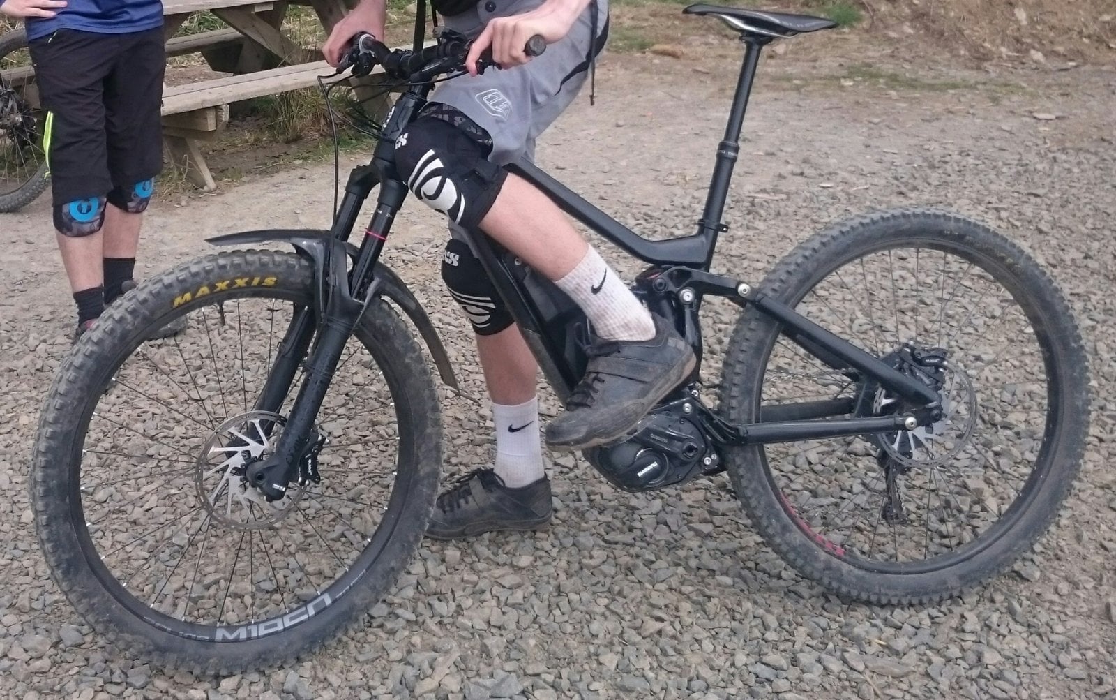

Not me BTW. My mate (in the background) 's 15yr old son. - Local ripper.. #FuturePinner
