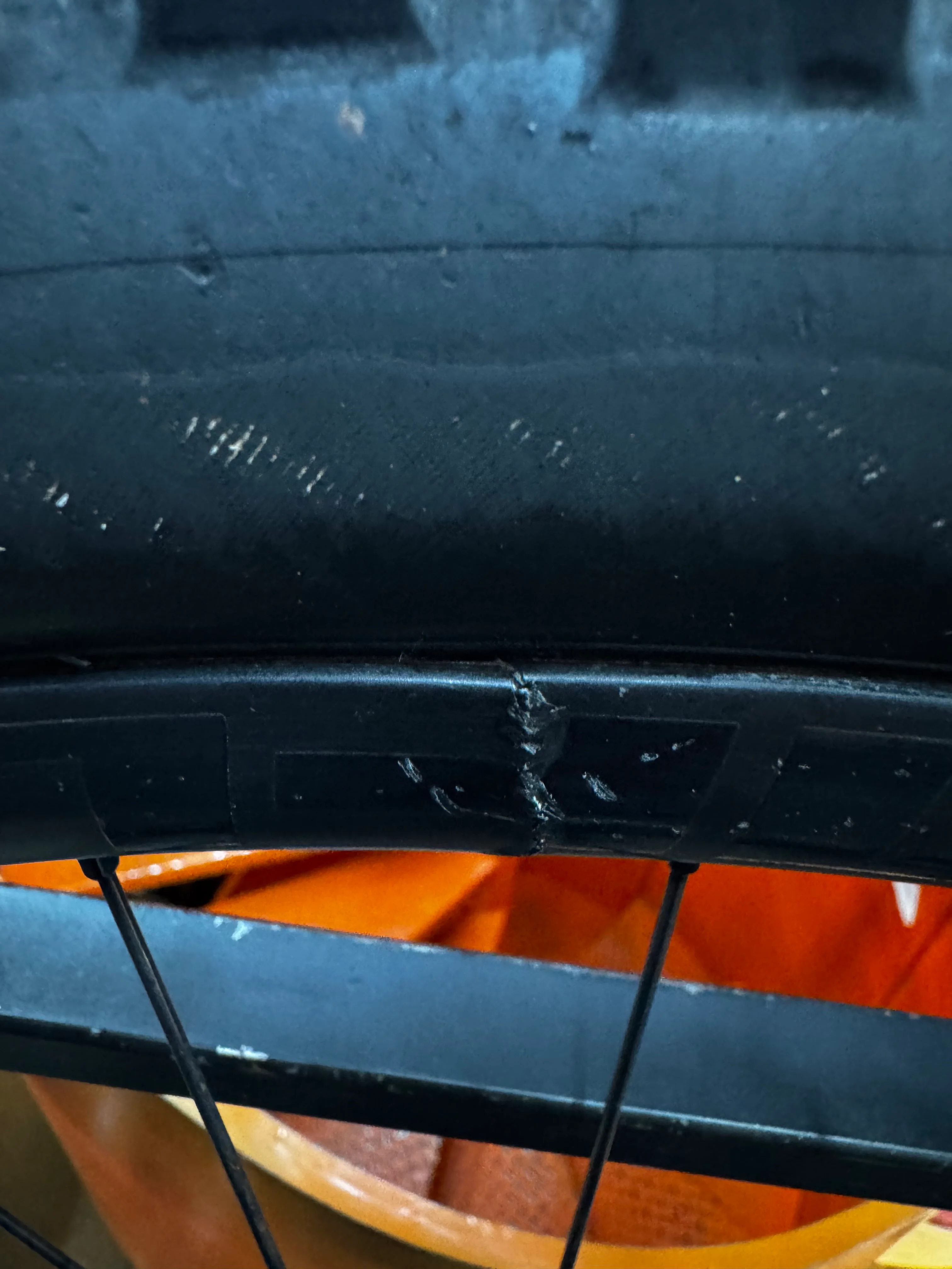

Last week, I hit the wheel sideways against the tip of a rock and broke the carbon rim. Fortunately, the wheel didn’t lose air, and I decided to keep using it until the new wheel arrived. I’ve probably ridden about 200 km in this condition.

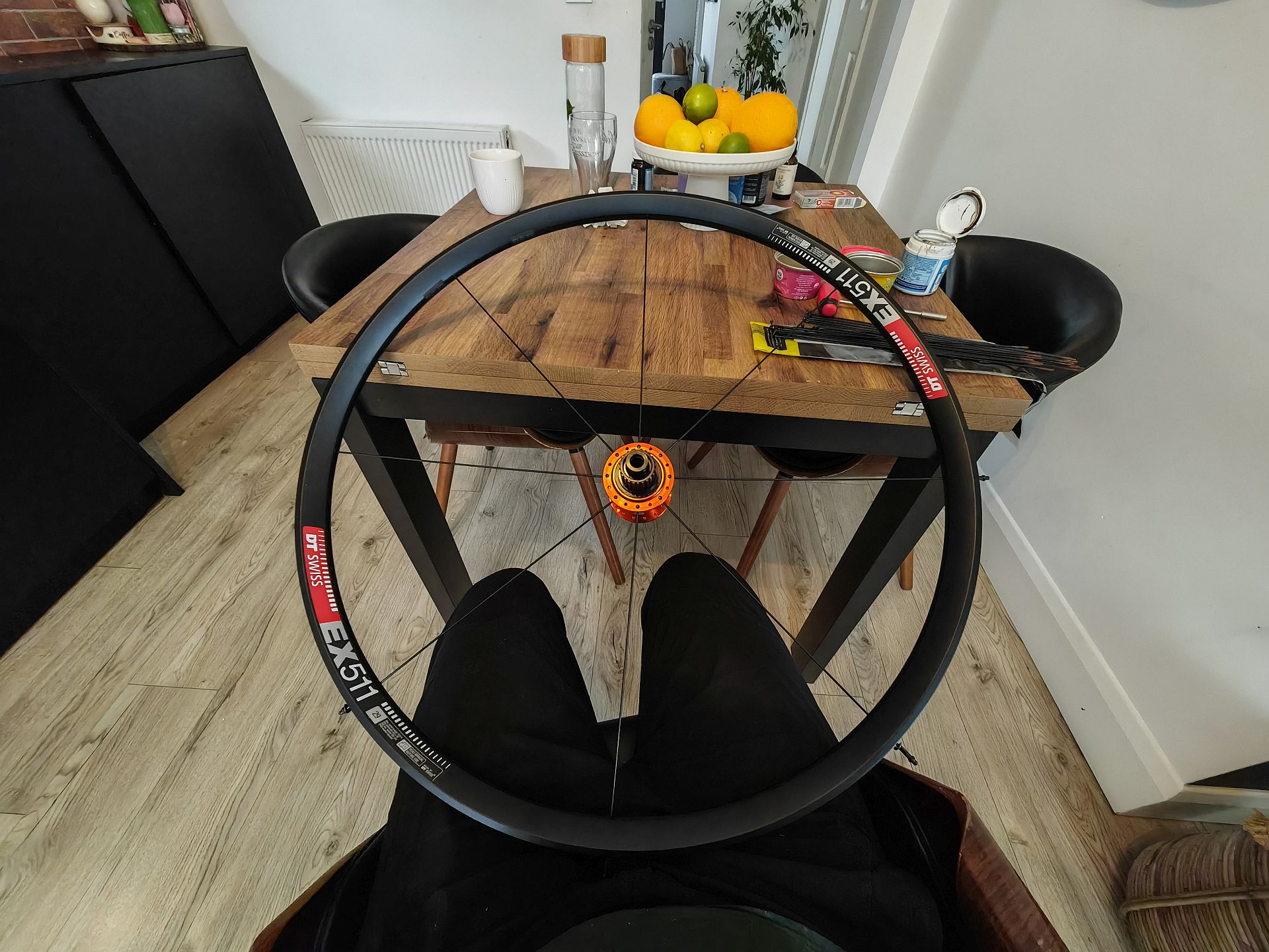

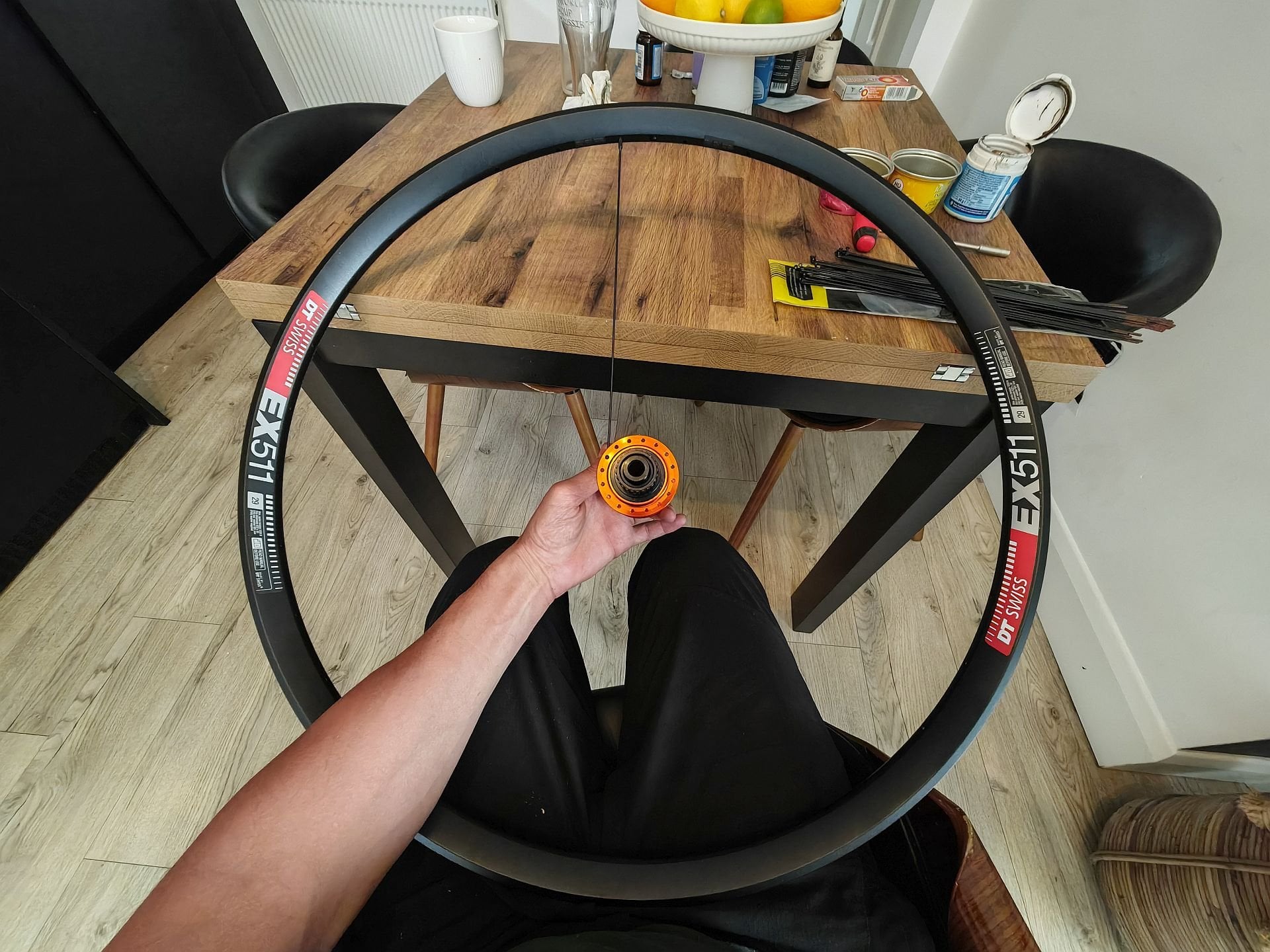

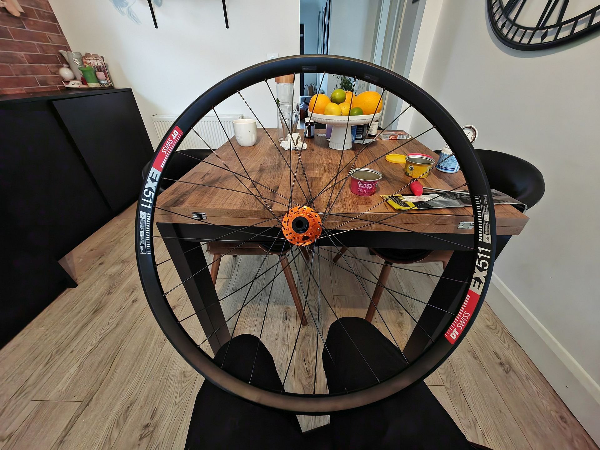

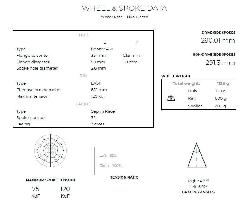

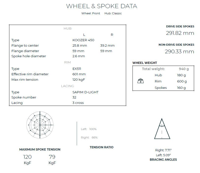

My recepcie for a set of very strong wheels:
Spapim RACE for 0,67eur a piece bellow:
Regards
