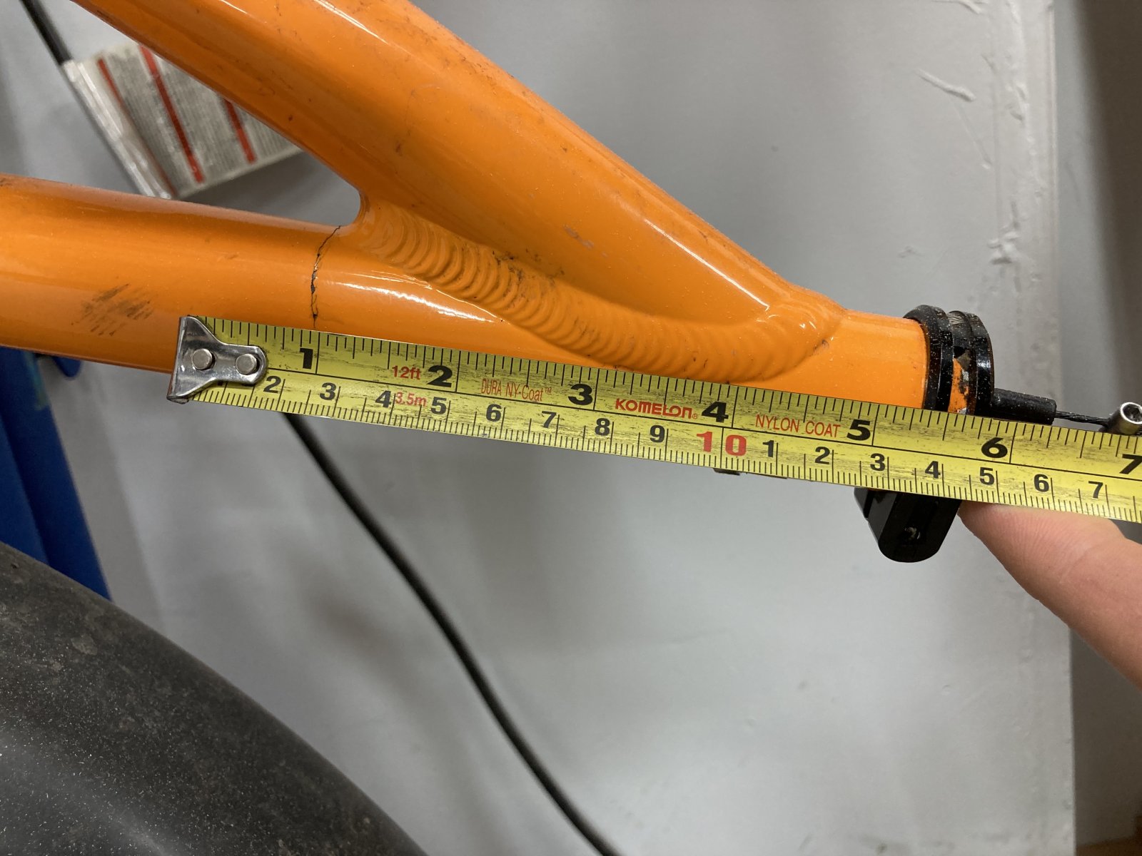

Hi guys wanted to share what I discovered as I was getting ready for a ride today. Looks like I'll find out what the warranty process is like. Chatting with the guys at Commencal USA on the phone made is sound like a smooth process assuming they can find an XL frame to send me. I really don't want to have to buy parts to make a newer frame work with what I have. 3 rides ago I got a new 27.5 rear wheel built.

Still waiting to find out if there is a frame available for me. I did hear back from Commencal USA yesterday with a request from the "engineers in europe" They wanted to see a photo of me on the bike as well as photos of the seat post out of the bike. I'm not sure why the wanted to see me on the bike other than to see if my set up has me riding way back on the saddle. One of the first questions I was asked is if the seatpost was above the min insertion line. I sent them a photo showing the post was inserted well beyond the min line and held next to a straight edge to show it was not bent in any way.

I can see why they asked about the saddle height. it looks very high up compared to the bar. And that's an XL, just how tall are you? :unsure:
Best of luck with the frame claim. :)
njn
Mar 14, 2018
340
178
I can see why they would ask, as it appears that the damage is where the bottom of the seat post would be.

I got word from Commencal that I didn't need to send the frame back after all. I needed to send them proof it was destroyed. Which is great as not I have an extra rear triangle and linkage just incase. There's a strange feeling to taking a sawzall to your bike. Since I had the opportunity I decided to do a bit of an autopsy.
I believe the crack started on the edge of the weld circled in this photo and went unnoticed for a while. One of the many reasons I don't want a carbon frame.
Here's the inside
You can see that the seatpost extended well beyond the crack.
In the end I'm happy with the way things were handled. The shipping hold delay was a bummer, but it is what it is. The guys at Commencal USA are great to deal with. I think this will be my last orange bike. The only other frame I've ever broken was also an orange full suspension bike.
