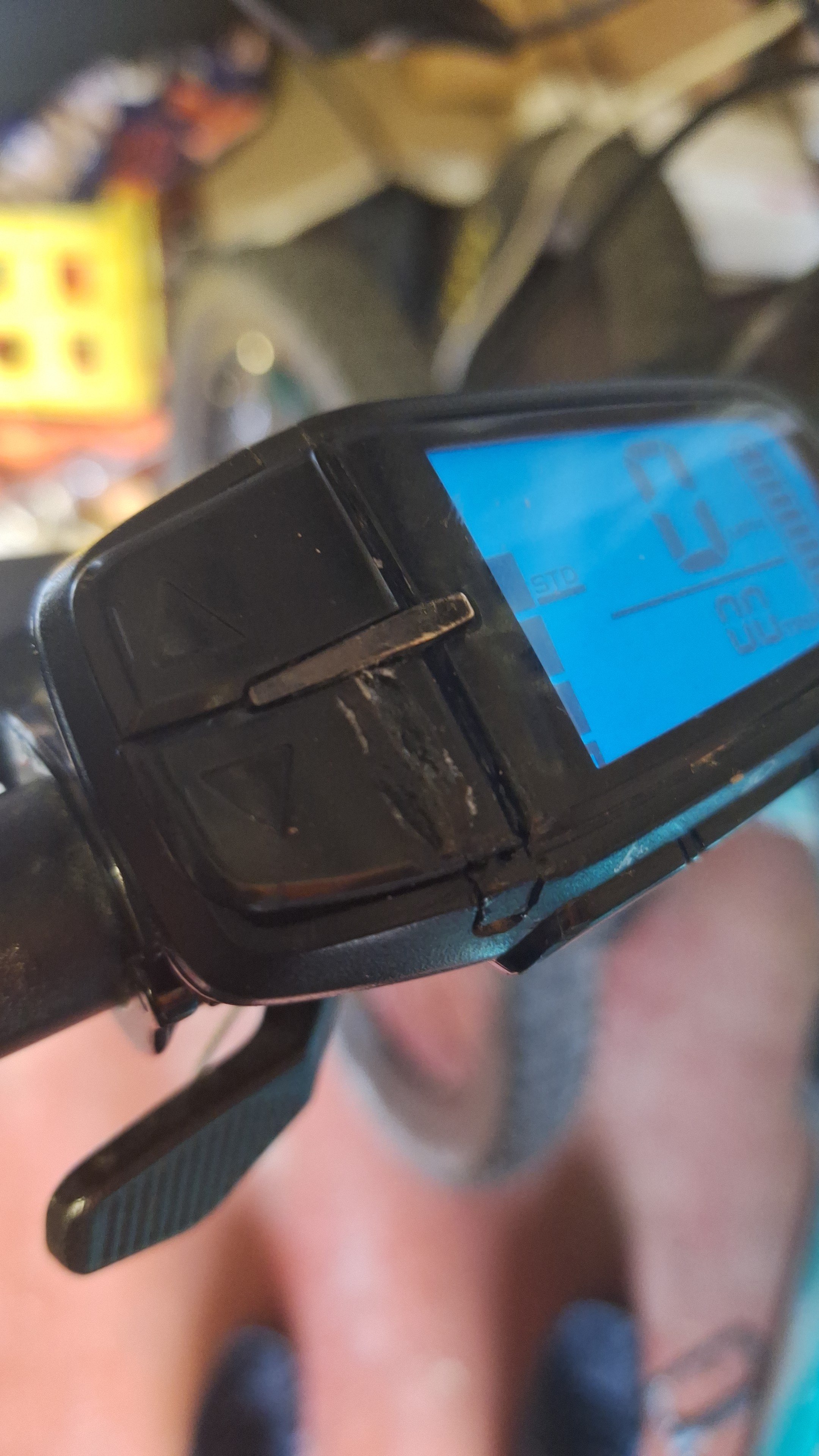

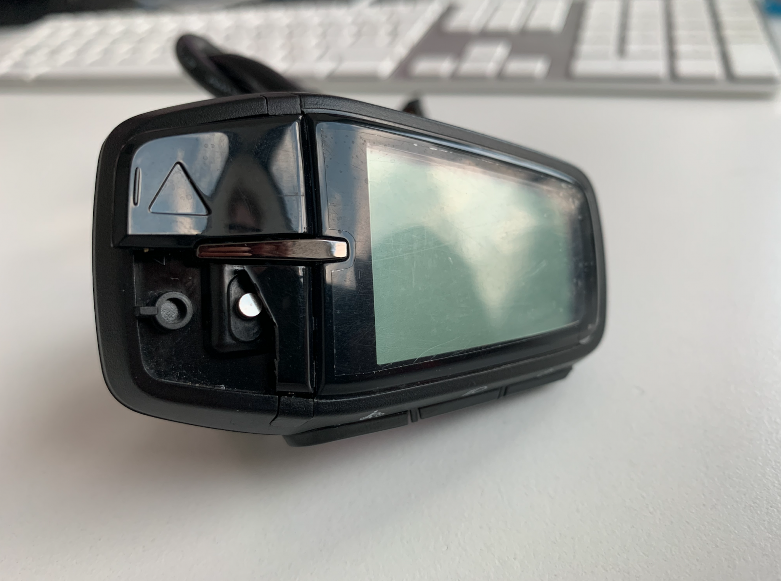

Happened to me also on rented Hibike. I had to pay for new one ?. I can't believe the design flaw... This is really crazy. I got the one with the lower button broken. If anybody need it I sale it for 30 €.

This broken button looks exactly like on the first picture. It looks like there is a stress concentration at that area where it cracked, looks like the button bends over that metallic color switch.
This is not the first issue with Yamaha e-bikes equipment buttons, Yamaha battery level check buttons have issue too, those cracks after some time.
If it was me I would create CAD model of those buttons and ordered them to be 3D printed on HP MJF 3D printer out of black nylon and replaced the original buttons.
I'm not sure if those buttons are possible to replace though, it looks like the housing is glued or ultrasonically welded.

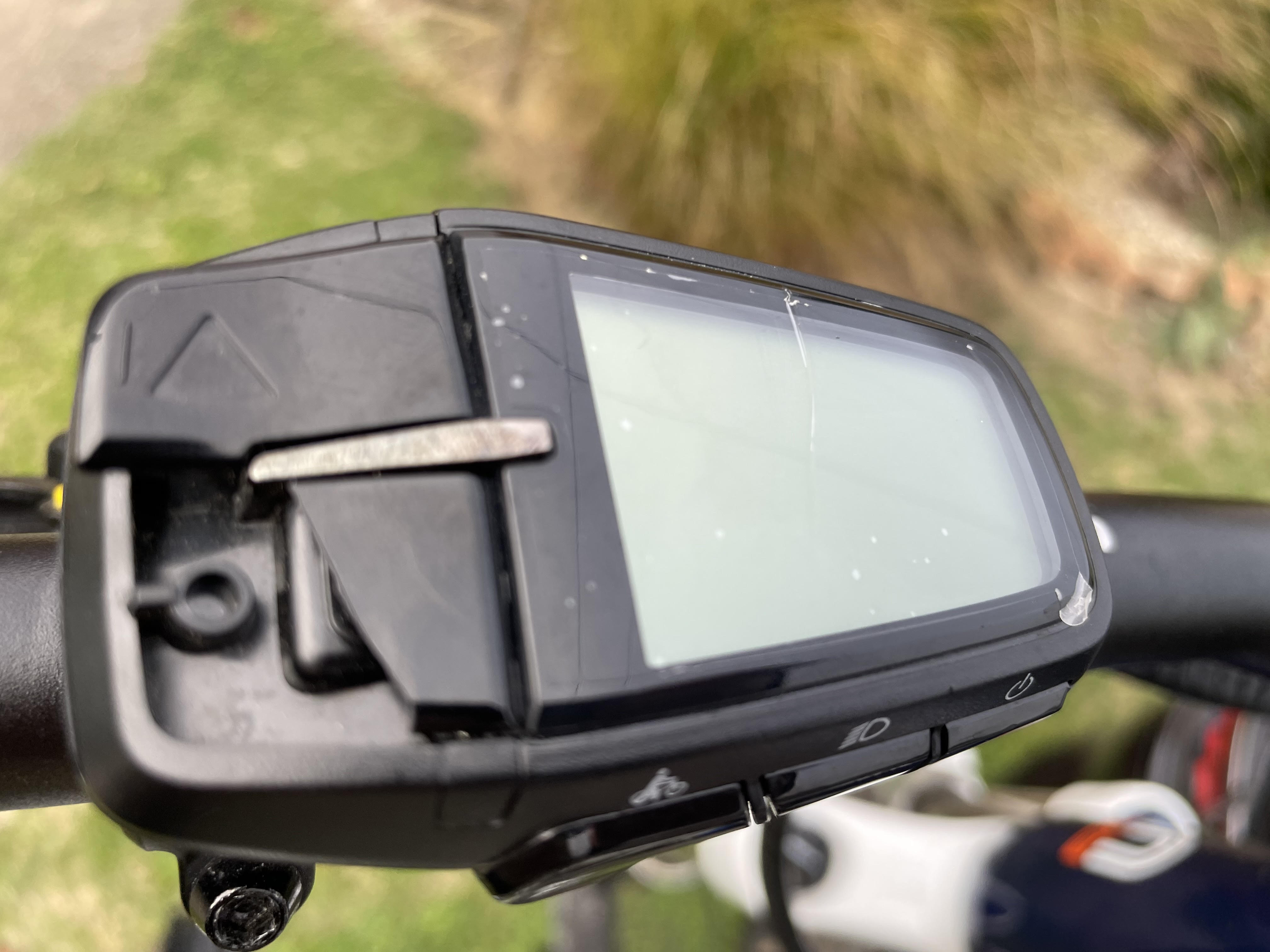

Hi all hope this helpw.
Mine broke while riding and it was replaced under the warranty. I explained that it snapped while I was riding and changing the power setting.

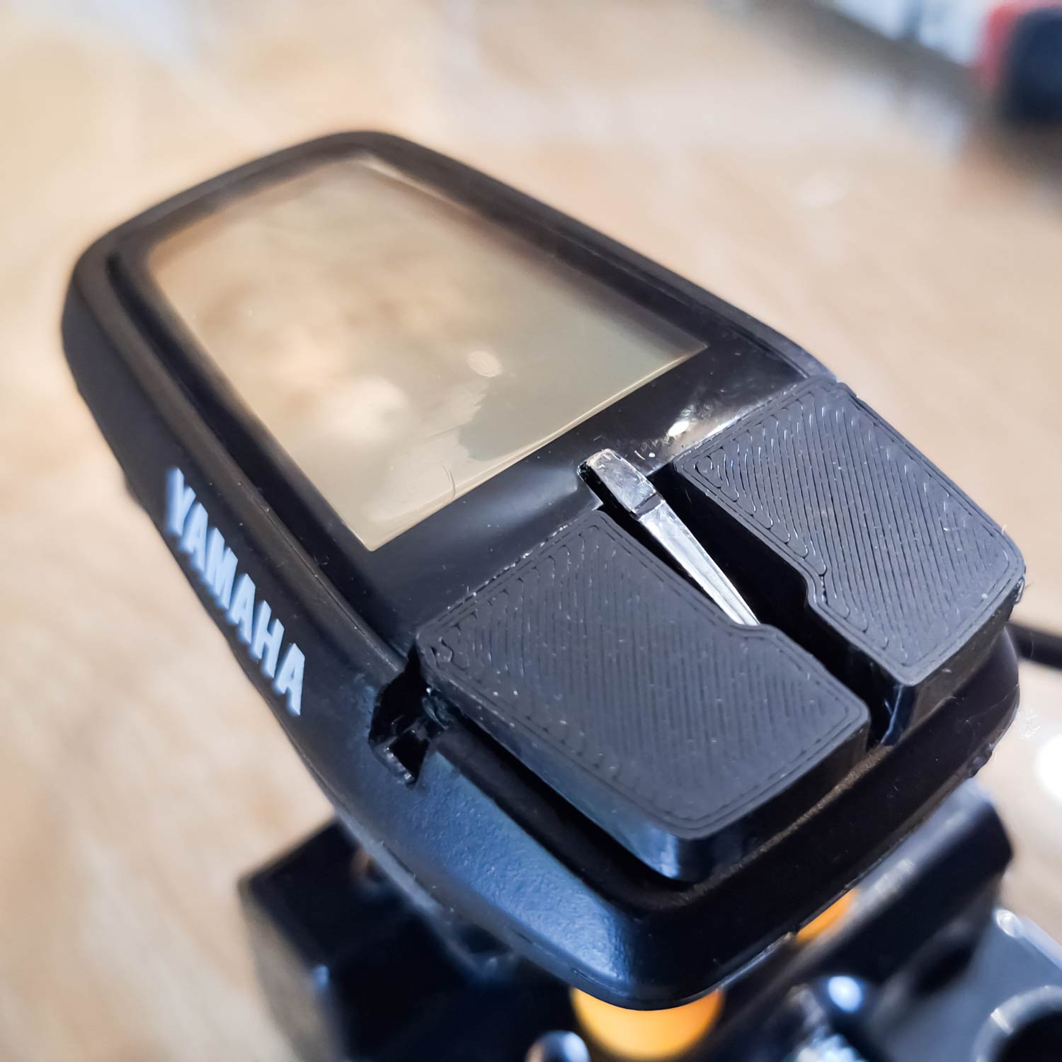

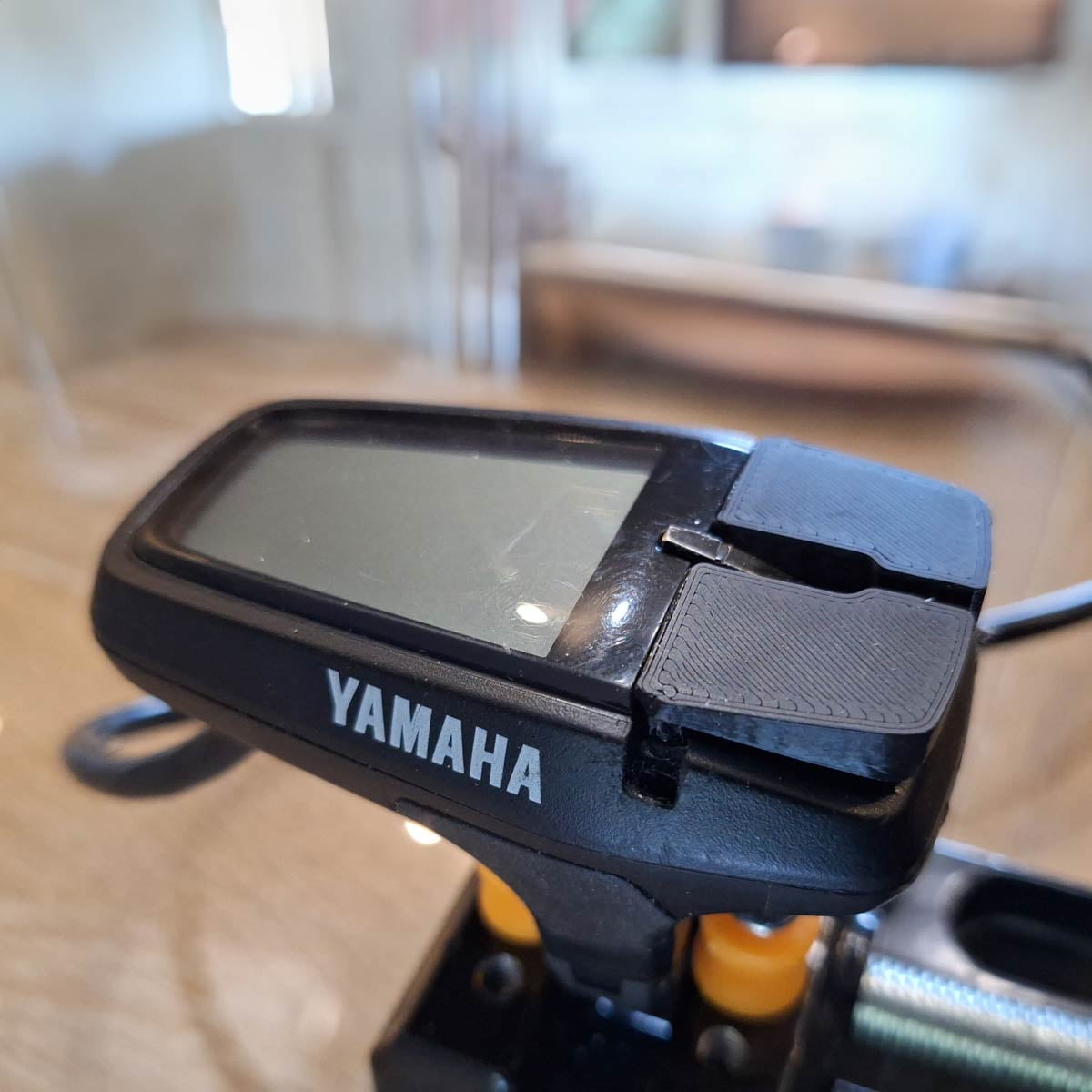

I designed the button👍

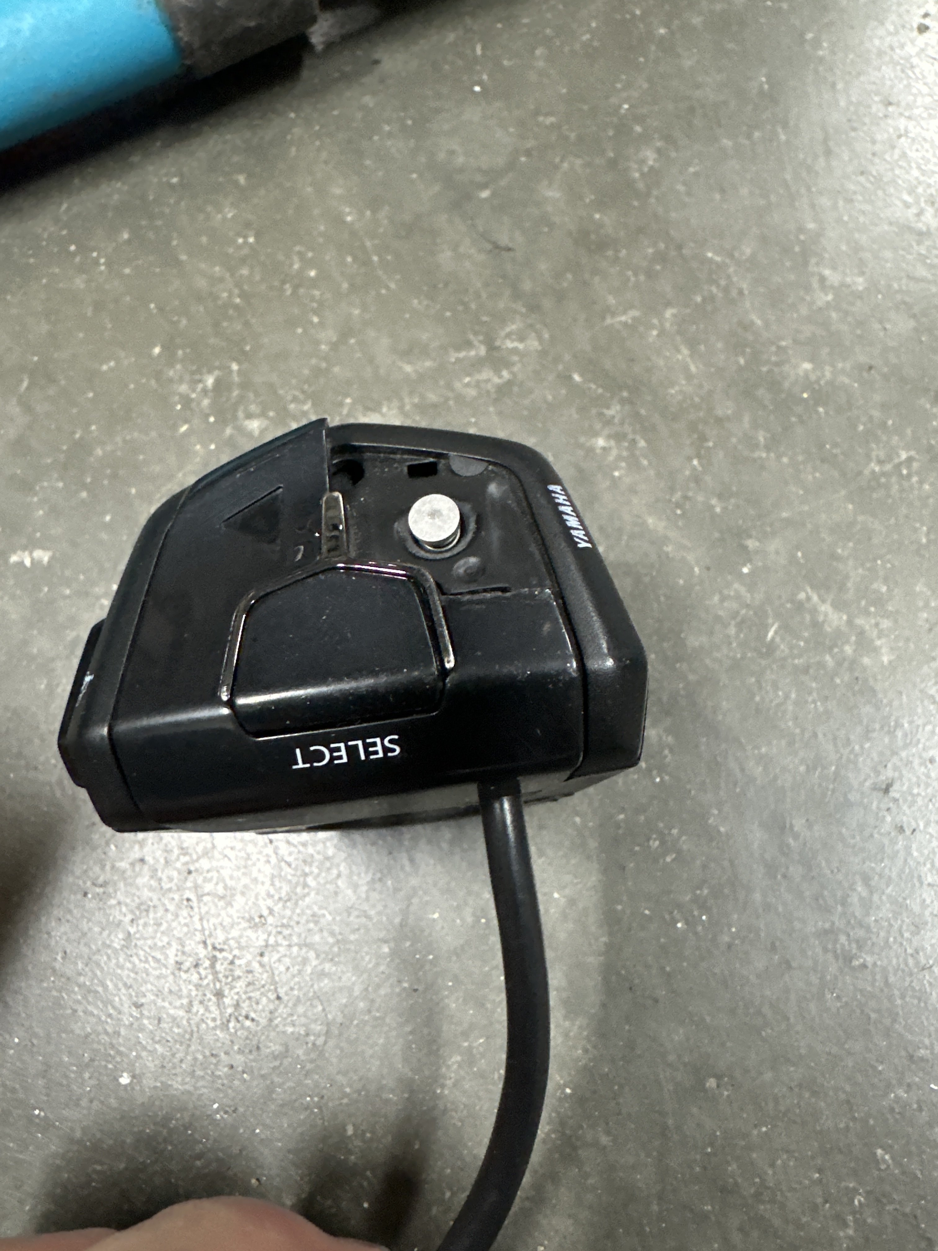

Ron23
Oct 29, 2022
7753
Hi Lubi,
sadly I am facing a similar issue.
Today I broke the bottom button down on my mother-in-laws bike. You can imagine the delicate situation.
Have you tested the 3D printed model? Is it replaceable?
Above one user wrote: "I'm not sure if those buttons are possible to replace though, it looks like the housing is glued or ultrasonically welded."
Thank you in advance!
