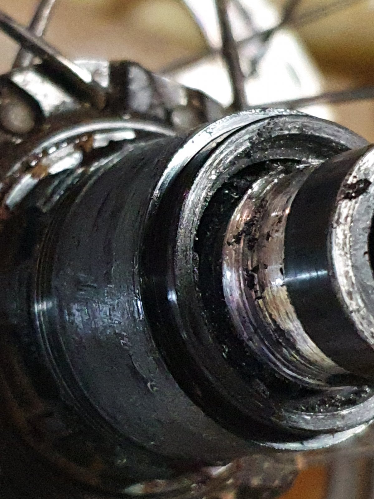

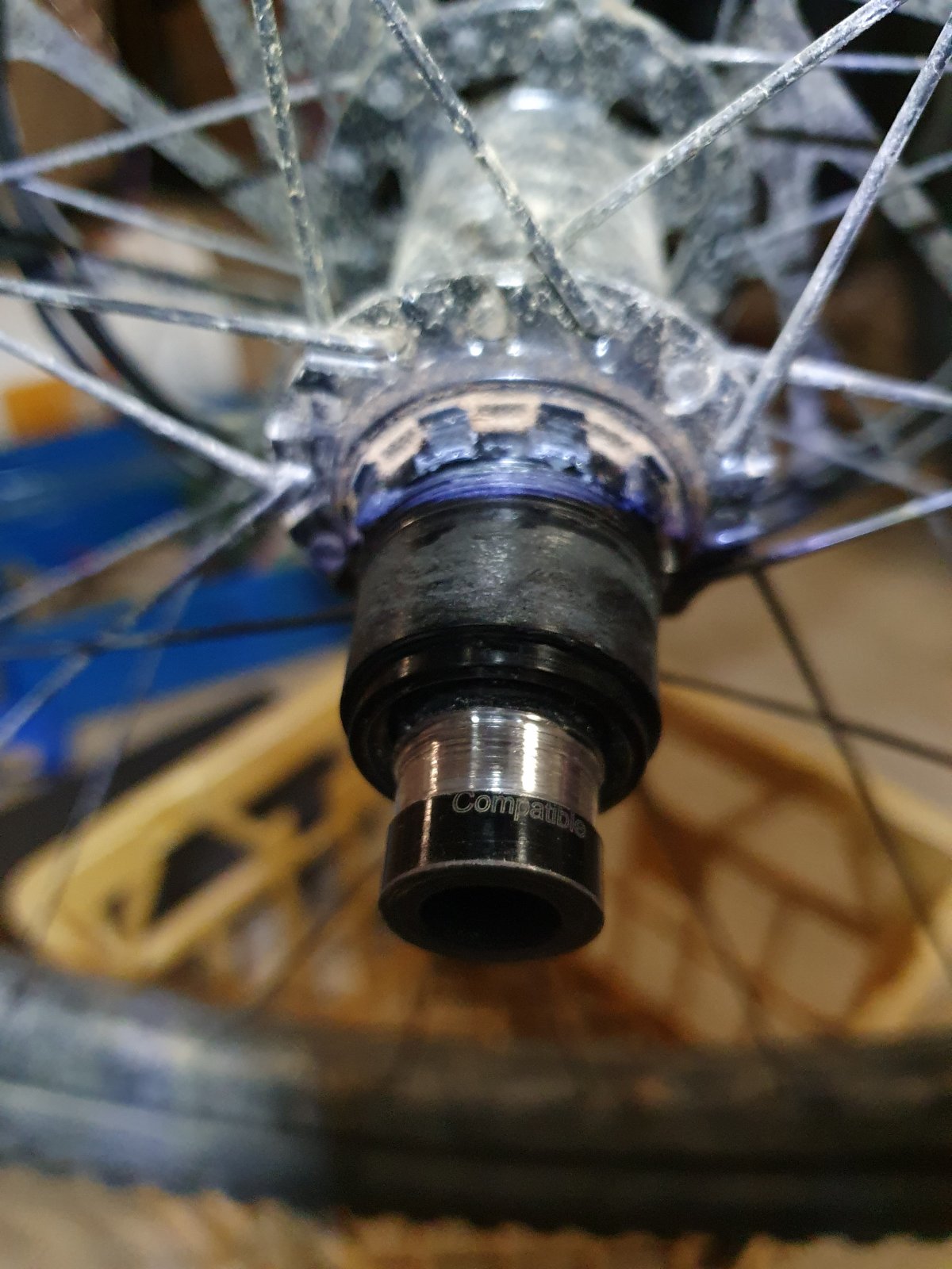

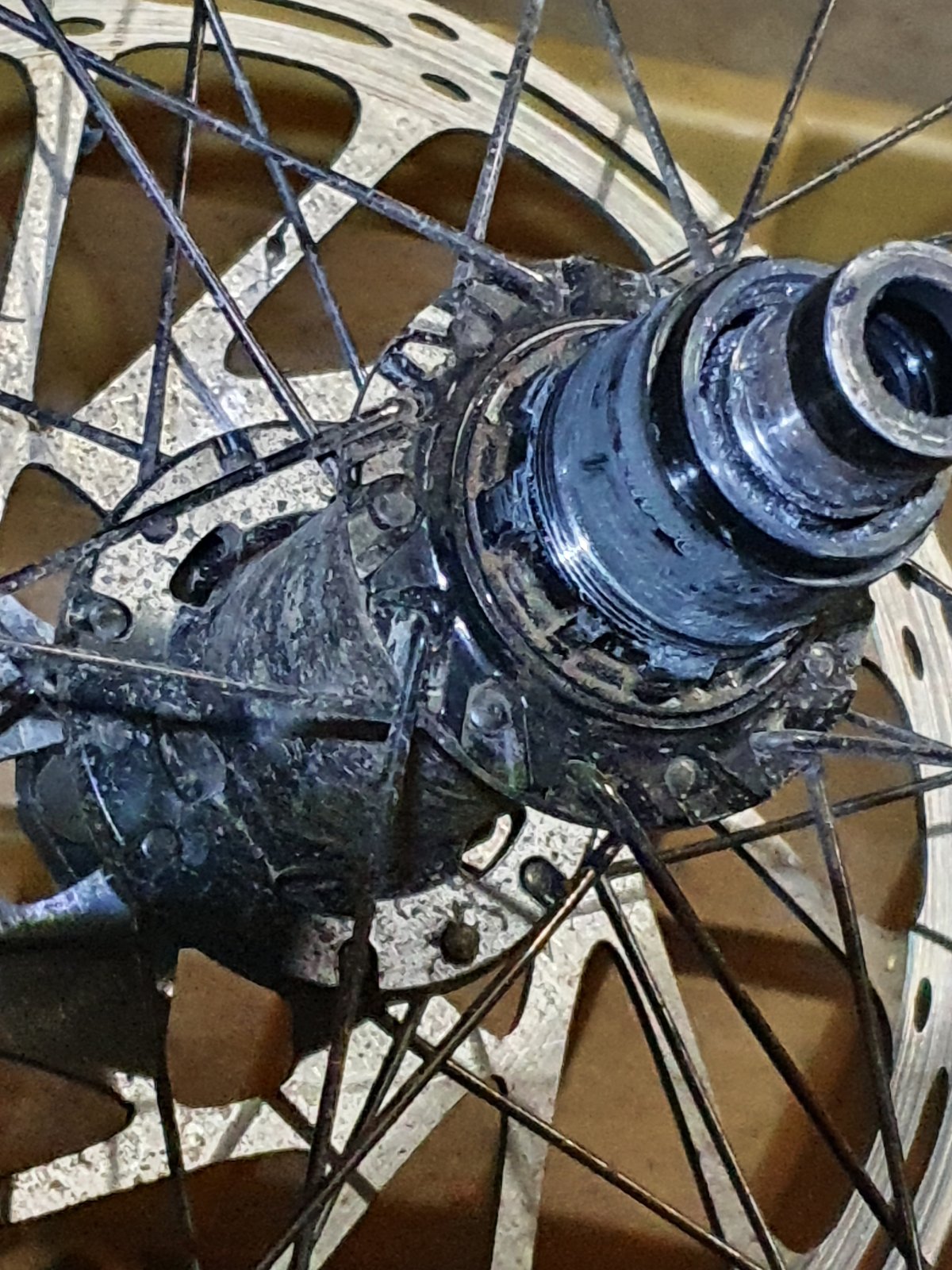

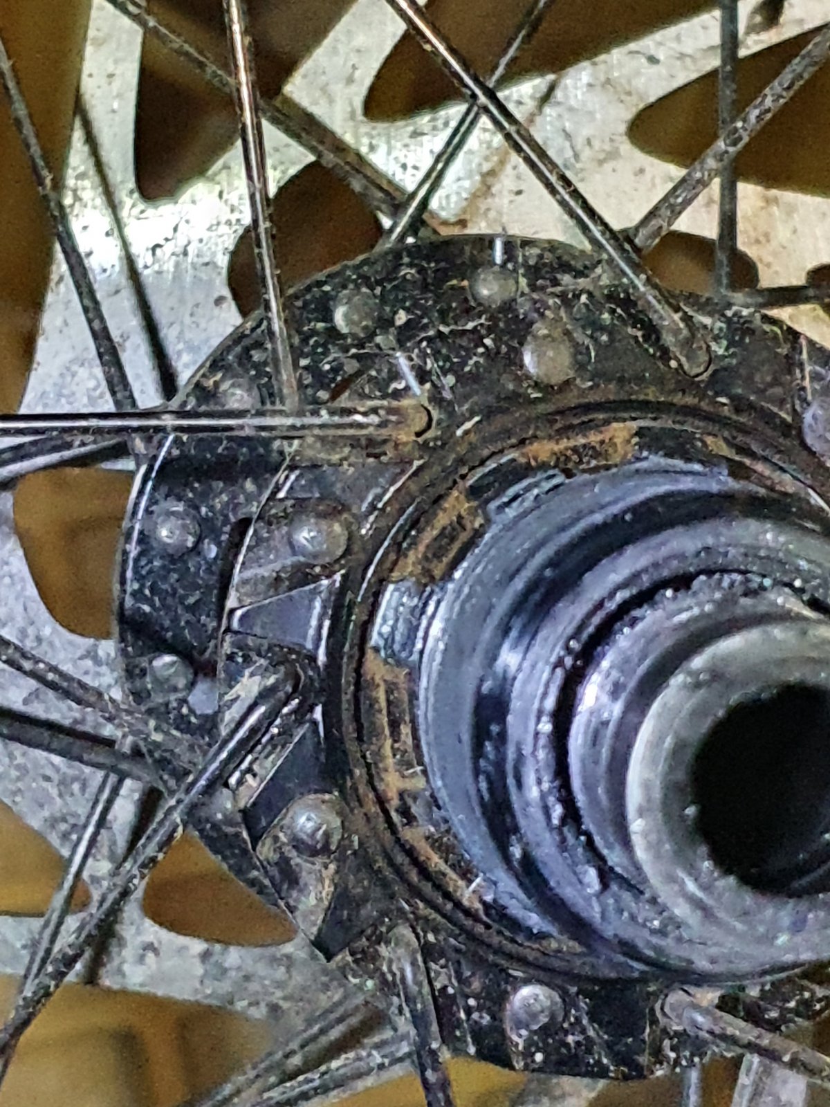

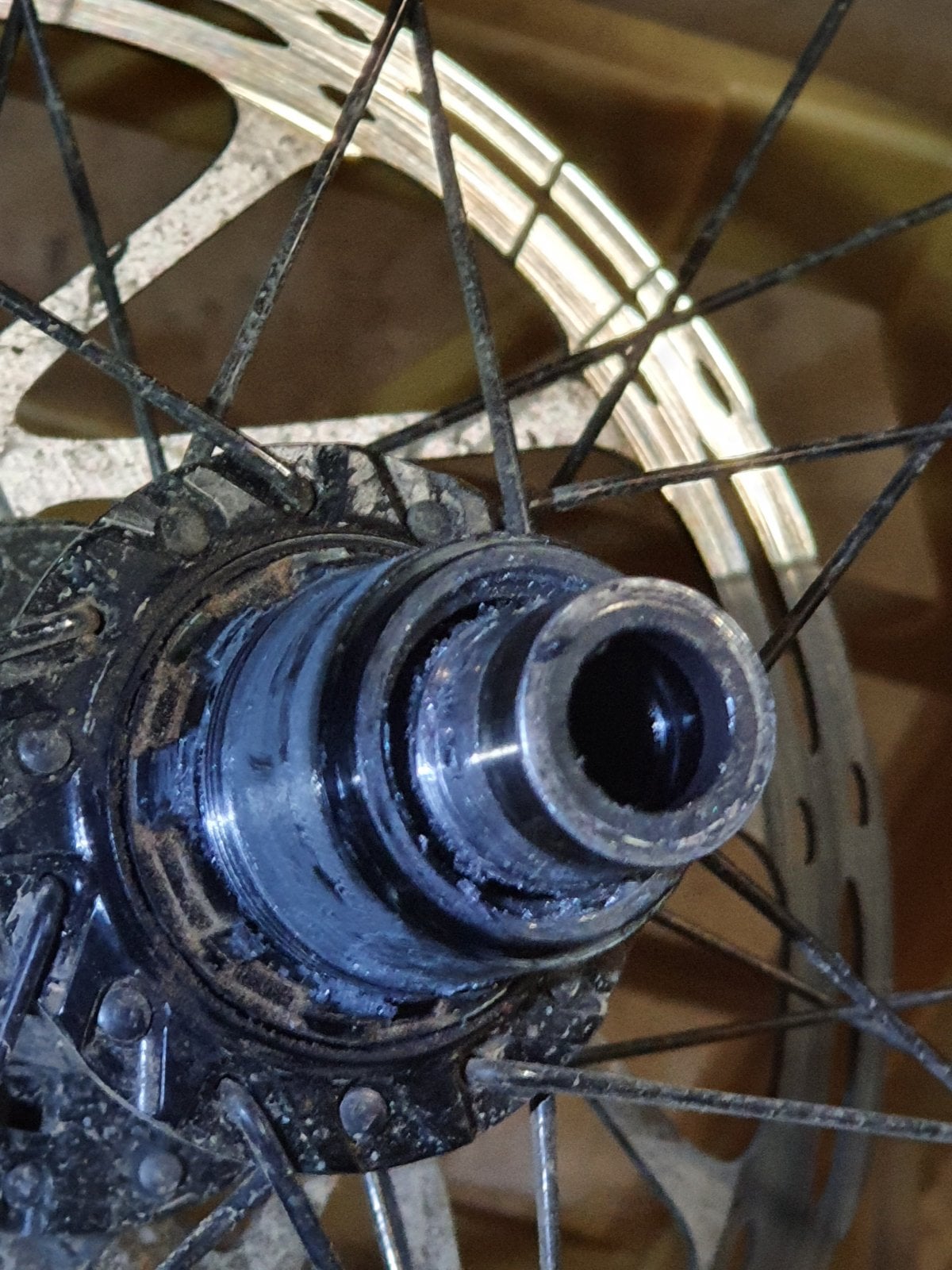

Ummm . Yep . Do I need a new hub or does this bit come out . Either way looks like I'm gonna have to visit LBS . At least I'm hoping this is the cause of the horrible " im a motor dieing noises"
maybe just the freehub body, like a hundred bucks if no warranty
Specialized only warranties the original owner. You will at least need a new freehub, but there is some weirdness going on. The hub spacer is cut into pretty hard which makes me think the cassette was not properly installed. Another cause could be riding the hub loose causing float. My guess is that you were having some serious shifting issues as well. Most likely the hub needs to be replaced so it is a good opportunity to upgrade.

Yeah u got all that right. Nice detective work ?. Except the warranty part . Warranty is transferred to new owner with original receipt. Although I won't push for it if they wanna charge me cos I'm the one who put the cassette on. And like the owner he is cool .
