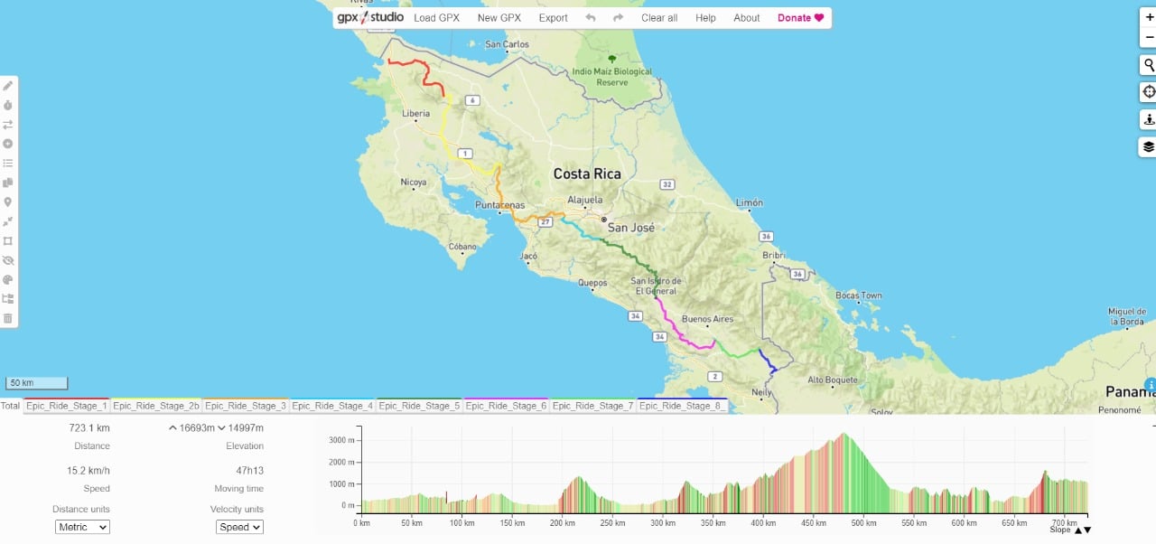

On a recent trip, with 2x625wh BOSCH batteries on Gen4 CX, we averaged comfortable "1000" meters of "Ascent" (Aprox 3300 feet) for each fully charge battery.. Days with 3000+ meters of ascent we would charge during breakfast and lunch... (The other bike had a PW-X2 Yamaha motor, about same results). Our target was 1500, and we maxed out about 1500 meters with one battery full charge. This could be 29Kms of HARD 10%+ average grade or 100kms of flat, hilly gravel. My weight 82Kgs, my load 12Kgs on the backpack, bike 22Kgs. Tires, 20/21ps, maxxis rekon+. May be this can help others calculate a specific range. By the way, Costa Rica is not a small Country. is a HUGE mountain bike park.!! cheers.
