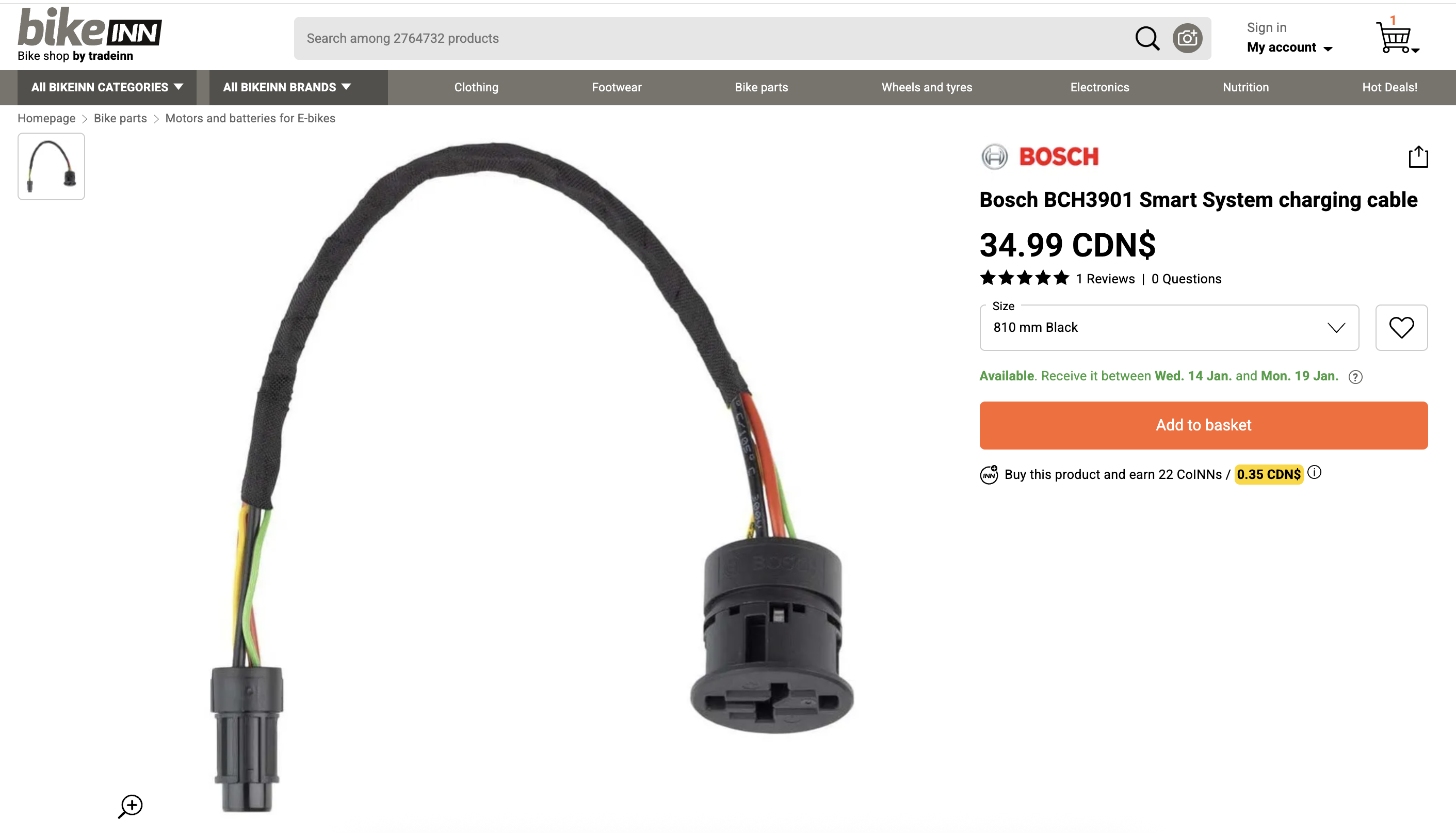

I will go back to the dealer where I bought my bike, only trick I'm going to try is changing the charge port to this beforehand.

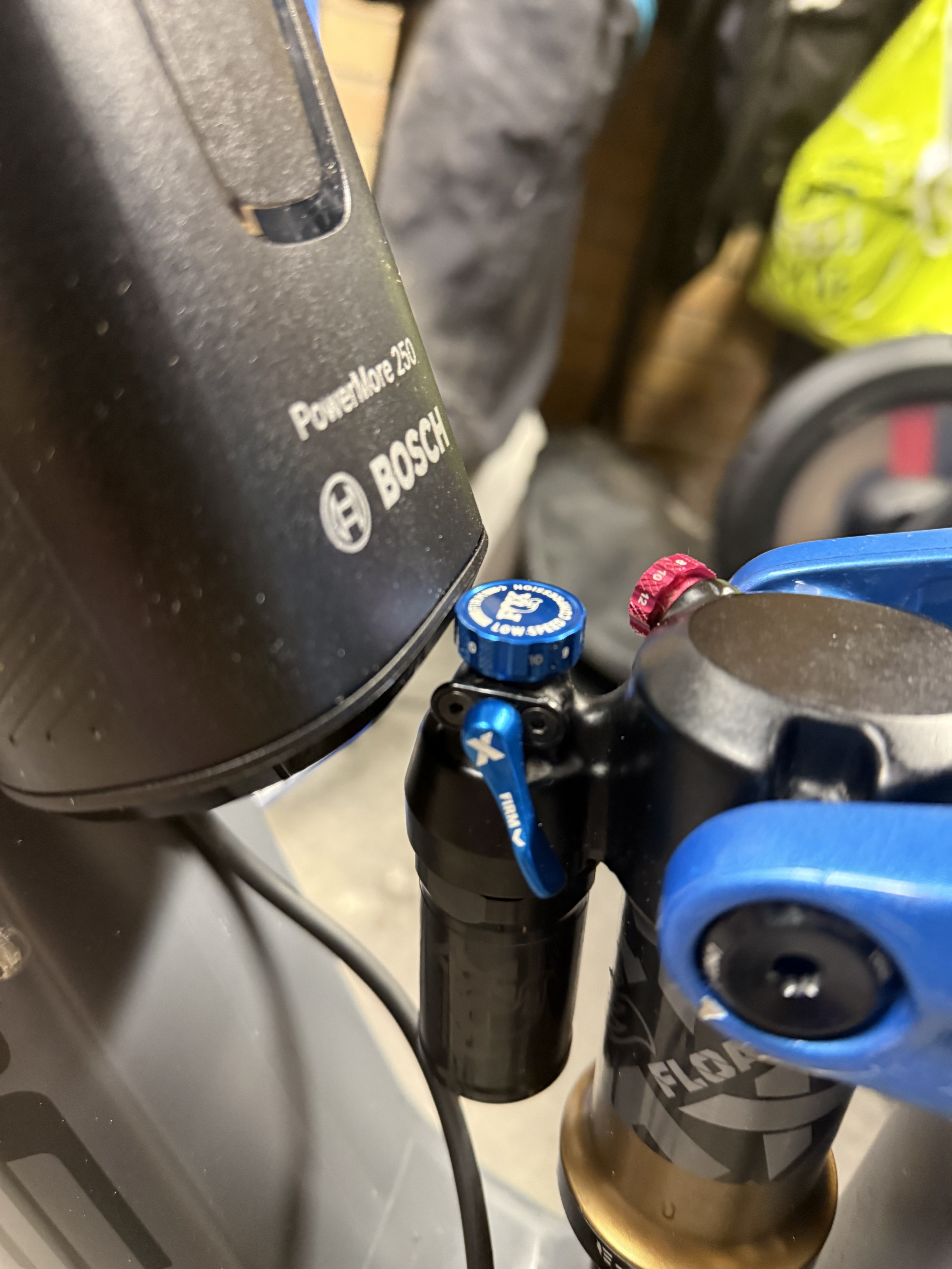

Soooooooo after tons of back and forth. Seeing more and more people running these, here and on YouTube I pulled the trigger
And it doesn’t fit
Looks like there’s just enough room until you compress the suspension
And then it hits the range extender
It’s the tiniest like 0.1mm collision. You can just hear it scrape. I suspect filing down a bit of the plastic on the range extender would work but I’m going to investigate if there’s any offset bottle mounts to raise it up a few mm
I should add the 250mm cable towards mount is perfect. And there was nothing to do for the bike to see the extender. Plugged in and it appeared on the kiox instantly

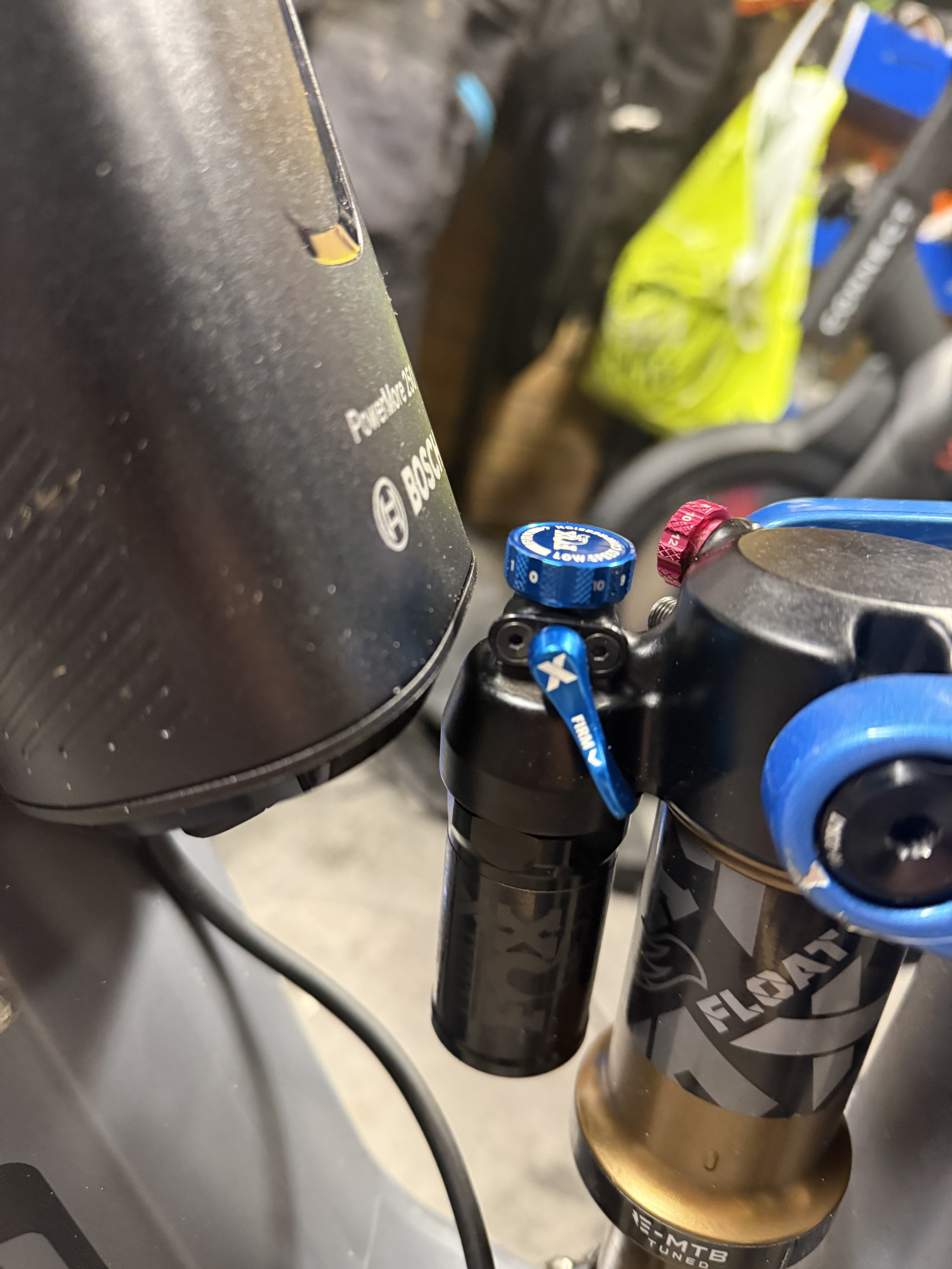

And it doesn’t fit
Sorry Phil, mine fitted no problem. As a possible solution, could you modify the mounting holes on the range extender frame bracket so you could move it up slightly?
It’s no bother. Maybe there’s slight differences in the mounting holes I dunno
I definitely could alter the holes to get a bit more clearance but there’s a metal reinforcement in them. The mount is only £9 so I’ve ordered a 2nd one to try
I’ve also ordered a b-rad rail and I’ll try that to see if I can mount it a bit further up the frame. Really sad that cube ended up in this place as there’s plenty of room for the mounting holes to be higher up the frame
Wolftooth make brackets for moving bottle cages (or range extender mounts) up or down from their default position.
Yeah that’s what I’m gonna try. My concern is they add height so will push the extender more towards the shock
And it doesn’t fit

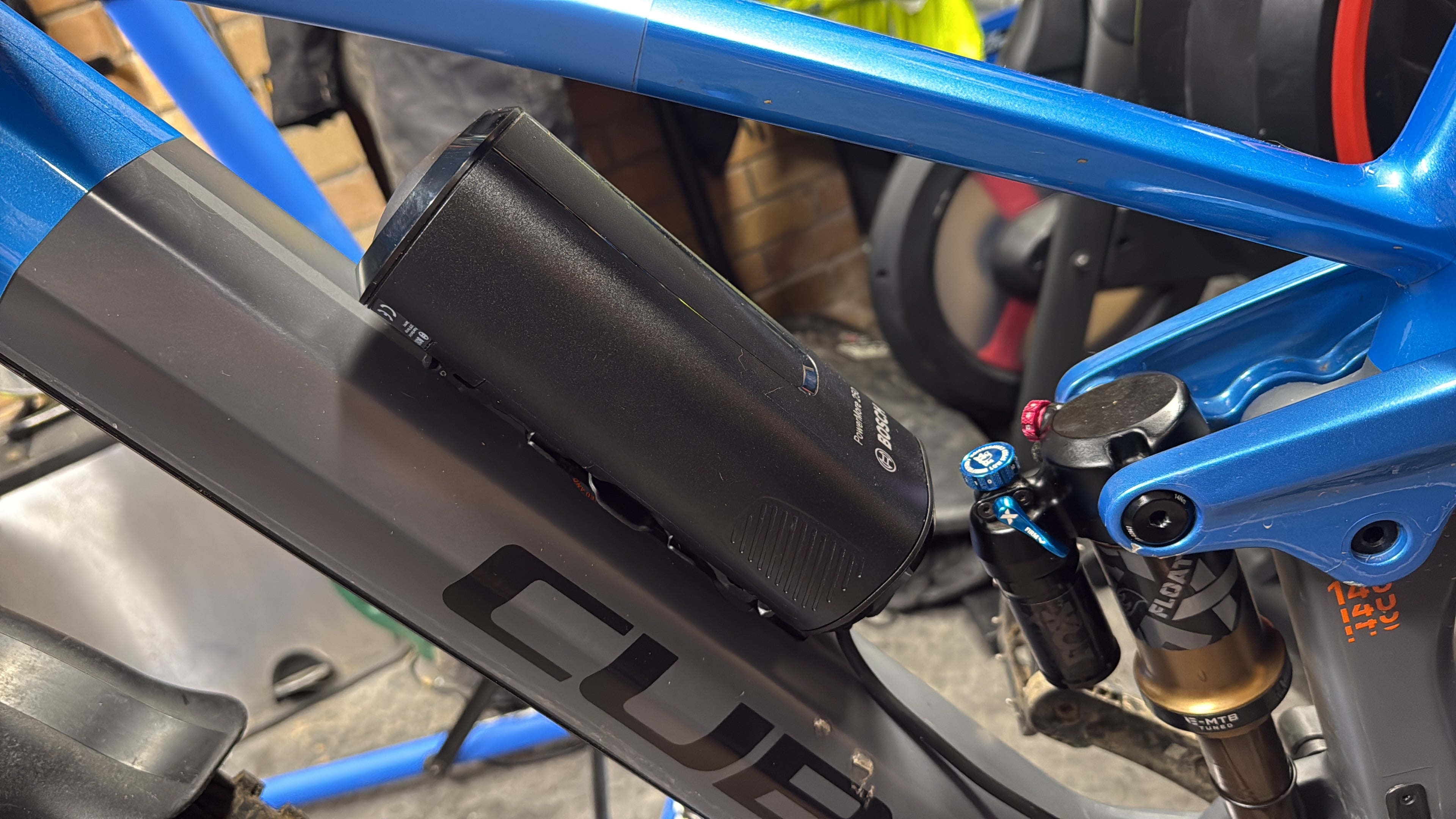

I 3d printed a b-rad yesterday and tried it.
Definitely gives loads of clearance but the extender wobbles about a lot. So getting a proper metal one delivered today
I think with the combination of that to move up the frame about 10mm and maybe a 3d printed surround to give the bracket a bit more support it will work fine
I’ll post updates when I have them 🙂
Bought one of the b-rad rip offs on Amazon for like £5. Works a treat
Shifted the extender up about 10mm, tons of clearance. Feels pretty sturdy. Been out and done 20miles around Sutton bank today with no issues
I definitely wouldn’t have it on for jumps at Hamsterley or fast berms. But for a long afternoon out doing XC it seems fine 🙂
The adapter if anyone wants one
Bike Bottle Cage Adapter, Bicycle...
For £5.49 it’s made of metal, comes with a variety of different length bolts and works well 👍

Just as a follow up - I’ve done 3 rides with the powermore now and it’s all been flawless. I love the way the bike uses both batteries in combination, my friend has a shimano motor and that uses the main battery first then has an awkward cut over when it switches to the extender.
I also replaced the invisiframe that had damage and my god that company is a pleasure to talk to. They sold me just the damaged piece, removed the old with a bit of heat and replaced, looks like new again 😁
