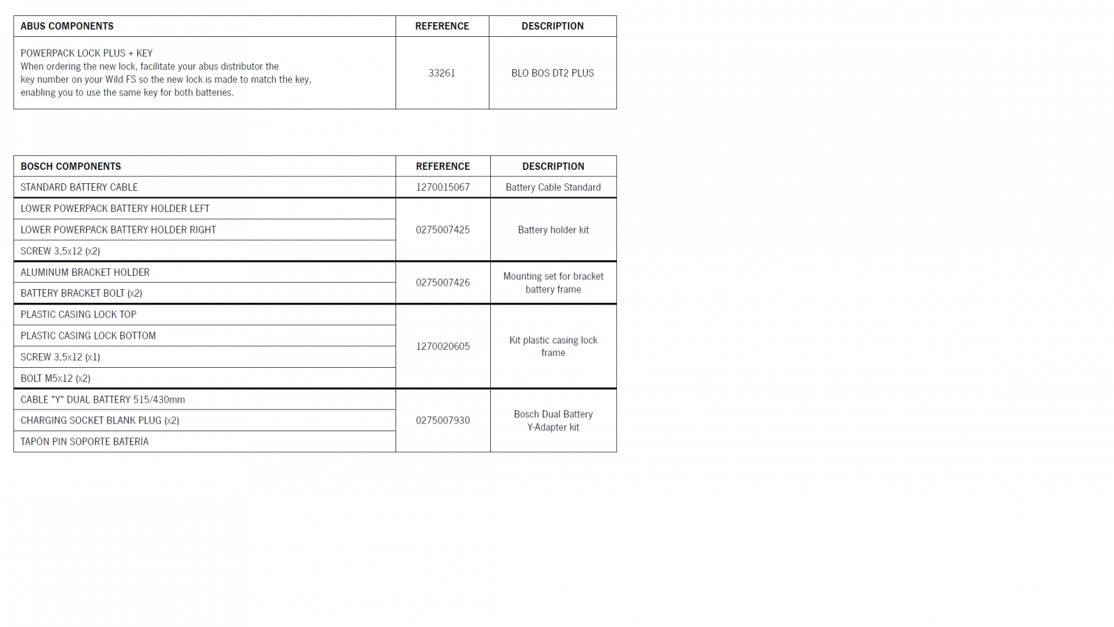

some of the bosch bikes have the ability to take a piggy back battery, you could look to see if you could adapt your whyte to use the official bosch piggy back system even though it doesnt have the mounts for it.
If you go to the orbea spare parts website (Spare Parts — Orbea ) you can buy all the bits needed to retrofit the piggy back battery to a wild FS, no reason that this shouldnt work with a whyte, if you can find a way of attaching the battery holder to the frame and route the extra wiring.
Heres the battery holder
WILD FS 2020 EXTERNAL BATTERY HARDWARE KIT — Orbea
the wiring loom, battery, and mounts are available from a bosch dealer, then you'll need to get the bosch firmware changed to tell it that you have the piggy back battery.
Its that or carry a spare battery in your bag and swap when you run out of juice,but I think that the whyte is not easy to remove the battery.

Thanks for this, yes re: removing battery is a pain due to frame design hence why I sort of discounted carryjng another full battery as they are long too but a piggyback system sounds good I will have a look at the orbea system
Thanks

Didn't miss it.... sure, there's bound to be room for the battery holder, but not for the battery itself. And I dare say mounting it elsewhere on the bike is going to be really, really troublesome.

ok, a bit pendantic.
I was just offering up ideas to the op, obviously I have no idea if they will work in reality, I dont offer any warranty implied or explicit with any of my posts.

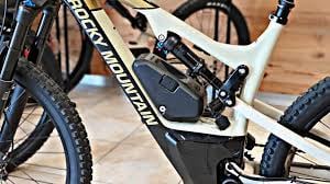

Never seen one in the flesh, but BMZ do a range extender in bottle cage format, and are a reputable company who make the OEM batteries for a lot of companies
