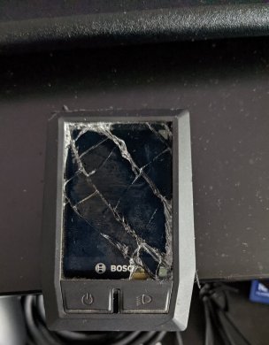

Damm:
I am getting a kiox fitted next week and I was not aware that this was an issue of them falling off. The shop said that I should screw it on, but one of the benefits of having this was the immobilisation of the bike when not on the bike.
I thought it might fall off if you are Auditioning for Red Bull Rampage, But looking at this has got me slightly worried maybe should just stick with my Purion.
Damm:
just use a lanyard, that way you can remove it when needed but it won’t get too damaged in a crash.
Thanks for the tip, I'm going to attach a lanyard. Only had my Cube 160 with kiox display for a month and I've already had it pop of twice. (light falls, nothing serious) Fortunately the display is still sound. The magnet is strong until its not. I prefer the lanyard idea to screw as I think if it pops off it's less likely to break.
