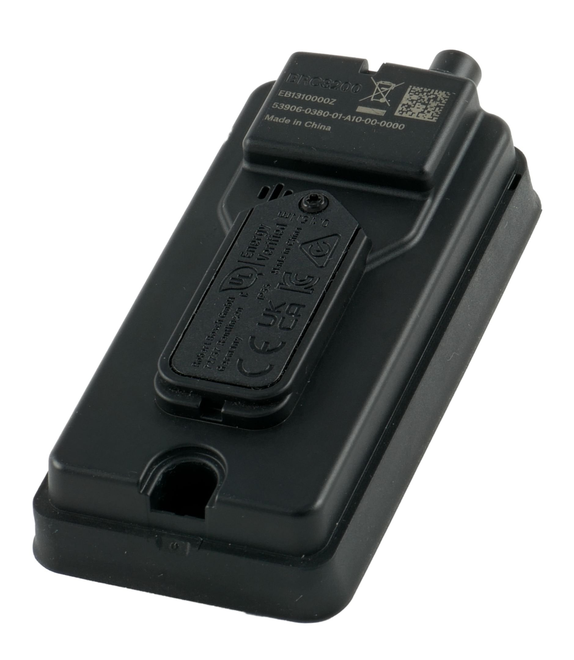

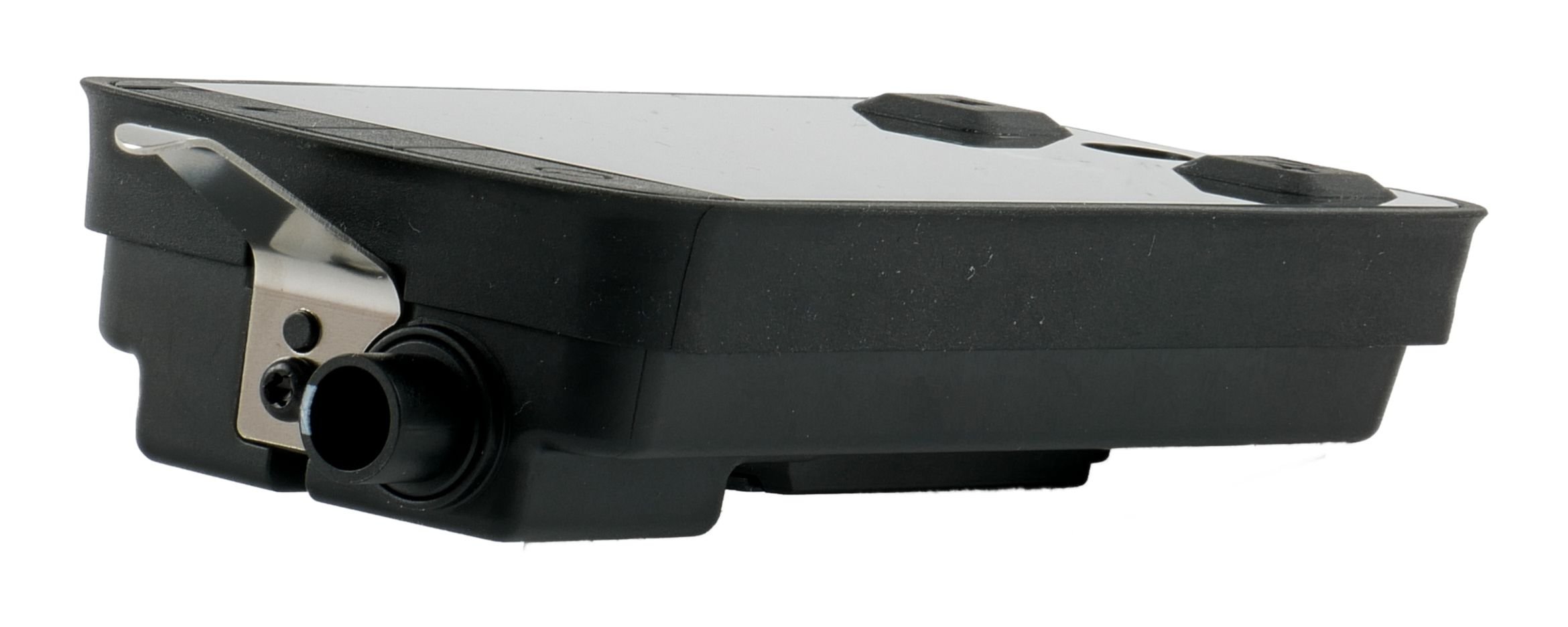

Received my Kiox and Mini Remote today to start doing some 3d print R&D
First off I can confirm (as the press release was a little vague) this works fine with the older Bosch Smart - specifically my motor is a BDU3741 - last gen Performance Line CX.
As you can see from the picture it also seems to work fine with the optional alarm/gps tracker unit which I have fitted.

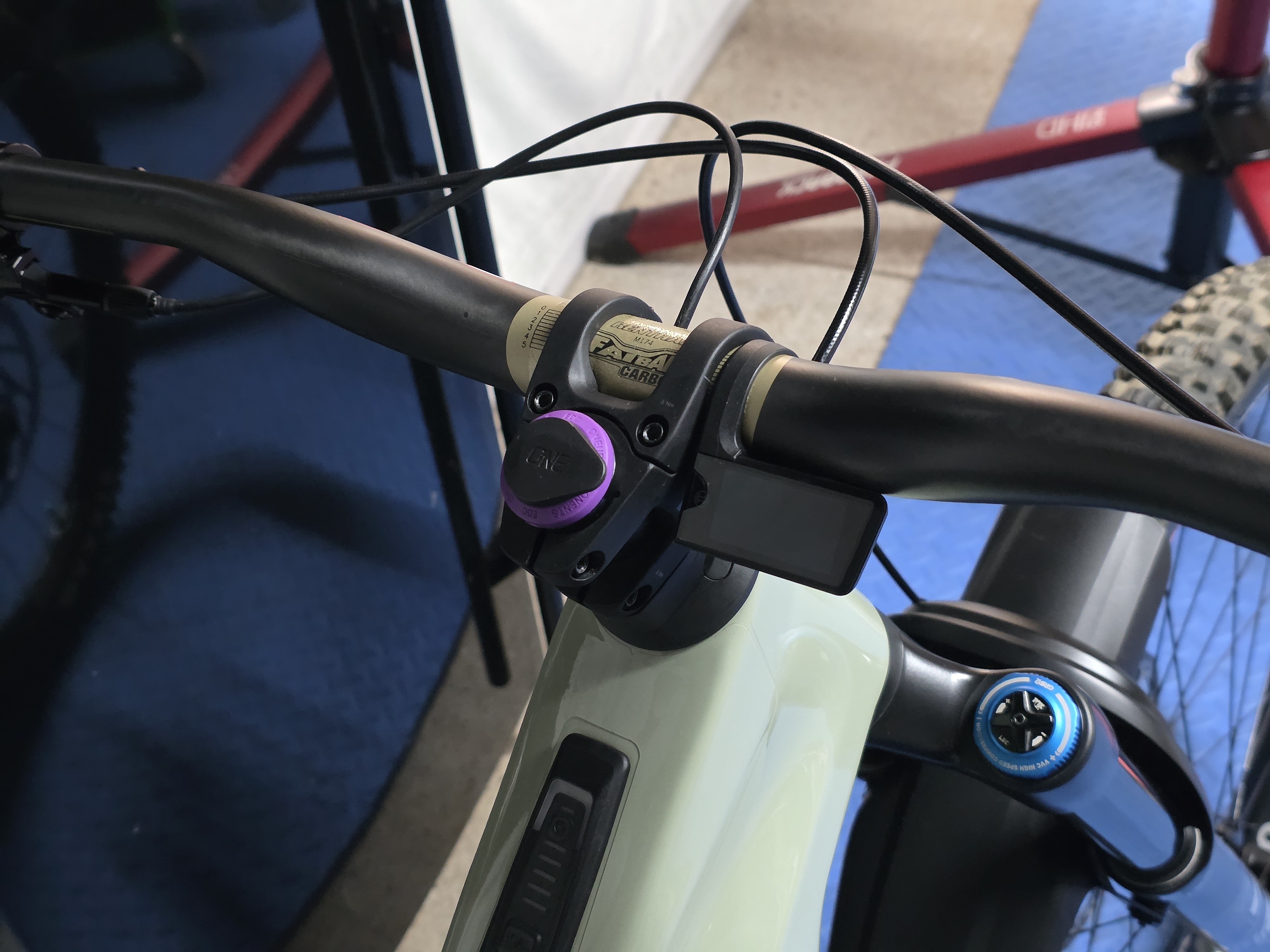

This is what I have so far - it's V15 lol
I wanted the garmin mount to be removeable and easily replaceable - because if it snaps then you can buy a new mount for 60p from aliexpress instead of a whole new casing.
It's printed in PETG at the moment, should be fairly weather proof
I am going to add a tether to it so like my garmin, if people want to, they can add a tether to the bars in case the whole thing breaks off - better than losing a £200 kiox
I'll add pictures next week of it mounted on the top cap, which I think will look much more "integrated" but nothing will be for sale until I've had a day at the jump park and I'm certain it will last :)

Went out last night for a blast round Sherwood Pines - Kiox worked perfectly, as did the mini remote and no issues with the holder.
With regards to upgrade - I removed my old setup, plugged the Kiox 400c in, paired the mini remote, installed firmware updates - everything works. I even have the alarm/tracker which is also working flawlessly. I have no doubt there is probably a device conflict logged that my LBS can clear when I take it in but no faults displayed and no issue with bike performance.
