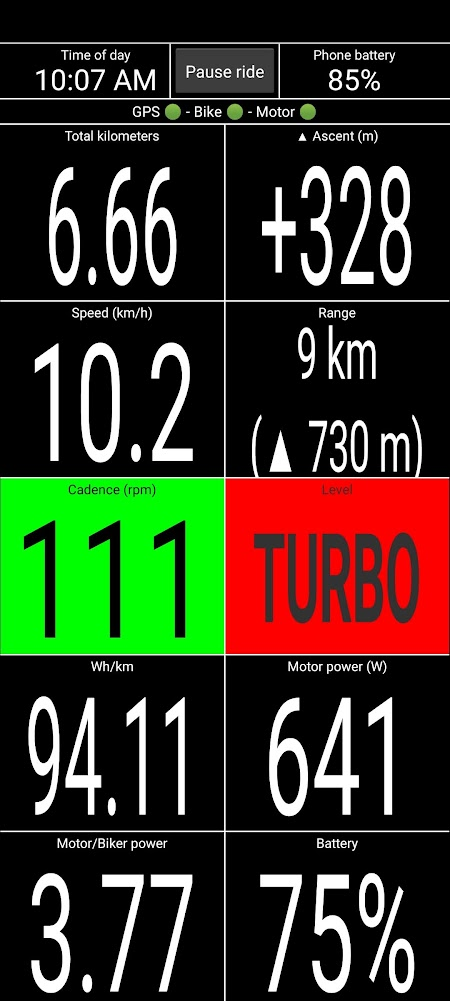

I did simple test
One time was in Tour (1:20), one in Turbo (1:23). (another time 1:21 was just a first climb, that's why it has more power)
I tried to keep constant 300W, however it's difficult on a gravel road.
From that, I'd say, motor power was the same.

300W is my constant power (and i can relate that to my other bike with power meter), not a motor (this is what Kiox display shows you and what is saved in GPX/TCX files). Motor gives maximum power at that time (in Tour or Turbo), thus, segment time is THE SAME in both situations.
Terrain was smooth inclined, I agree it's close to max 25-26km/h and some ppl could argue that data is incorrect. I could find longer steeper climb - this is difficult.

I don't see lightning symbol here (data from power meter), which means these power values are roughly estimated by Strava (from distance,inclination), but it's not very accurate (no info about terrain, tires, bike/your weight etc.)
Basically, on your images, this is total power estimated by Strava,
on my picture (with lightnings) it's only MY power recorded by power meter (from bosch system).

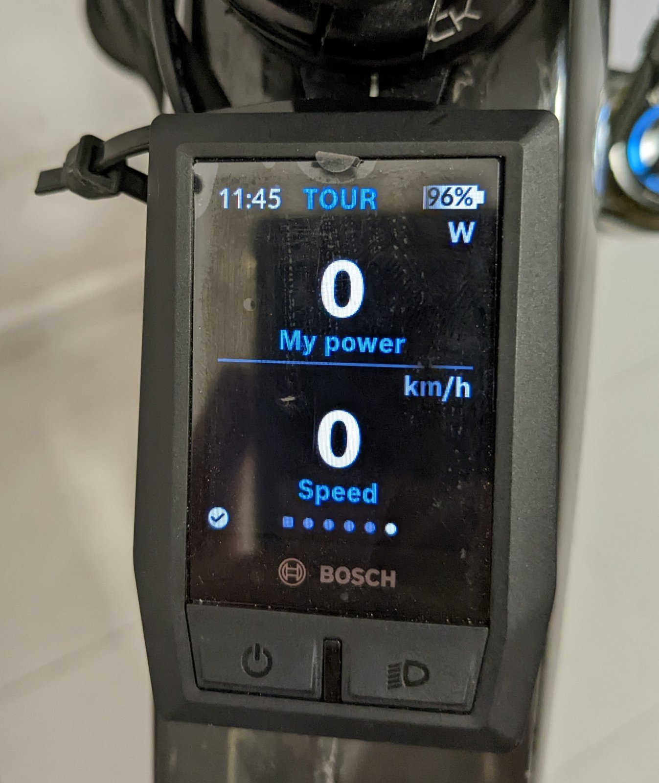

You do know on a purion/nyon and so on it generally will only show "TOUR" even if you have "TOUR+" activated in the firmware don't you ?
It would be pretty obvious when riding the bike if you have Tour or Tour +. The support in Tour when setting off and through the range will be pretty constant. The support in Tour+ will be less when you set off and the assistance level will increase the more effort you put in - like EMTB mode, but less - but unlike Eco and Turbo which feel more constant.

I had Nyon for a moment, there was an option (paid!!) to customize your modes 1-4 (instead of predefined eco/tour/emtb/turbo).
Now I have Kiox (with 2 buttons). mode is called 'tour' (I don't know if there is a hidden + ,how could i?)
Power delivery in my tour is like 'less sensitive' eMTB, if you try hard enough (which i stated from the beginning, above 280W) I feel it delivers the same power like in eMTB and Turbo

Great, then as we've said, you either have Tour+ (Magictour) or you have Tour and your bike is goosed.

So to conclude .. You have TOUR+.

I don't think he has Tour+, if he's got a Kiox it would say on the display wouldn't it? (Happy to be corrected)
He just can't feel any difference between modes, which is weird because they feel massively different to everyone else.
I think on most Purions and most Kiox's it just says "Tour" even if you have Tour+ installed on the motor.

Thanks, that thread you linked earlier mentioned it still just says Tour on screen.
I mentioned a while back to check the big coloured circle that goes around the bike's speed on the display. With my Tour the coloured part (motor power) will stop about 1/3rd (8 o'clock) of the way and the lighter coloured portion is 'my power' on top of that. If you have Tour+ this will continue past similar to EMTB and Turbo.
I never said that. Please read my posts more carefully. I said tour/emtb/turbo give the same (max?) power if you pedal hard.
