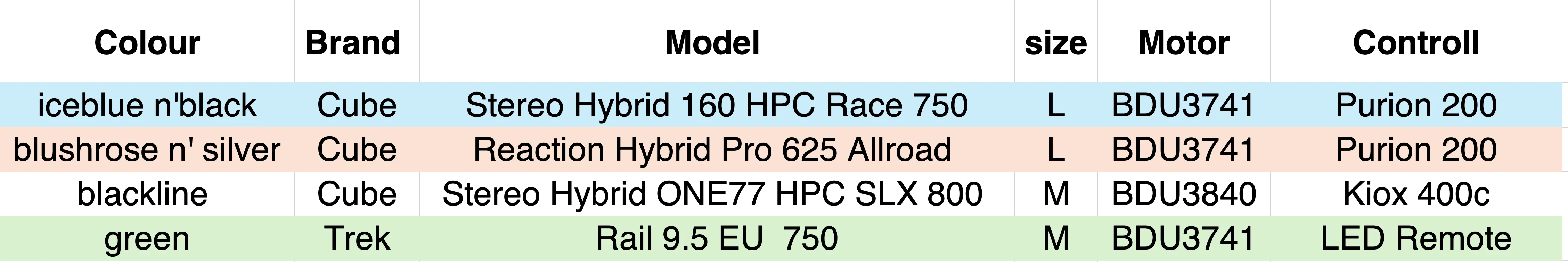

My buddy and I go out with the bikes in the screenshot and sometimes bring along friends. The only bike on Gen 5 is the Cube 177 the extra bit of Battery has not helped to increase the range compared to the others on Gen4. We easy make a 40-50 km spin on any of the bikes with speeds averaging around 16-18Km/h . Normally come home with almost identical battery % remaining.
The gen 5 extra bit of power does help on the more technical stuff but I believe that's where it just sucks out more battery.
The pink bike with 625 battery is hard tail and smooth 29s front and back, hence it rolls efficiently but also slips away easily :ROFLMAO::ROFLMAO:
