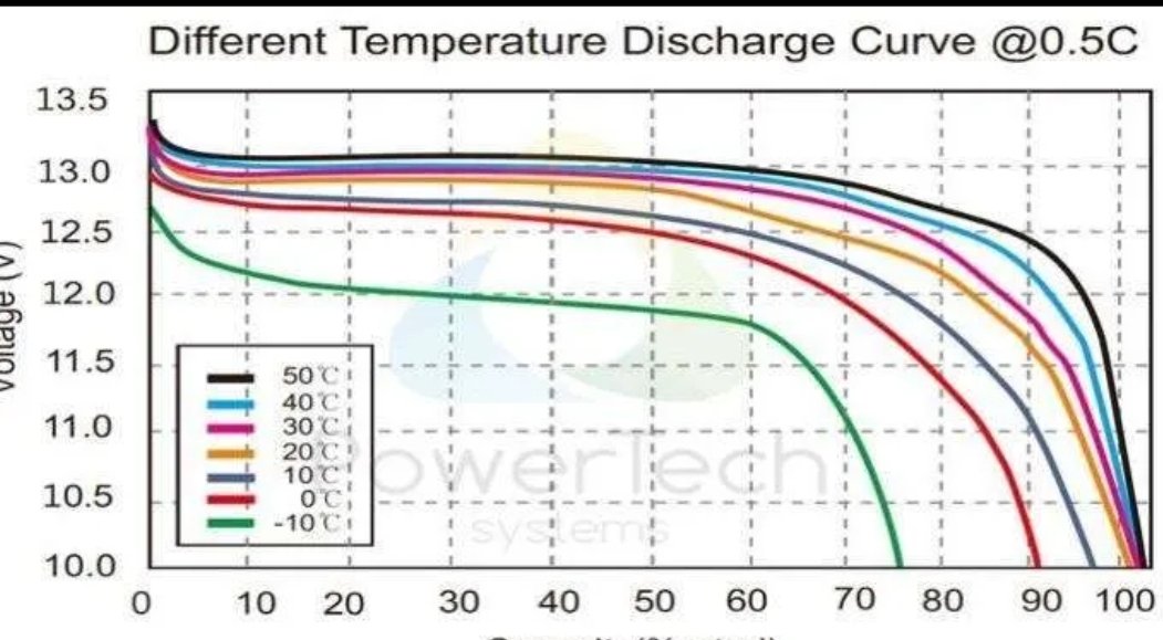

Gen4 and Gen5 are using different battery cells, Gen2 18650, Gen3 21700. I have been involved in developing battery packs for low temperatures ranging from -40 C to 0 C. Different cell technologies can have very different low temperature performance even if they have the same capacity at +25 C. 21700 cells typically have lower internal resistance than 18650 cells. With the same current draw 18650 will have larger internal heating due to the current drawn, this will increase the usable capacity at low temperatures. So both the cell technology and cell size will influence the performance in cold weather.
That's very interesting info. But if the 18650 cells get hotter - and thereby have more usable capacity - with the same current draw, doesn't this represent power lost to heating rather than going into the motor? If so. then to achieve the same motor power with both cell types you would need to draw more current with the 18650s. This would effectively negate any capacity advantage?
I was checking i have bosch gen 4 non smart. What about bluetooth? Its possi
That's very interesting info. But if the 18650 cells get hotter - and thereby have more usable capacity - with the same current draw, doesn't this represent power lost to heating rather than going into the motor?sry
Sry i was checking have bosch gen 4 non smart.. Its 2021 bike.
Gen4 Smart and non smart are both using 18650 cells.
This is an example of usable capacity at different temperatures. When the cell is self heating in low temperatures the usable capacity will increase.

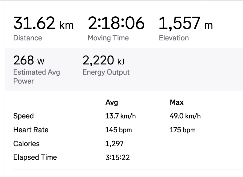

Here are the stats for my Mondraker Crafty. I'm 85 kgs geared up . For this ride I've used 78% out of the 800wh battery so that would be around 630w. I've rode around 30% in Boost, 70% in Emtb.
That made me buy a 600wh Spare battery as for 90% rides that would be sufficient, and the bike should feel better at 22.7 kg with pedals.
In conclusion, the 800Wh is MORE than enough. Not sure though how that will feel with the future update but for now it's really good.
