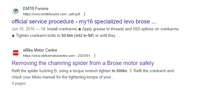

FWIW - TQ 50 NM, Brose 50 NM and Shimano 35 to 45 nm is the lockring torque spec for essentially the same part on a very comparable ebike motor ie. use scenario- so it is likely the Bosch outsource manufacture just got it wrong when they thought 25 to 30 nm would work given the amount of lockring issues that have been reported for Bosch bikes vs. almost none I have heard of for Shimano or Brose.
Unfortunately bike manufactures (unlike airplanes and cars) don't seem to take this stuff seriously enough to recall/throwaway parts so they have a habit of just keeping the old stuff in inventory even though it may have a improper label. TQ is doing this as well apparently - from Fuel EX thread " Torque should be 50Nm. Some older lockrings were stamped with 30Nm, but they can come loose. Mine did, 50Nm solved it."

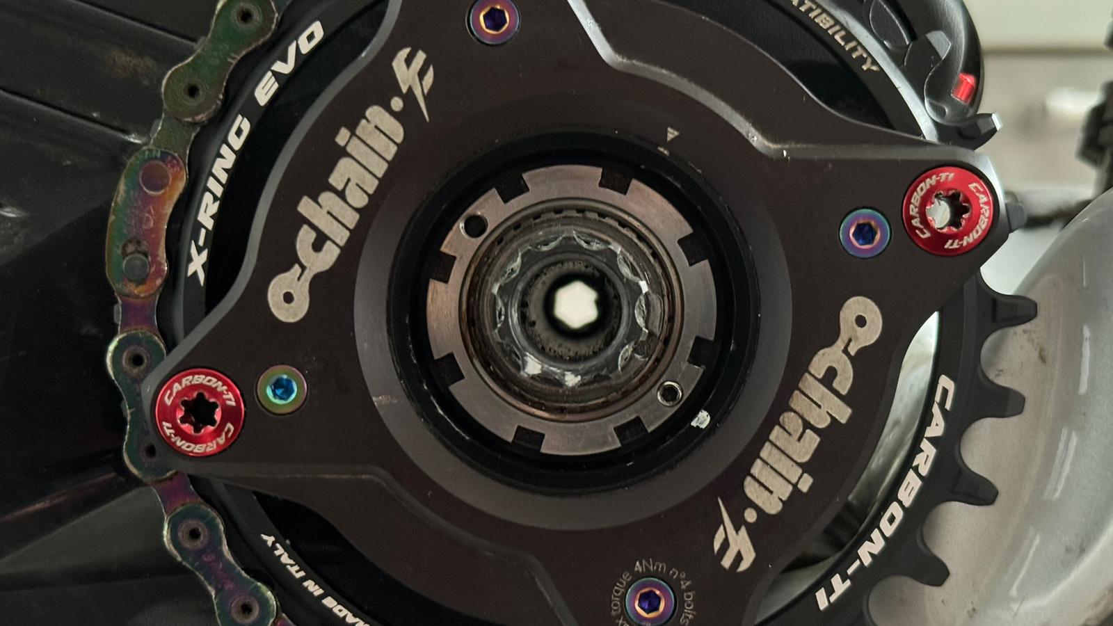

Hi everyone,
this is the fourth time the lockring has been coming loose.
In order I tried:
Used lockring new o-ring with grease 30Nm
Used lockring new o-ring with Loctite 30Nm
New lockring new o-ring with grease 30Nm

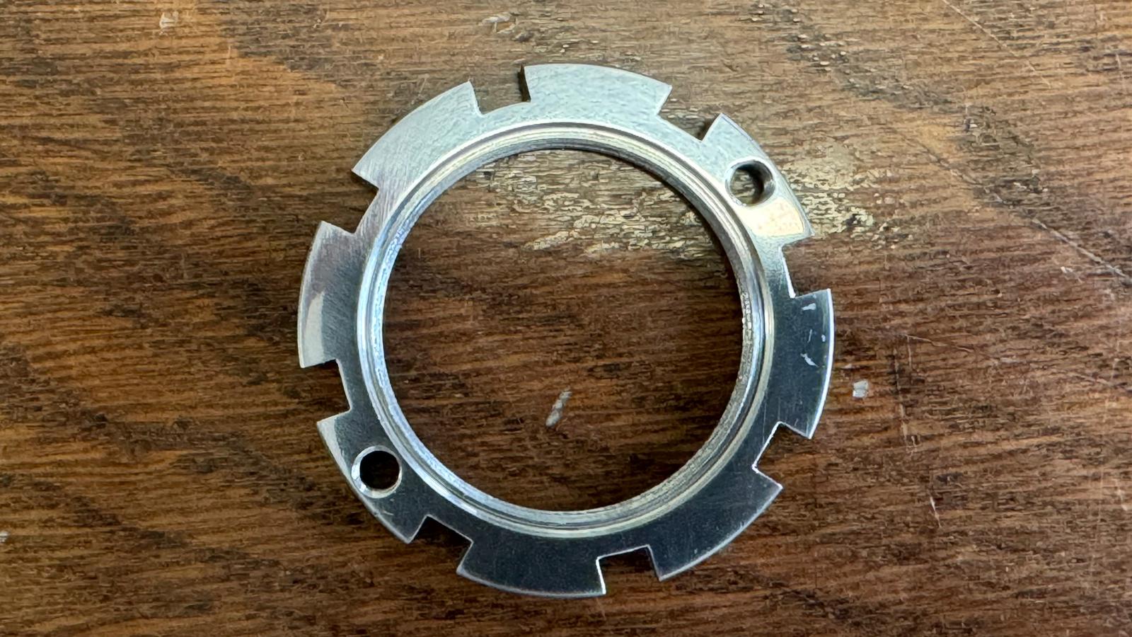

Steel lockring (selfmade on leathe) new o-ring with grease 30Nm
I have a torque wrench that works in both directions, so I'm sure about the tightening torques.
I'll try tightening the lockring to 45nm, in the worst case, if it doesn't hold, I'll have to throw the lockring away.

It's a nut on an ebike. Nothing is fit and forget. Just keep an eye on it as over tightening Wil only stretch it.
It also won't need any grease as the O ring will deform too easily instead of just squashing.
Don't use the O ring, you don't need it and I think this is the main reason it comes loose.
I've been running 3 different bikes over 4 years without the O ring never any problems and never come loose.

there is no need for grease on such a short amount of thread...........just make sure the thread is clean. At the end of the day if the lockring keeps coming loose I would guess the chain ring rather than the lockring is the problem.

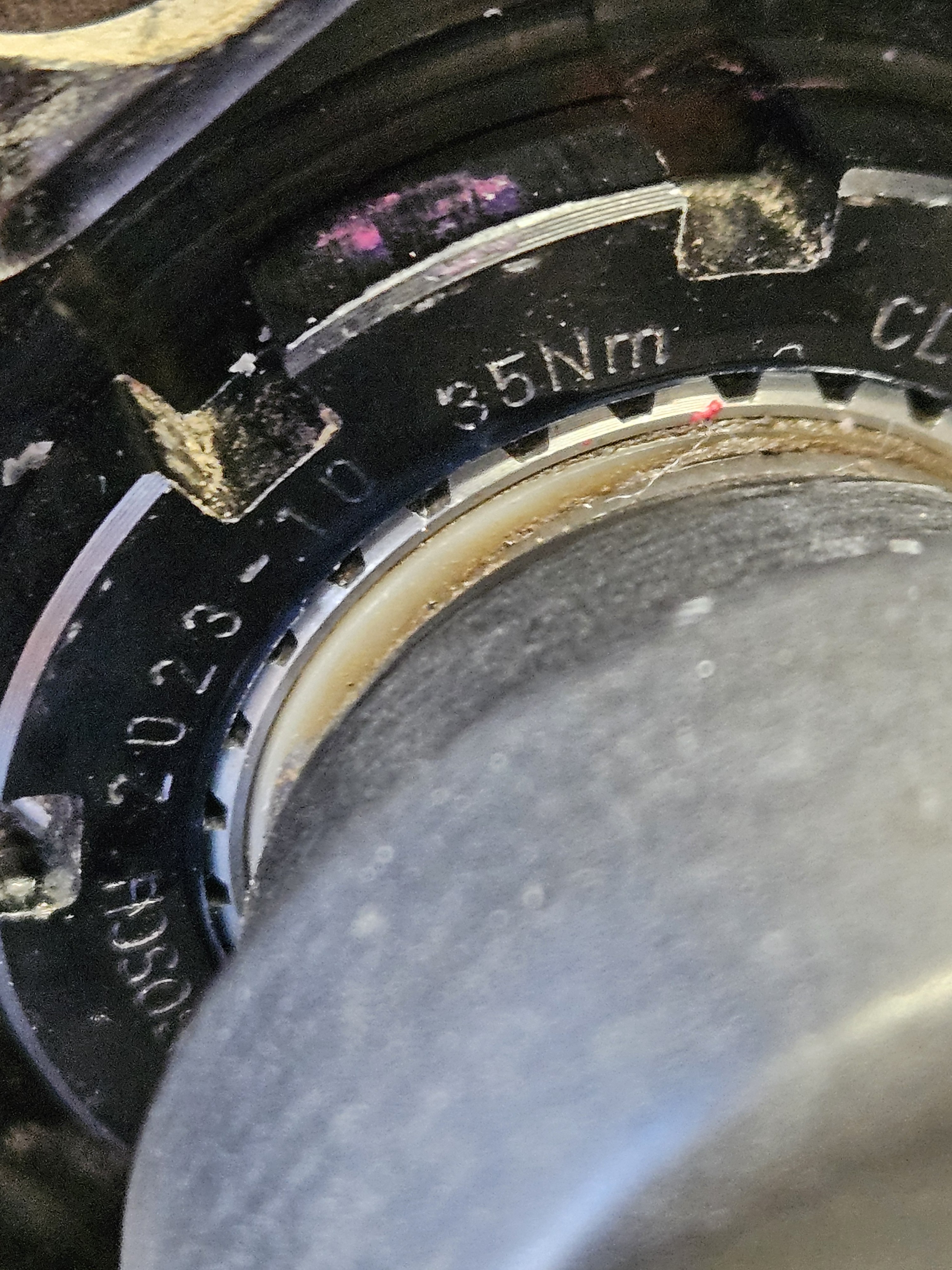

Guess what the new Bosch lockring that I just bought and installed says on it? 35 nm
Edit:

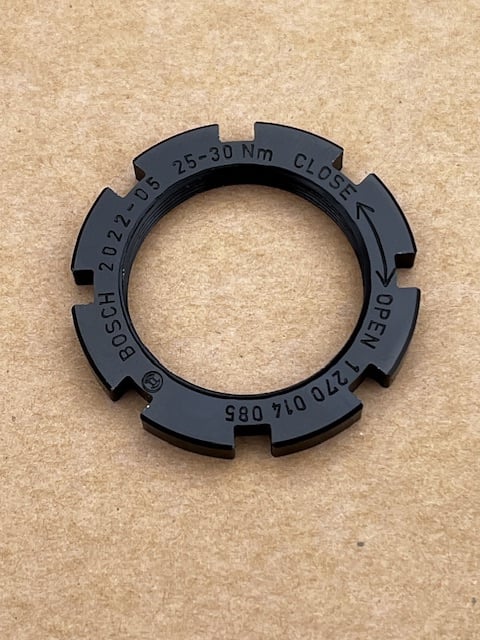

Lockrings dated 11-2018 said 25-30nm
This lockring dated 10-2023 says 35nm
As before used blue thread locker (Loctite 243) and no O ring but tightened to 35nm instead of 30nm, and again put a telltale on it which previously told me it was coming loose.

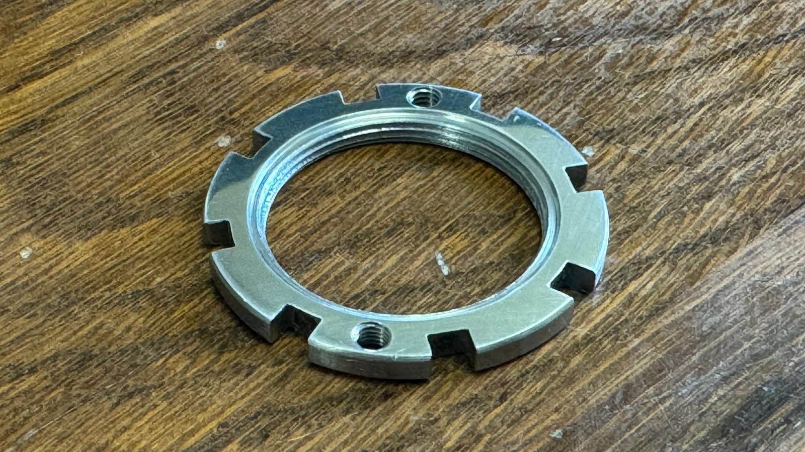

I just drilled between castellations and fitted a roll pin - sorted.

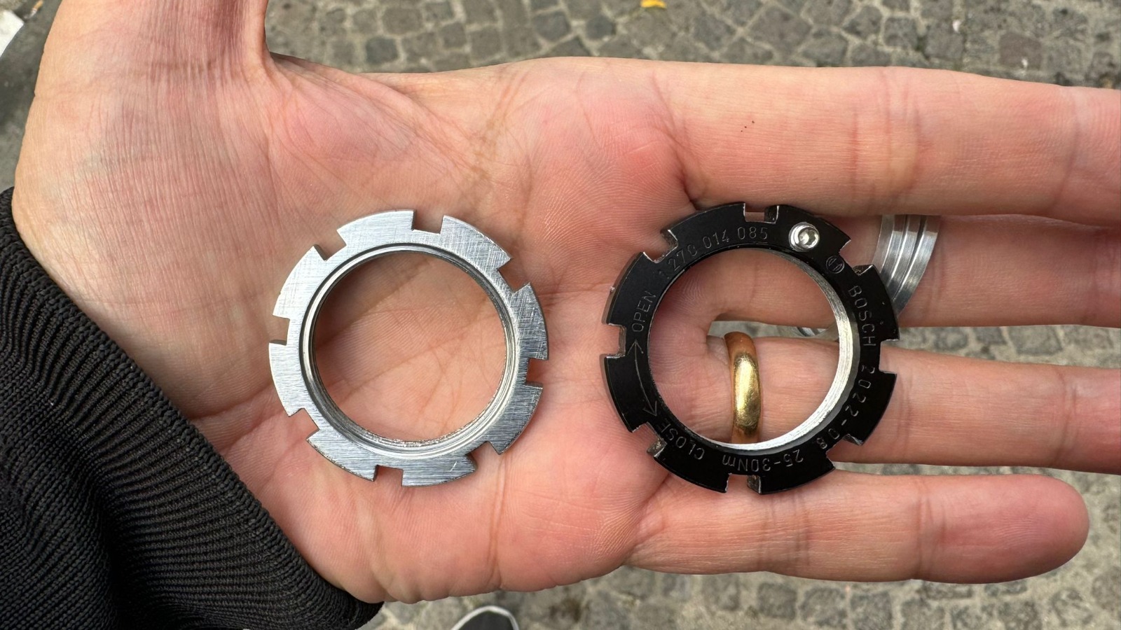

Interestingly (or not!) I was looking for a CX gen4 locknut.
Mine has a 25-30Nm printed on it.
I found a Bosch Cargo locknut, which looked the same but had 35Nm printed in it.
Maybe a different nut or made from a different material ? Needs a lot more torque to shift those boxes.
I suspect the difference is the material used....different grades of ally. Given the very small number of threads I would not exceed 25nm and I would avoid re-use .
Yes agreed but does anyone know if the Cargo nut is the same thread.
If so it maybe an upgrade option as the queries in this thread!
