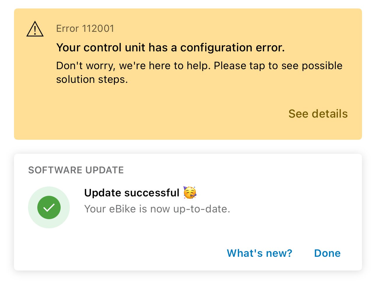

Warning / Update:
Some users report Error Code 112001 after updating hardware.

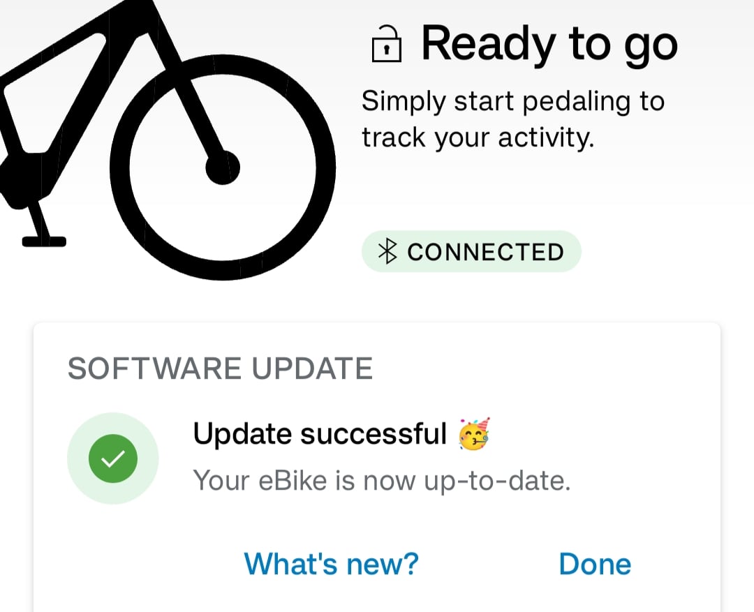

Some guys can't change the oil in their Toyota.
I just updated mine, and of course it worked out perfectly.

Agree to certain extent. The error occured also in previous updates on bikes on that parts of the hardware had been changed, e.g. controller or display. Now it is not yet clear if failure due to interrupted update process etc..
However, seems that in case of this error you have to go to see the dealer to fix software settings on linked hardware as you can not do yourself via app or „pushing the buttons“.
Would be nice if such fix could be done by Bosch OTA.
I just did give the warning as in the past there had been issues for the Treks(? Speed Sensor ?) that some would have preferred to avoid. 😉
I will wait with the update as there is no hurry for me.
Error 112001 was solved quickly:
„Dealer once connected the bike and redid the update. My bike was completely removed from the Flowapp and now it's running again.“

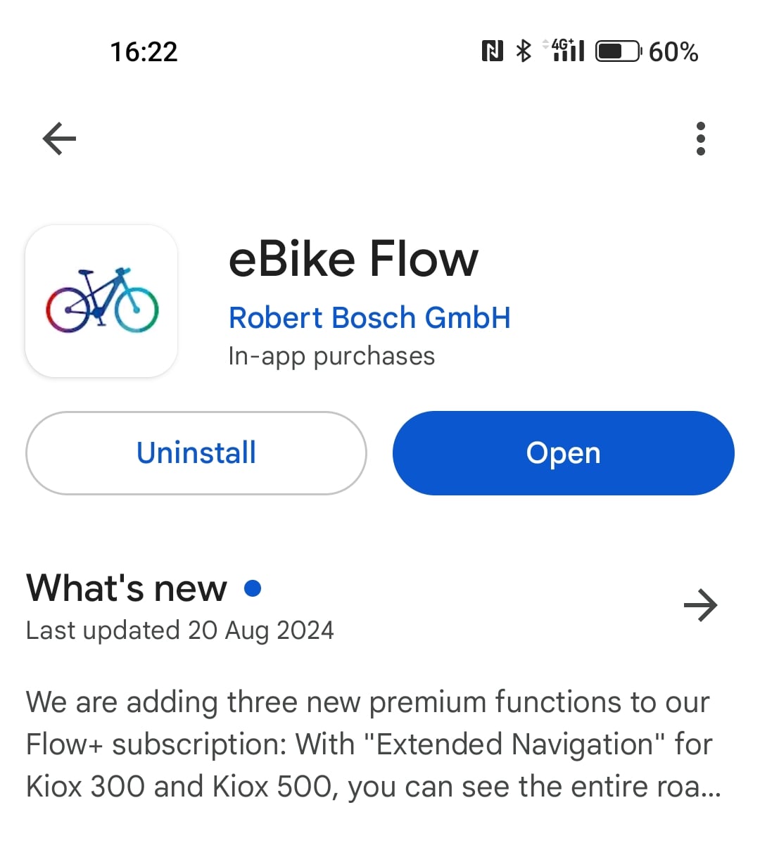

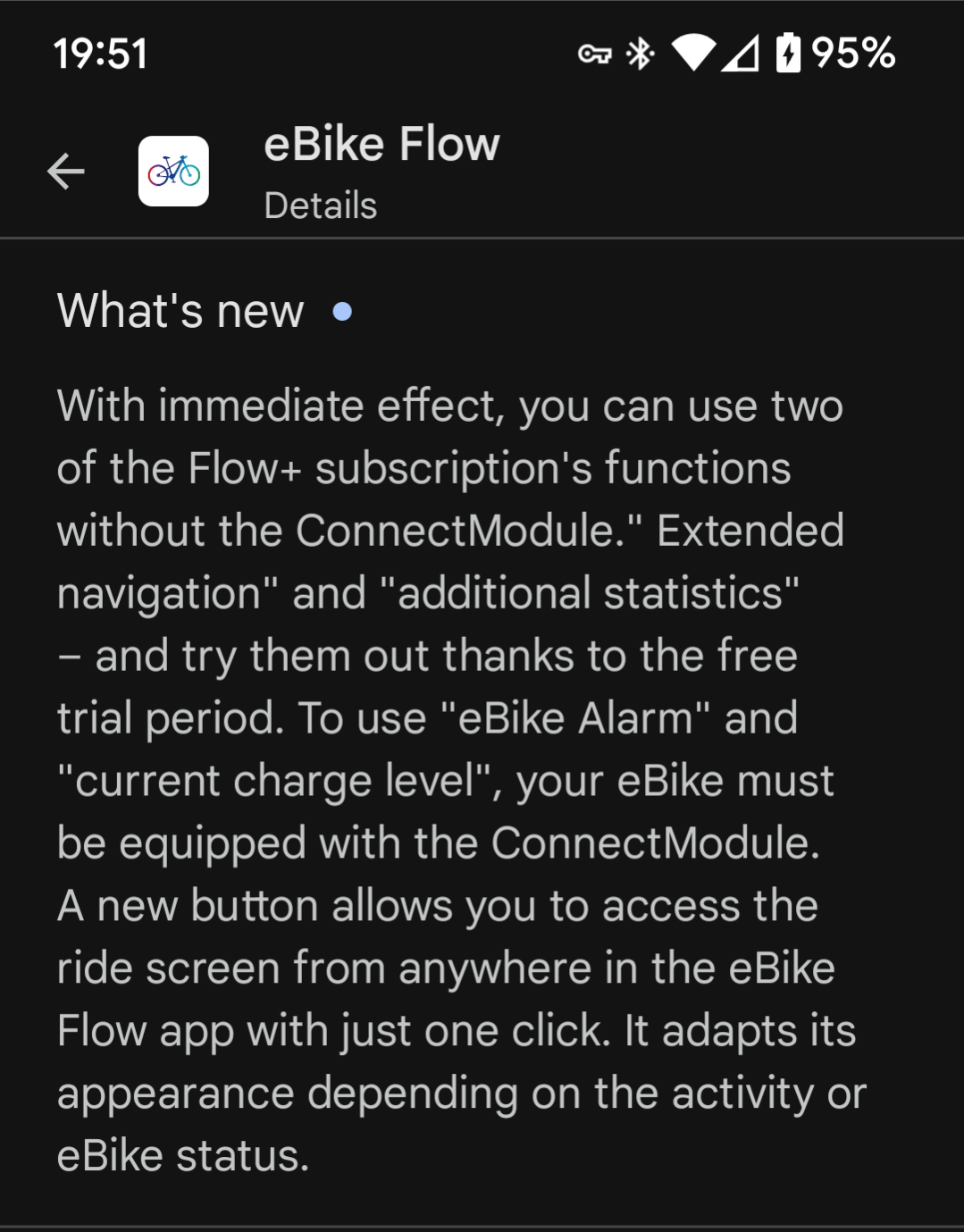

Does anyone know when the update will be released for Android?
My Pixel had the update of the app to v1.24.6 in the app store this afternoon.
An error might occur if hardware Controller was replaced or added and if not followed Bosch recommendations:
„Can I retrofit Purion 200?​
If your eBike with the smart system is currently equipped with an LED Remote, then the subsequent change to Purion 200 is possible. Purion 200 then replaces the LED Remote, as there can only ever be one control centre on your eBike. If you would like to have the conversion carried out, please talk to your specialist dealer in advance: Only they can carry out the replacement because the new control unit also needs to be assigned to your eBike on the software side.
Is your eBike with the smart system currently equipped with a System Controller? Due to the permanent integration in the top tube of your eBike, conversion to different control centre, located in Purion 200, for example, is not intended.“
Yup, I got the error. My controller has been changed from the led to lcd 200. To the dealer it goes then.
