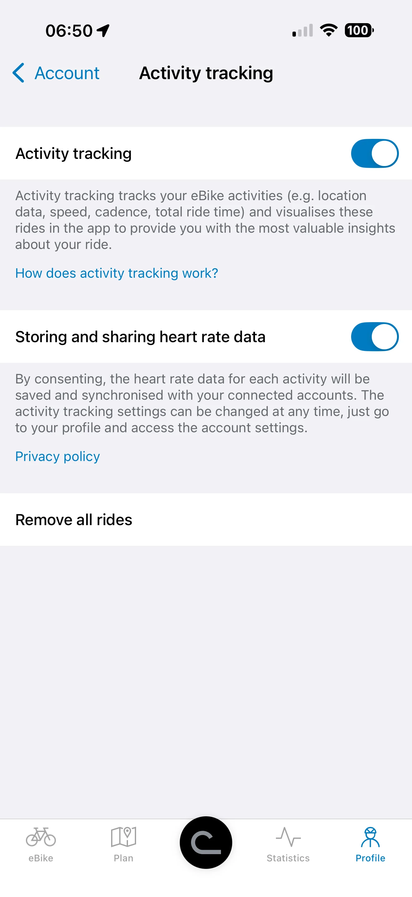

@trekRailIRL Since the update I recorded my ride in Flow now its recording HR data and then exported it as a FIT file and manually uploaded to Strava and Garmin to prove that the data was being stored correctly.
Now that I know it can do this I'm gonna turn on my Garmin connection to Strava to see how well importing the file to Connect will show when it syncs across. What I would like is for Flow to connect to Garmin or ultimatly Bosch open up the data directly to Garmin so I dont have to rely on Flow app
The HR recording is not working quite as advertised though. I’ve not exported my last ride but the video Bosch did for the 1.34 update showed a 5th tab for HR analysis post ride. However I still only see the 4 tabs, elevation, speed, cadence and power. The 5the tabs for HR is not available in the flow app. Will export the fit file and see what that shows.
Edit: exported the fit file and no HR data is present. The flow app was running on my Apple Watch displaying HR during the activity and the HR icon in the settings screen on the kiox had a tick.

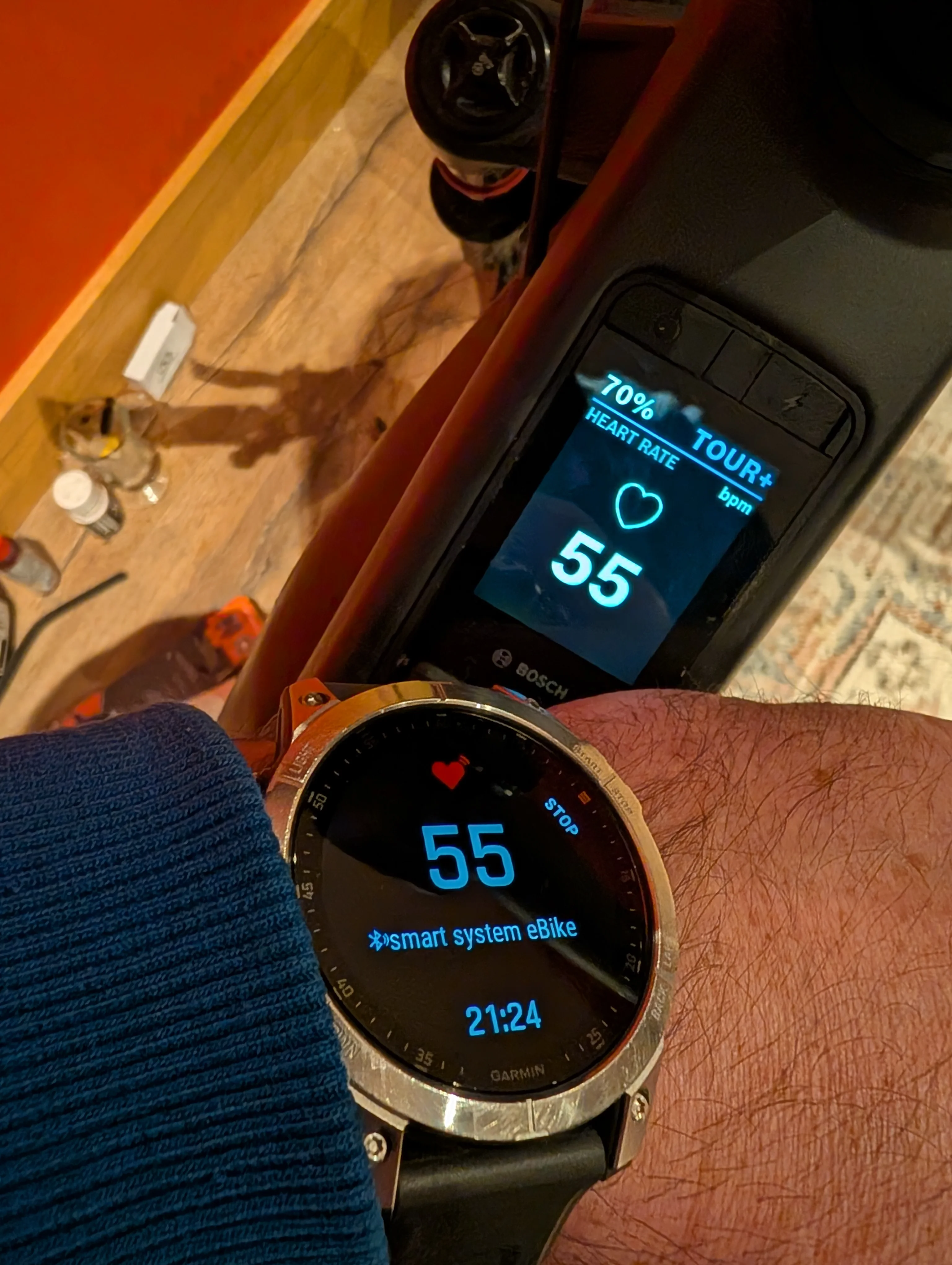

Also can confirm that a Fenix 8 broadcasting HR is picked up by the Flow app as well.
I'll answer my own question, shared here in case anyone else is curious: Yes, the new tricks feature does function/record without a display. Clearly, one won't see individual tricks but the summary will appear in the Flow app (whether the metrics are believable or not...).

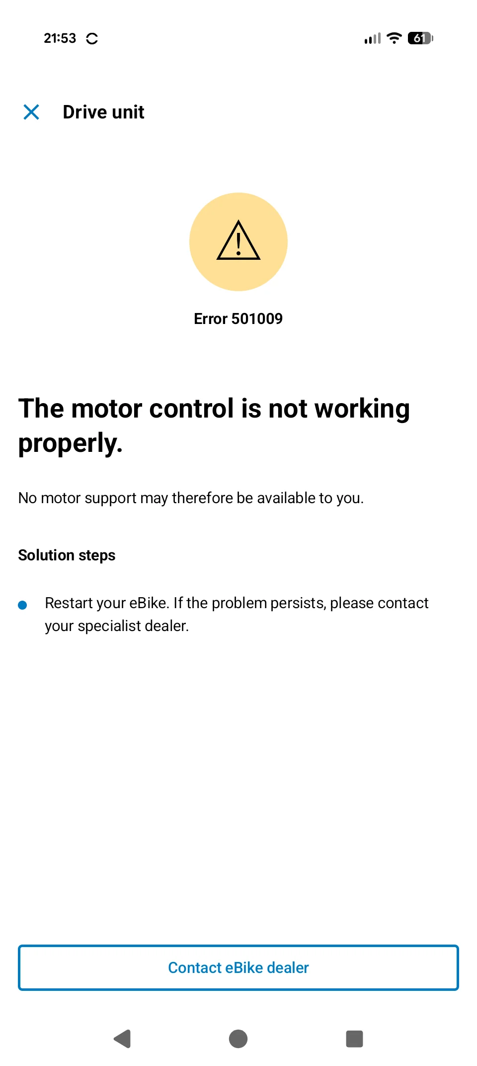

Got this error tonight on first ride with new software....
Seems to have since cleared.
Not sure if coincidence

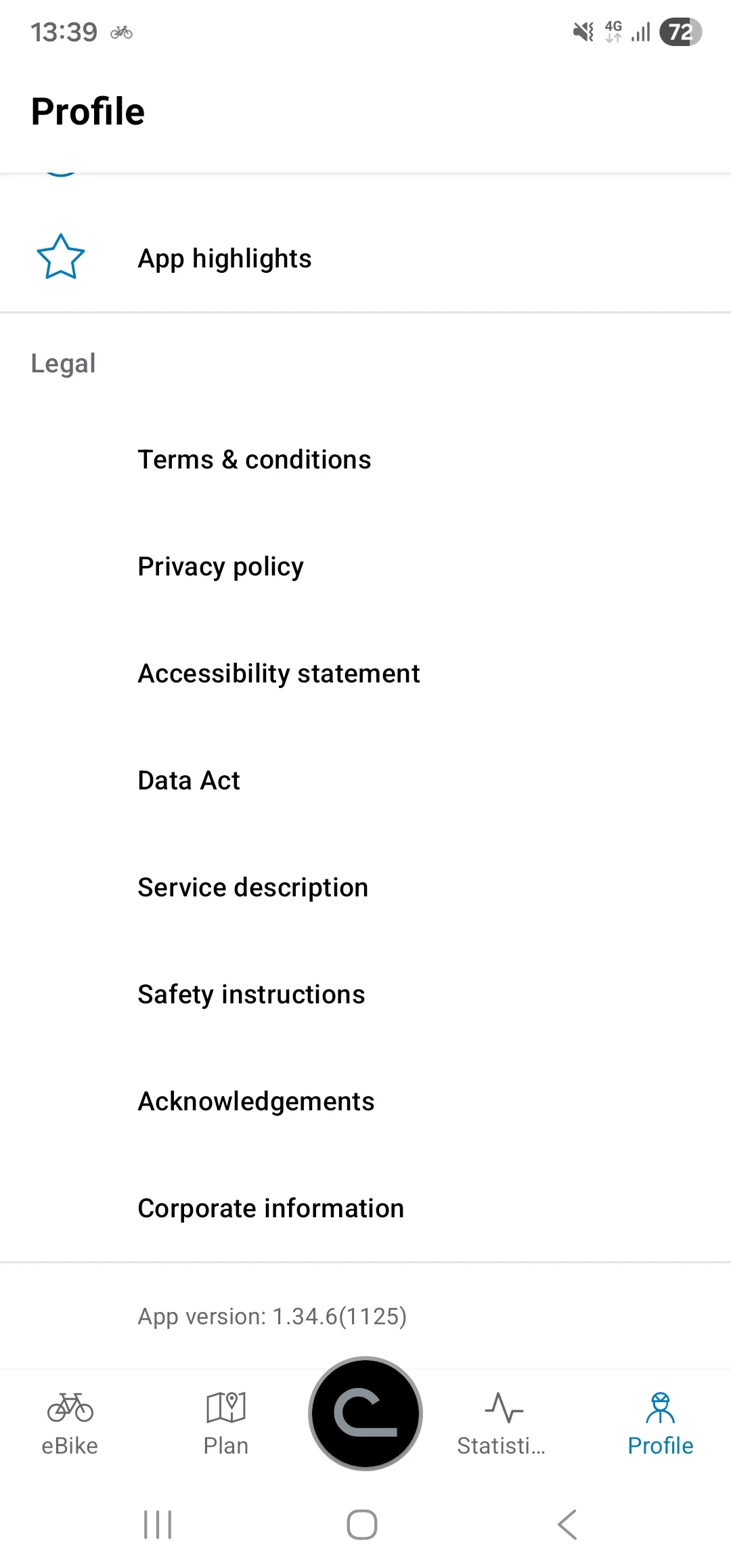

You need to ensure that you have the updated firmware along with the Flow app 1.34. From there, just record your ride with the Flow app and at the end of your ride, scroll to the bottom and you should see the summary.
I've ridden 2 rides and see the summary.
I have the latest update on the bike and app 1.34.6.
I see no such summary, but I haven't done any tricks either. Is the summary there regardless of tricks / no tricks?
