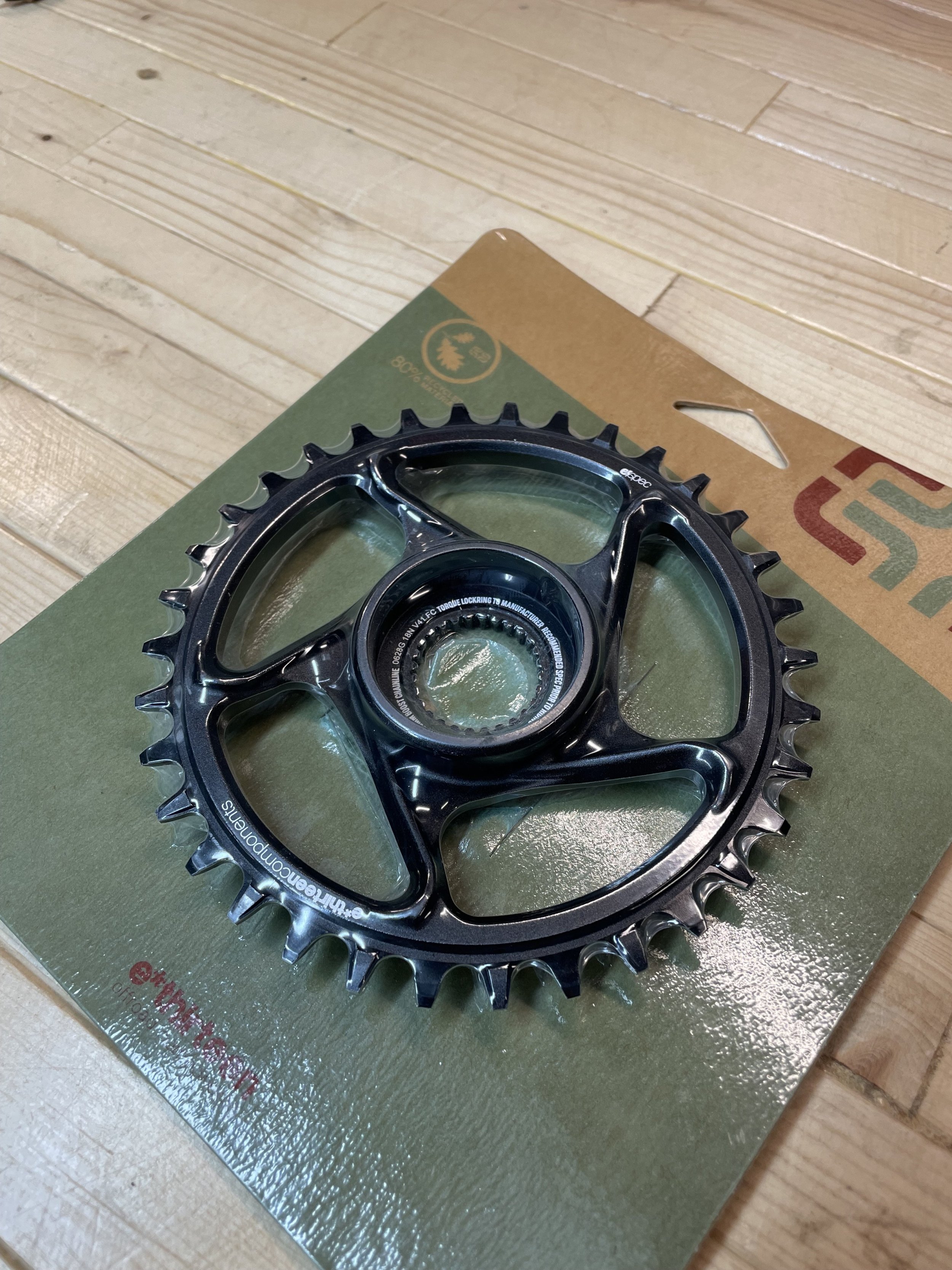

I changed the original 34t chainring because of chain-suck. The new 34t ethirteen chainring didn’t fit exactly right and I noticed that the profile was slightly different. I installed it with the rubber “o” ring, thin plastic “o” ring, and the aluminum “o” ring. When I torqued the castle nut, to spec, the chainring protruded further out thus affecting the correct chain alignment.
What I eventually found was that the aluminum “o” ring was not necessary with this type of chainring. (No instructions). This spacer was integrated into the chainring body. But the thin plastic “o” ring became absolutely necessary.
What I learnt was that exact chainring profiles are critical. Also that the threads on the crankshaft are not compromised. (Accidentally cross threaded counter clockwise). A very small amount of blue lock-tite was used on the castle nut.
The ethirteen chainring works for my 2020 Gen4 CX motor. I currently have my third chainring on but I have experienced loosening of the castle nut once. Never since I added blue loc-tite , and correct torque, to the castle nut.

It shows how critical the position of this nut can be. When I installed the ethirteen chainring I had to remove the aluminum “o” ring when I discovered that it was “built into” this model (see pic) of the ethirteen chaining.

I’m not sure how other chainrings are designed or engineered but the ethirteen alloy chainring, that I use, seems to be beefier around the spider nut. This may reduce some of the flex that you describe.
The added torque and flex, from an eMTB, at the spider nut might cause a slow and minute loosen of the spider nut.
Like I said, only once has the spider nut come loose. (10K+ kms ?)

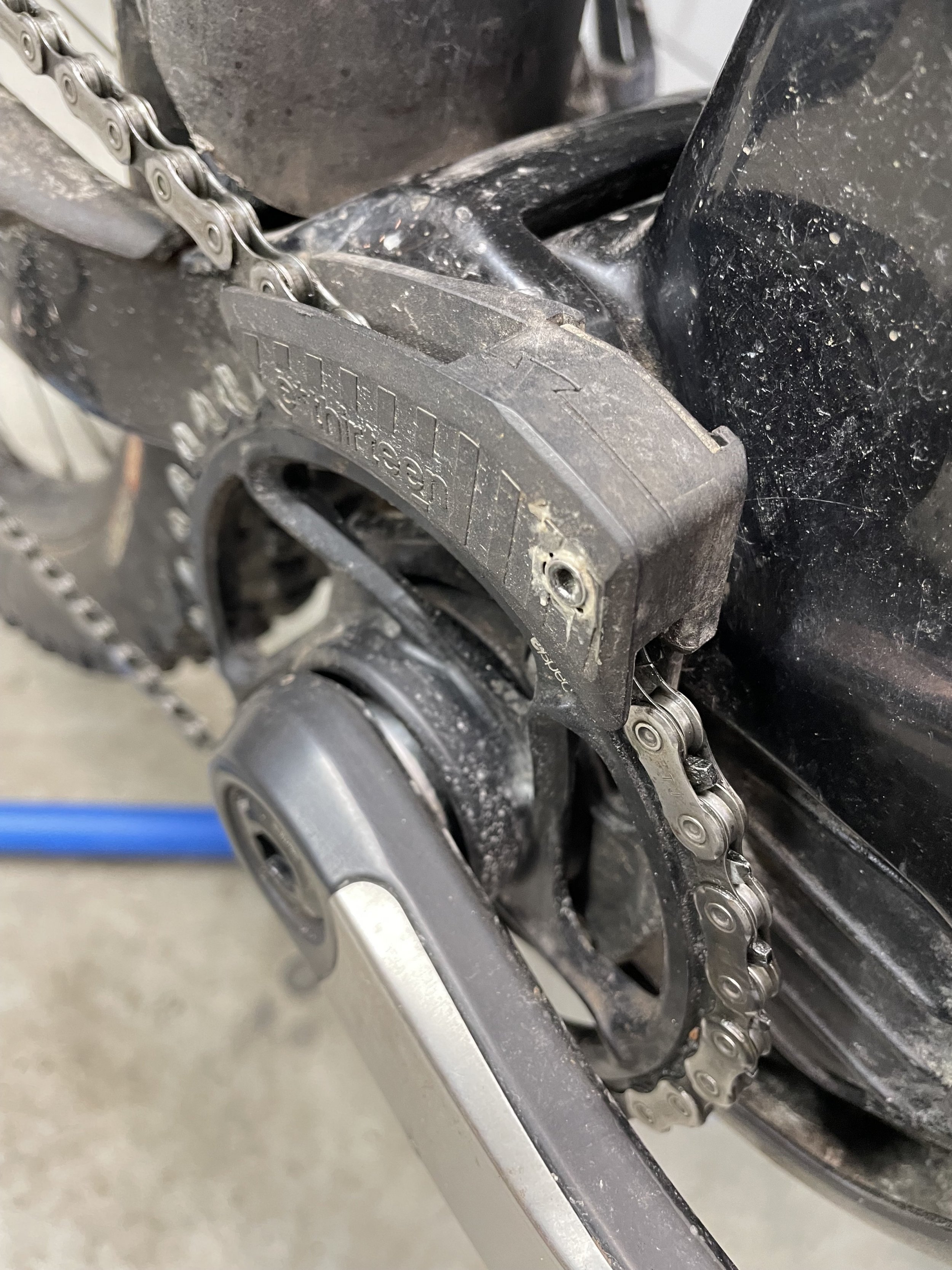

Trek Rail 2023: I had my chainring eat through the chainstay. Not really a good design, the clearance is too tight. I got a new chainstay on warranty from trek. While assembling the bike back together, I am changing from a 36T chainring to a 34T chainring. See the difference in these images.
