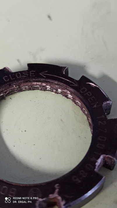

Hi guys, sorry for my absence
I come with some (sad) update
Probably due to the very severe use (I'm coming, without any false modesty, pretty faster in enduro trails), the nut has come totally loosen despite of the safety wire lock.
The fault is totally mine because I did not check it for many rides, so that the nut has come totally loosen until the threads got totally DESTROYED. Movements and vibrationshave been huge, surely.
That's the result: the thread totally gone :eek:o_O
Then, I probably need something more efficient

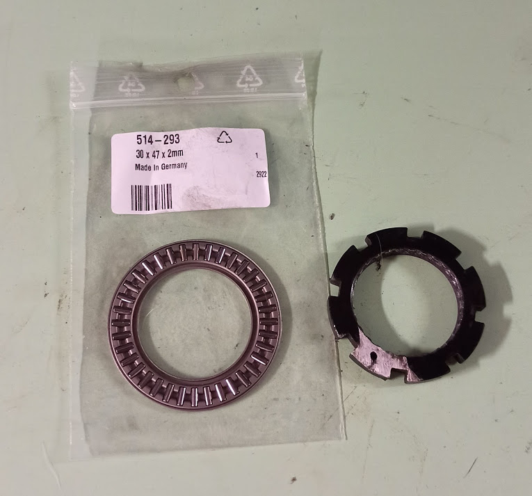

I decided to make an experiment, and I want to share it with you.
I decided to "package" the nut (I bought a brand new spare, of course) with the crank itself by using some shims, so that the crank will keep the nut in position and will ensure it to not come undone.
Obviously, the crank cannot compress directly the nut, 'cause otherwise it couldn't rotate backward (chainring and crank must be independent) so I put a thrust bearing in between. In this way I physically pack the nut by the crank, but at the same time I can keep the crank and the chainring independent and disconnected.
Obviously (2) I did NOT pack the nut by compressing it with the crank: the shim pack is designed to have a thickness very slightly less than the room between nut and crank; in this way I just pack it without any compression force
IT WORKS !!
I tested in 3 very hard rides, so far, and the chainring keeps stable and smooth. Moreover, the crank action sound much smoother (probably because of the tight connection, that prevents any creaking or crunch)
In this way, the only thing I must check is the crank bolt tightening, because that's what packs all the system.
I perfectly understand that it could sound bizzarre and unusual.

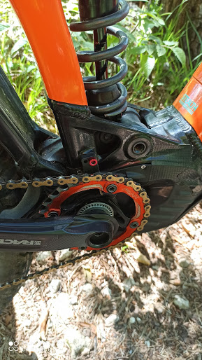

I've been keeping an eye on this thread, and until today mine has been fine.
However, cleaning and lubing the chain today I found the chain ring loose and after pulling off the crank arm the locknut had come undone. Fortunately there is no damage to it as it was only a couple of turns, but must have been like it for a while and I've not noticed.
Mine is a 2020 Cube stereo 160 AT, with a 36T Alloy E-Thirteen direct mount chain ring.
I've seen an O ring mentioned but there wasn't one on mine.
My biggest headache was that I'm going out on it tomorrow and didn't have the proper tool to tighten it up.
A drift is difficult to get in as the lockring sits a lot further in to the ring than those pictured earlier in this thread.
I've ended up modifying an old school pin tool and blue threadlock to do the job until I can get the proper tool and do it properly.
