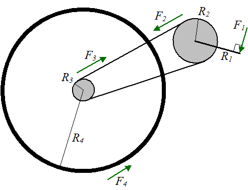

The picture below probably explains it best, F1 is the force applied to the pedal and F2 is the force acting on the chainring, F3 is the force acting on the rear wheel sprocket. This is why the Bosch chainring nut is a left hand thread to tighten counter clockwise, Bosch would have been better to have done away with the locknut and actually have the spider itself left hand threaded to spin on counter clockwise so its always tightening under load.
It conferms my thoughts: Bosche engineers made the best move to design the nut left hand, so that the normal direction of the chainring (clockwise) and the related solicitation could naturally tend to tighten the nut
So, engineers Bosch were right, and that's what I wrote in my post

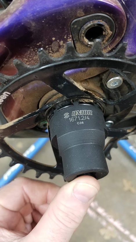

Another thread says the Unior 1671.2/4 tool fits, at £19 not too painful.
Just have to source a replacement chain ring now.

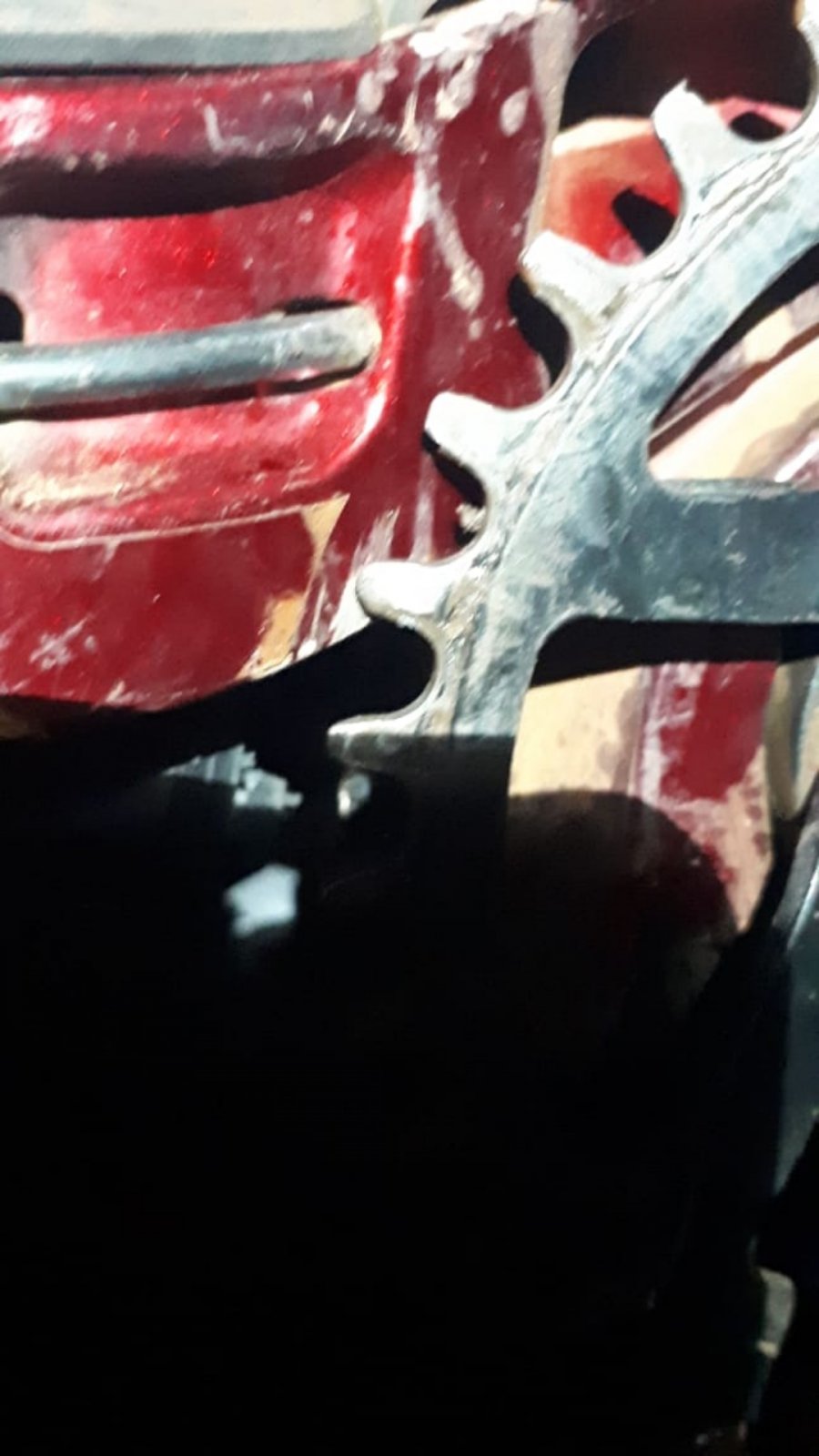

I've never tried a bigger chainring but the clearance is pretty minimal
Thanks for the pic. What size chainring is shown? Doesn't look like much room like you said.
It's a 34 tooth. I wish the motor completely decoupled after the 32 km/h assistance threshold. I don't mind that the assistance cuts out at this speed, but it also resists pedalling beyond this speed, like engine braking (even though it's apparently much better than the gen 3 motor) For this reason I wouldn't bother changing the gearing on the bike, I think there's no point.

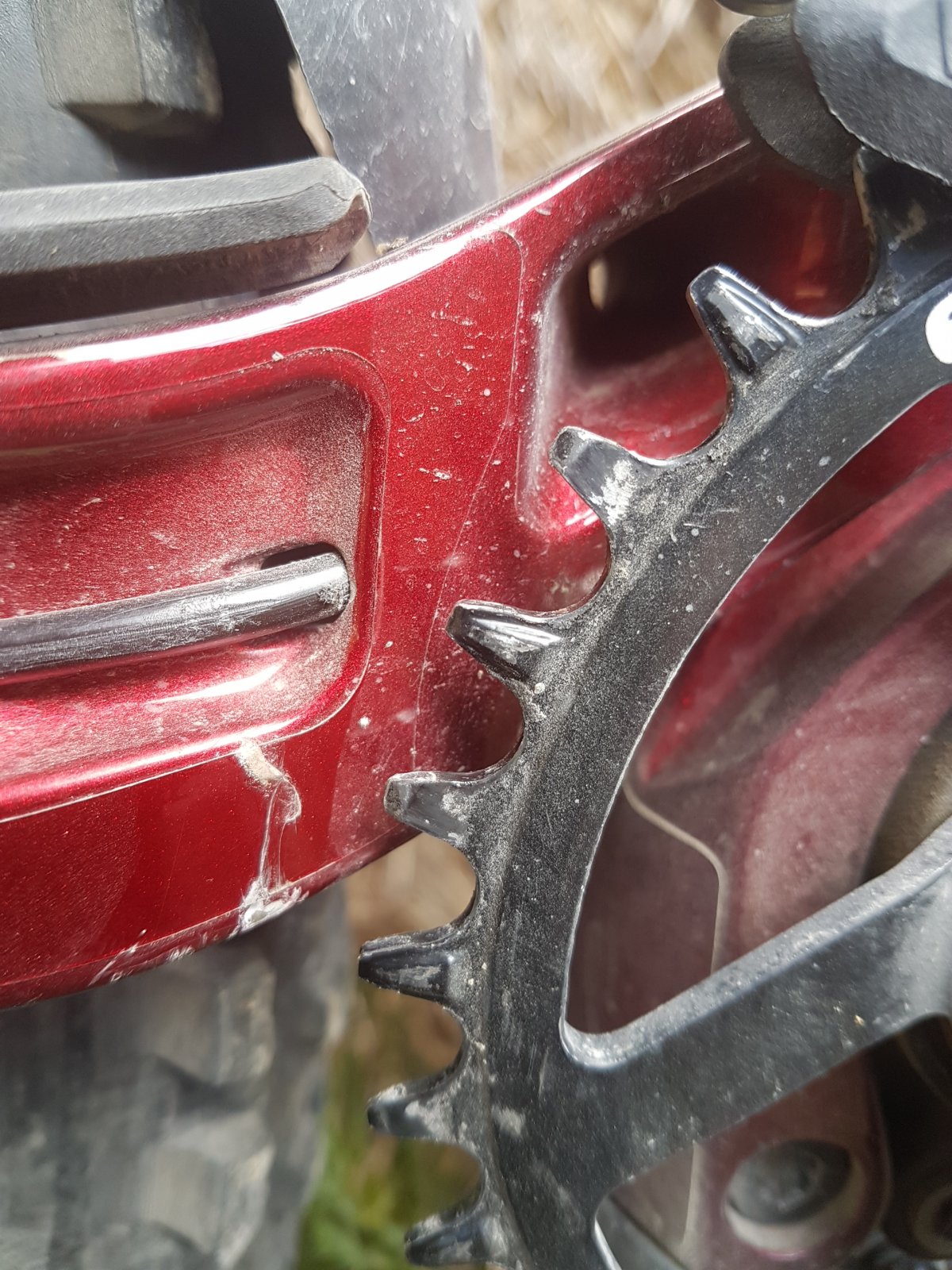

Look how close is the chainring to the chainstay. My is a rail 7 XL and the chainring is damaging de chainstay. Anyone has this problem too? Is there a solution for this? Oring, new chainring with offset?
