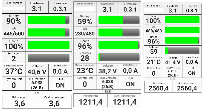

I have the 700Wh battery which I purchased in late 2019. After about 25 cycles it shows 96% Health when fully charged. When fully charged showing 100%, Blevo shows 674 Wh and not 700 Wh which makes sense in Blevo. Mission Control on the other hand shows 100% and 100% for the same situation.

I have own the bike 5 months. Its built 2019 and I had two charge cycles when I bought the bike. At that time health showed 100% with blevo. Bike had been in bikeshop few months in demostration bike and I think they have stored it with battery full.
It think it's best to store it with around 60% charge.
Have you drain battery ever below 10%?
My friend has exactly same bike and health is 99% in his battery.

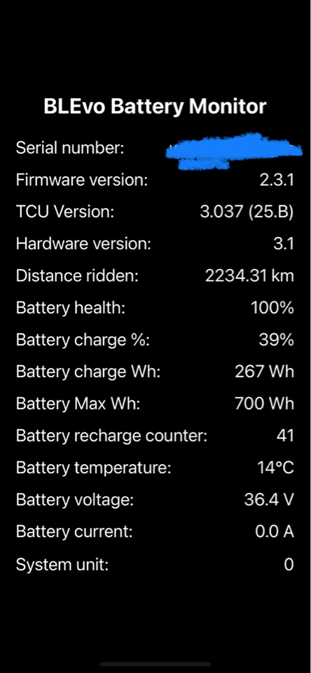

Has anyone checked what is the voltage of battery that has 100% health and it is fully charged? Is it 42V? Mine shows just 41,4V

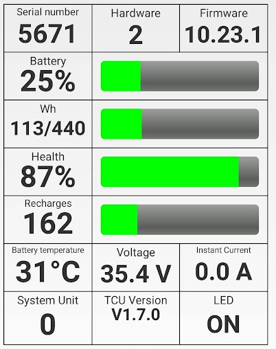

Just to do an update for more data for anyone ..
M1-504 battery (gen1 levo/kenevo).
Dropped to 90% in the first few months of ownership for whatever reason .. then stabilised.
Just under 4 years now :
Does have a relatively easy life as other bikes get ridden.
