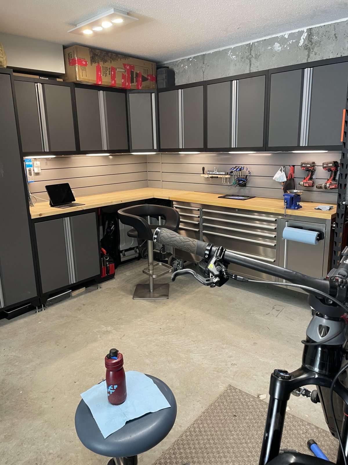

or get absolutely stupid and build a Bike Cave.
This is difficult to hide but I tell her that it’s necessary to repair the dishwasher and other things around the house. Then she does the 🙄 🙄eye roll.

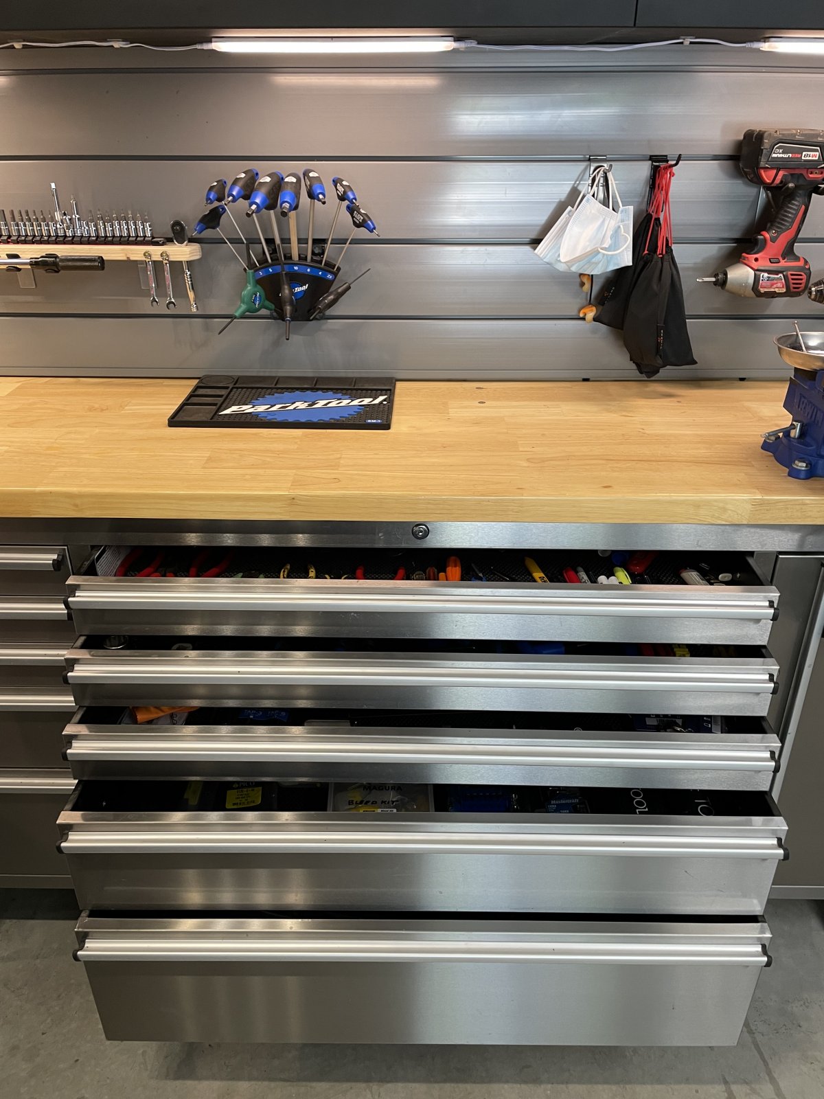

The thing about me - I’m a tool nut. I strongly believe in having the right tool for the job, and nothing feels greater than having an obscure tool on hand for when it’s needed. So I don’t mind stocking up on tools! The feedback has given me a lot to think about!
Already invested in a prs-26 bike stand, so I’m looking to fill some drawers with some bike specific tools.
@Stihldog: that’s a sweet setup!! I have a similar setup minus the cool bikes! I love the Newage cabinets - I’ve got a mix of bold and pro series.

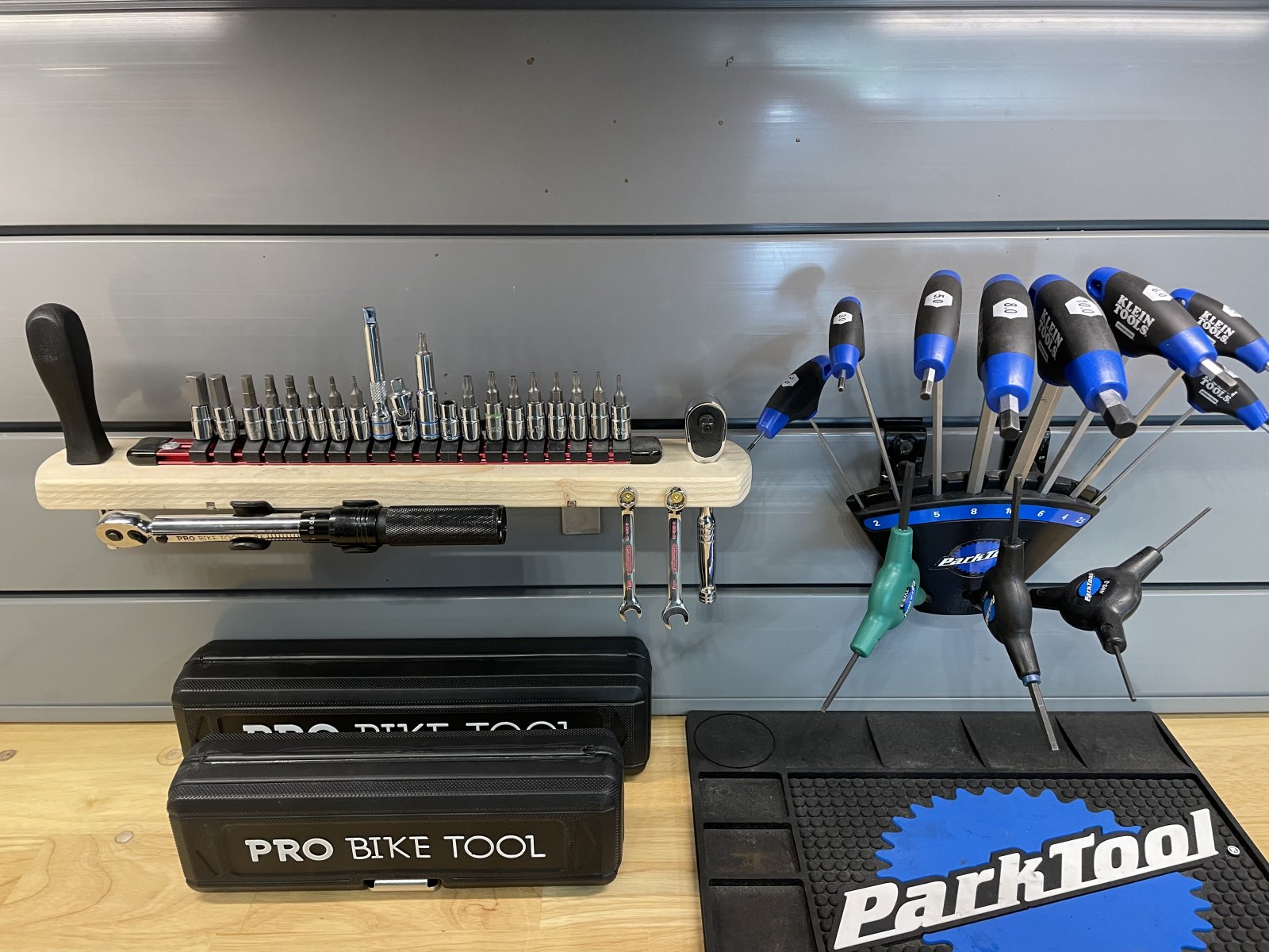

Surely part of the joy of being a tool nut is figuring out the best combination of tools, rather than having to put up with what a vendor decides to package in a set?
Obviously part of this is personal preference, figuring out which tool works for you. For example I far prefer the wera Allen wrench set to the park tool ones, and prefer wera joker, facom 440 or snap on flank drive wrenchs to the park tool ones...but the park tool cable cutter, chain breaker, hammer and 1/4" torque wrench are great.

Whaaaaaat? It is obvious that you have already massively compromised. WTF is a christmas tree (and a fake one at that) doing messing up an otherwise nice workshop.
I agree! A 12” tall fake Xmas tree is fine by me…but now there’s more grandkids on the way and we seem to be ground-zero for this holiday. Looks like I’ll be assembling little mtb’s for awhile and storing a fake 🌲.

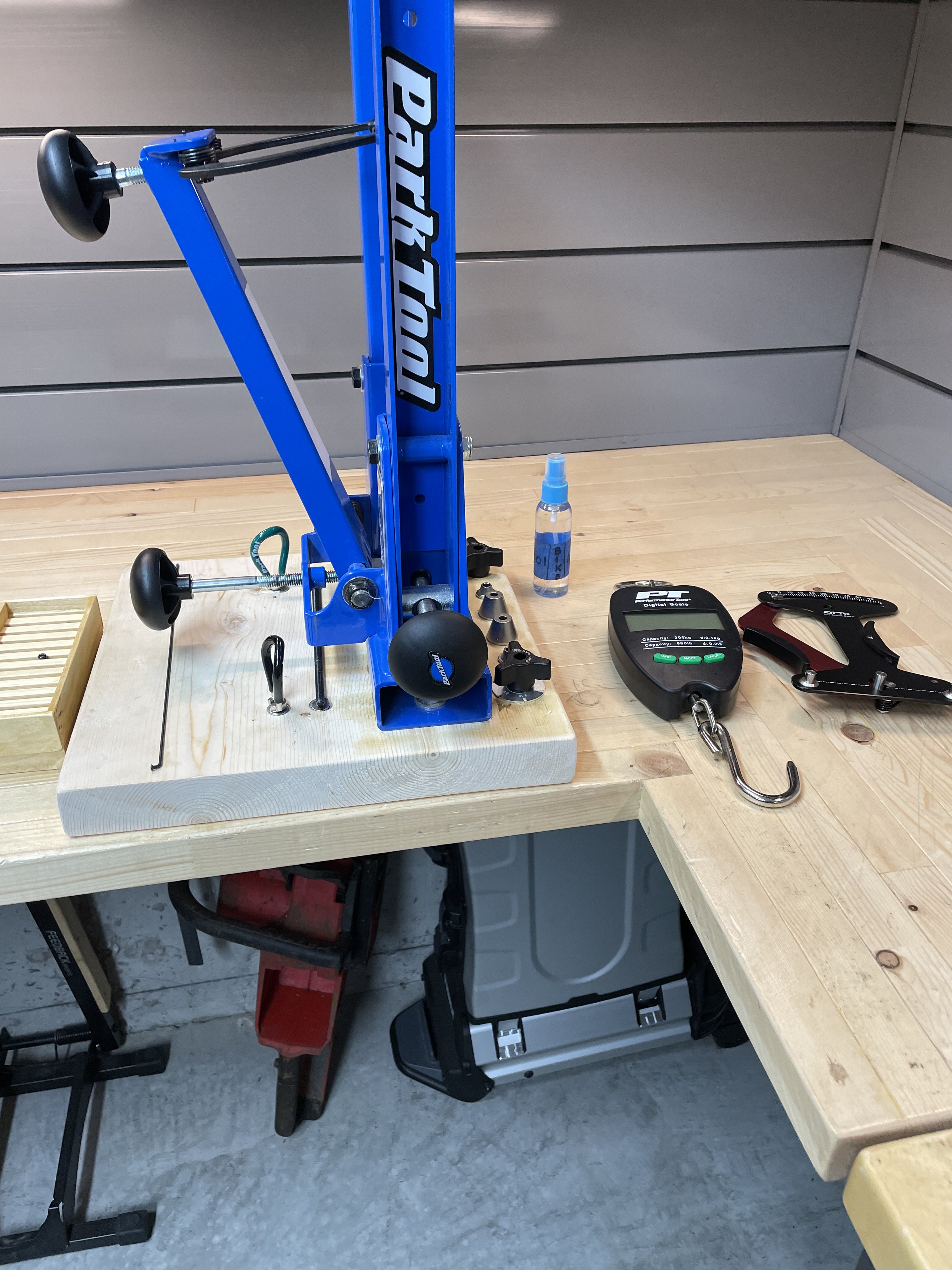

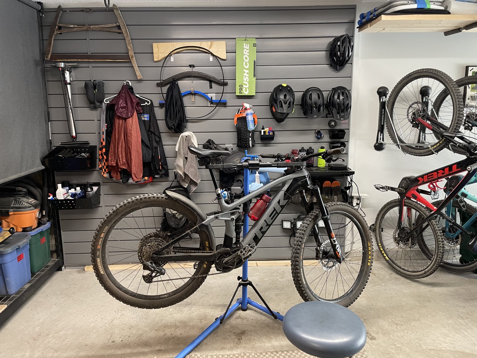

Raining very hard today so I opted to hangout in the bike cave to reorganize some things and service the bikes. I’ve convinced myself that this is a good idea.
I’m slowly acquiring some more bike tools and with that I’ve got to add some skills. It seems as though once you have the tool you better learn how to use it. So lacing and truing it is.
I’ve only laced up one wheel so far but I’ve trued up several. (Can you see my nipple in the pic?😳) I made that box and truing stand base also with some scraps lying around.
My next project is a tension meter calibration tool. Found a digital crane scale but now I need the hardware. (Any ideas?)
Here’s a tool that I thought was absolutely useless. The listed price was rediculous, but then I noticed, on the site that they accidentally dropped the price…I couldn’t hit the buy button fast enough. 1/4 the price until they fixed the error. Too late lol. SOLD!
I use it more than I thought I would.
