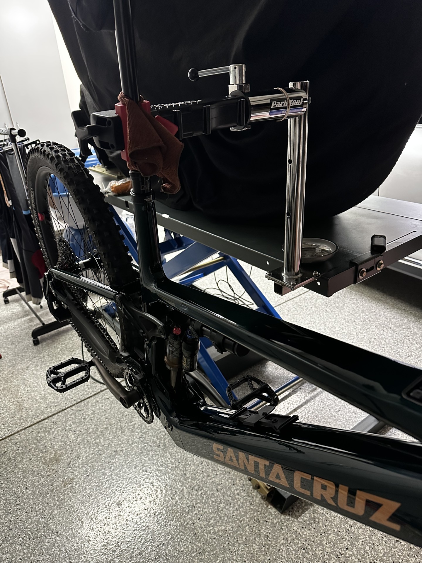

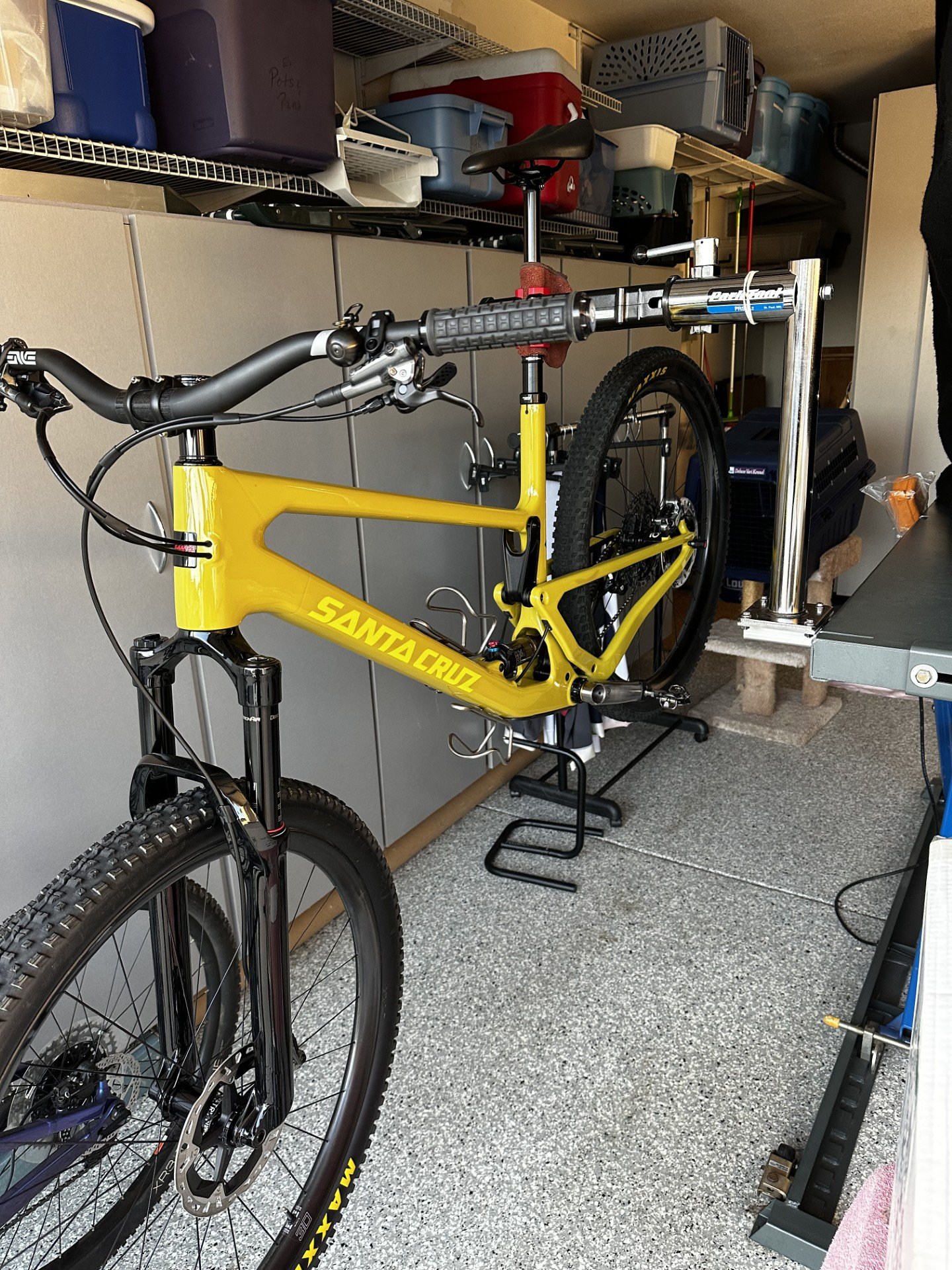

Interesting subject, I had the same thoughts after buying an e-bike. Already had a Feedback stand for my other bikes and struggle to lift the bike up with one hand and close the clamp with the other hand. I considered buying the Feedback powered lift but the expense ($1250) and the space it would take in an already crowded garage made me think hard for other alternatives. I already have a moto lift, so came up with a bike lifting solution using the moto lift. Purchased a Park bench mount stand and a Feedback Park clamp. My moto lift has female square tubing in all the corners. Made a male adapter out of stainless to slide into the moto lift that the Park mount bolted to. Has plenty of height and obviously capacity without taking any more garage space. Only thing to do now is add more garage lighting to cover that space.

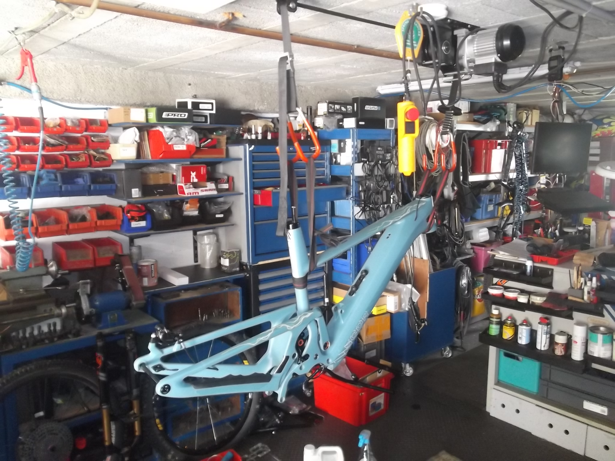

I use one of these, cheap as chips (a tenner in UK) also use it as bike storage, as intended. Easy to lift emtb with battery and easy to work on my bike at any convenient height for the job at hand.
AND Before anybody asks, I use a 60cm climbing sling "loop" around the seatstay bridge and lift from there rather than pull on the dropper post (although I did it that way for years, no problem)
