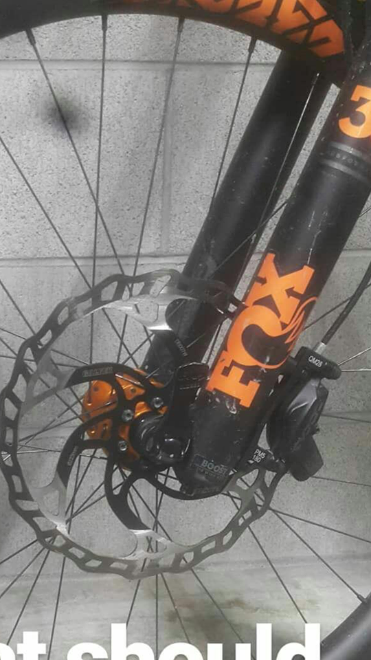

I have been thinking of doing this with my Trance as well. Did you use spacers or an adapter for the calipers?
used an adapter as pictured.

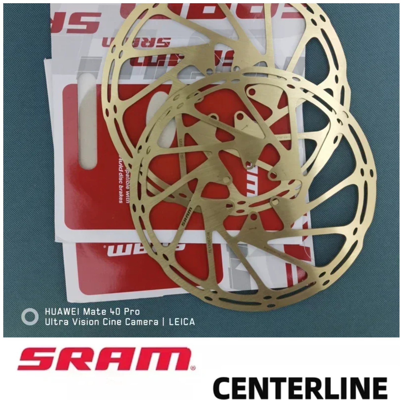

I run the SRAM Gold Centreline 203 Rotors, which are AUD$20 each, on Aliexpress. They also work really well, as well as looking good.
if you can get the 220 rotors, best upgrade ive made to my Canyon. Im happy the Amflow does not have CL rotors. Opens the door for cheaper rotors. Ill look at Ali for pads for mt7

I can't get those rotors in 220. I'm very happy with the braking, regardless.
I shopped them today and ebay, they have them and a new group of 2.3mm rotors for ebikes.
CL are the hard ones at 220
