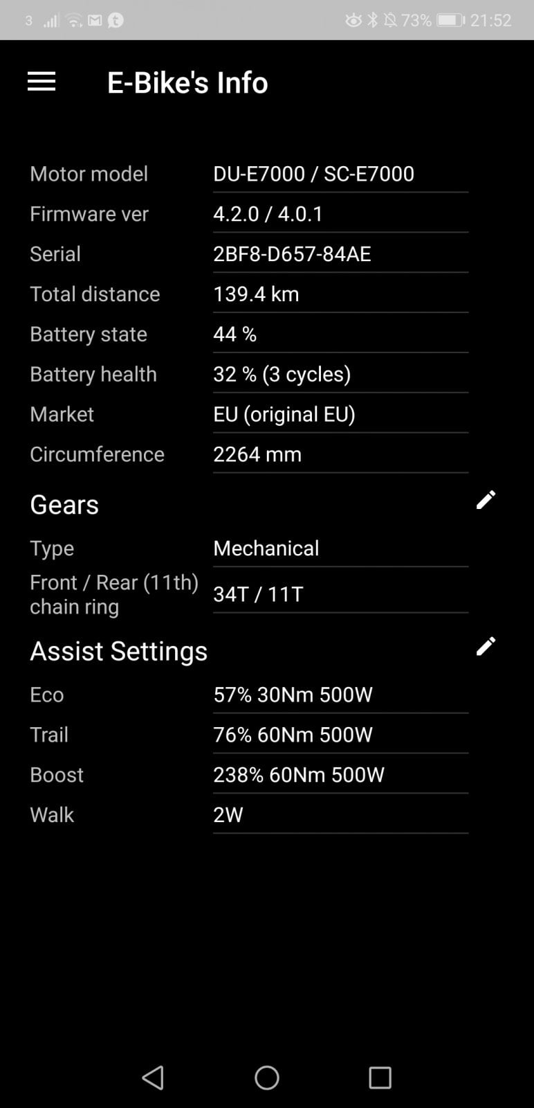

I've posted this in the other group, but do you think I have cause for concern with my reading from Steps unlocker?
It's only done 3 cycles according to that, but I'm really not understanding the 32% health part. Can anybody lend some advice on this please? Thanks, Mike
it's a bug in the software when used with E7000 motors
Mine was the same. took the battery out and tested it with the App on my other bike (E8000) and the battery health was 100%
I raised this fault with @vadII at the time in the unlocker thread but it seems he's not fixed it yet.

No. @Lawson you probably don't have a duff battery at all.
I don't know what @Vadll said above even means but if you take your battery out and put it in another E8000 bike I'd @vadll bet the price of an unlock licence it'll read 100% health. And if you take the E8000 bike's battery out and put it in your E7000 bike it'll read 32%
That was the outcome doing exactly the above procedure with 2 perfectly healthy batteries between my own 2 bikes.
I'm not sure how that is NOT a software issue with the App. :unsure:

I see that for many peoples it's so hard to understand. Ok. I'll remove this feature in a new version for all motors, except E8000 with non-integrated battery
I don't think people are not understanding, it just doesn't appear to be correct mate.
It seems as though somehow the app isn't quite taking to the e7000 properly?

And another proof of my previous post...
Look, I have only one bike, it's E8000 with external battery. I don't have access to any other bikes, sorry for that! Command for reading battery cycles and health (one command for both info) is the same for all Shimano motors (as well as other commands), but according to statistics it doesn't work on E7000 and probably on other motors. You can try to use ETube Windows App with PCE interface for non-E8000 motors and check will it retrieve Battery Health or not. I can't do this, because I don't have other bikes and don't have access to them!

It isn't a complaint mate, it was more an observation and to express my concern over me worrying about my nearly new battery. It sounds as if I don't have a problem.
More importantly, thank you for the app and your hard work ?

I've posted a new version to AppStore/Google Play. Changed logic and BT6000, BT6010 batteries are supported.
