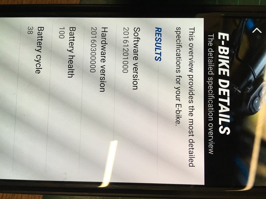

Bilko
Aug 18, 2018
53
45
Dorset
This battery is really good :) still at 100%

Modern li-ion batterie are amazing in term of how long they last when not abused. Just ride and enjoy!
