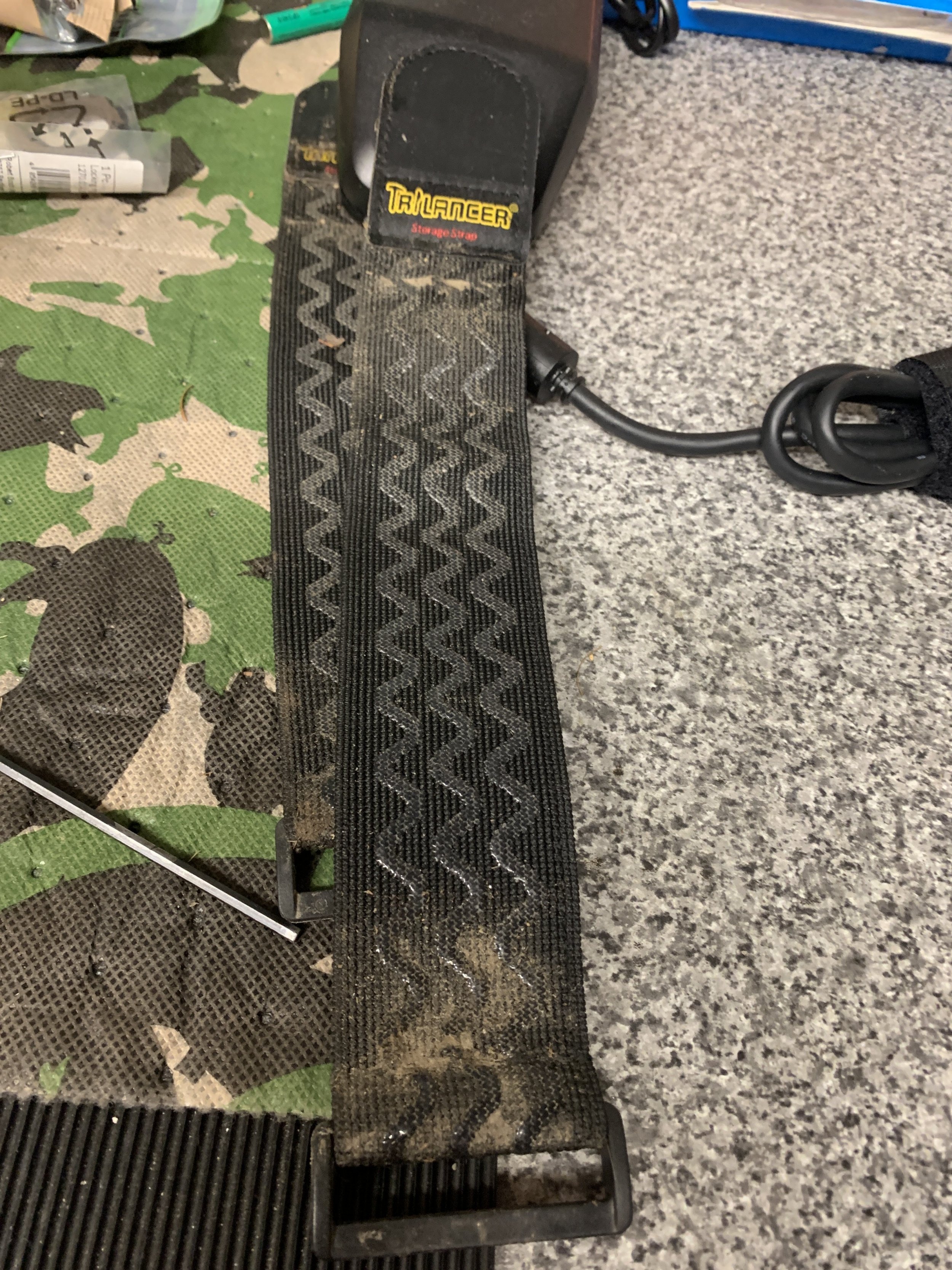

At least 400mm to go round the frame and battery.
I'll post a link to the ones I use later
The ones I was looking at are 30cm long and stretch to 48cm. That sounds like they should work. I was thinking of using perhaps just one - at the bottom of the cover. ???
Yeah that sounds ideal.
Personally I use two, one at each end of the battery, but it depends on what kind of riding you're doing.
For "light" riding one in the middle or nearer the top should be fine.
If you're doing any sort of "aggressive" riding, jumps, drops etc then I'd definitely use two.
The ones I use are quite thin so I can wrap them around the battery and frame then the battery cover fits over the top. The only downside is water can get past the cover a little easier like this, but you can also get neoprene wraps to help if you do a lot of wet weather riding.
These are what I use, they have no stretch so hold everything very securely, I use a small piece of rubber under the buckle to stop it scratching the frame
I have the 50mm X 400mm
Just for completeness.... i ended up ordering these Trilancer Straps They arrived today and seem to be a perfect fit for my Cube. I just need to test them ASAP. I can think of a few other uses for them as well including helping with additional security in attaching bike to towball bike rack (Buzz Rack E-Hornet 2).
