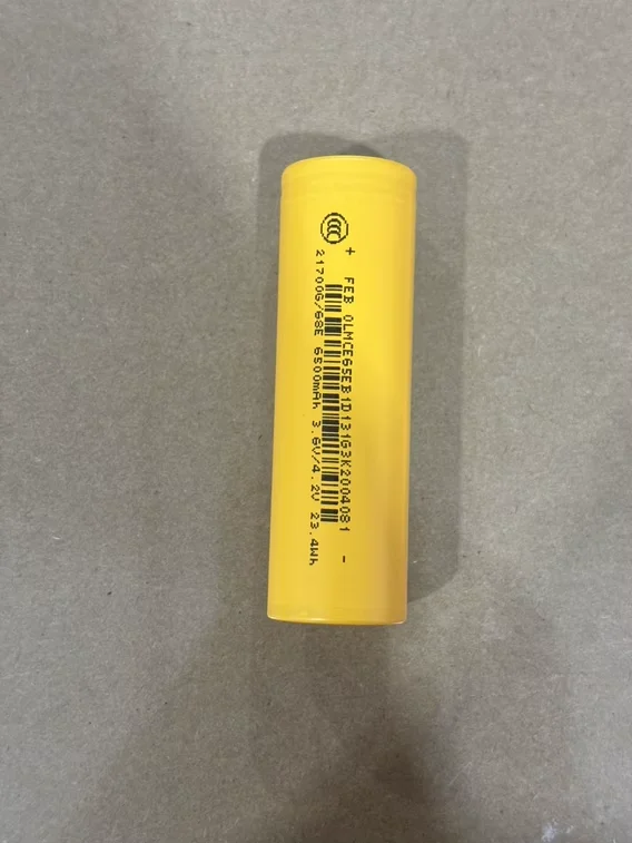

Guess it depends on what pack are you trying to build. All those cells are fine, quality wise. Feb have lower CDR ratings but if you keep the max current at 4-5A/cell they will work just fine and they are cheaper.
