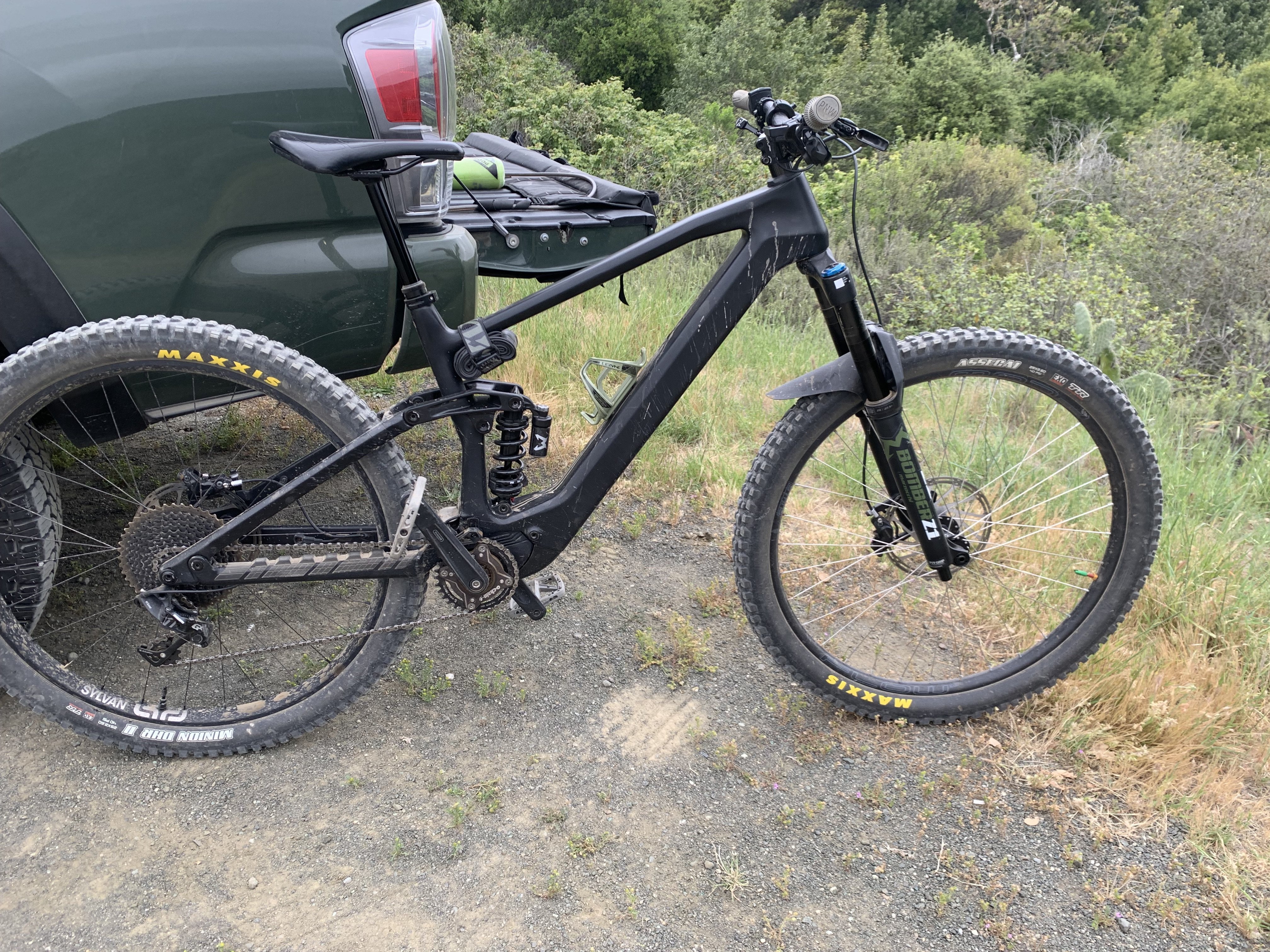

Hey all, is the bafang m820 motor spindle its own ? like is it same as bosch or fazua? i’m wanting to try an ochain on my LCE 930.

The only place I found online that sells Bafang O-Chain is www.agazzinibike.it. I ordered one, its a little bit of a hassle having to email the company and process money order and all that but they got it to me pretty fast from Italy to USA. The site doesn't show that it's for the M820 but it works. You can see on their site that they use the same product on their LCE930 frame bikes. I had to use one more spacer than what was provided to get in the right chain line. BTW I also got the new E13 Sidekick hub and it seems to accomplish the same thing. But i said F it and got both, super plush

thanks so the site say suit bafang 500 600 but also fits 820?. is there an english website?
Yes its the same size. I ordered one, so I know. This is the product they use on their m820 bikes. It fits. You have to email the company if you want to order or have any questions. The guy is cool. Very helpful.

hey how do you like the coil in the rear? how heavy are you?

coil in the rear is so smooth. i'm usually smiling ear to ear after blasting through a chunky section. looking to Coil my Bronson when i can buy more bike parts

got the sidekick for my LCE can wait to lace it up
sidekick is pretty good!! i also fitted the marzochhi coil, pairs well with the hub
