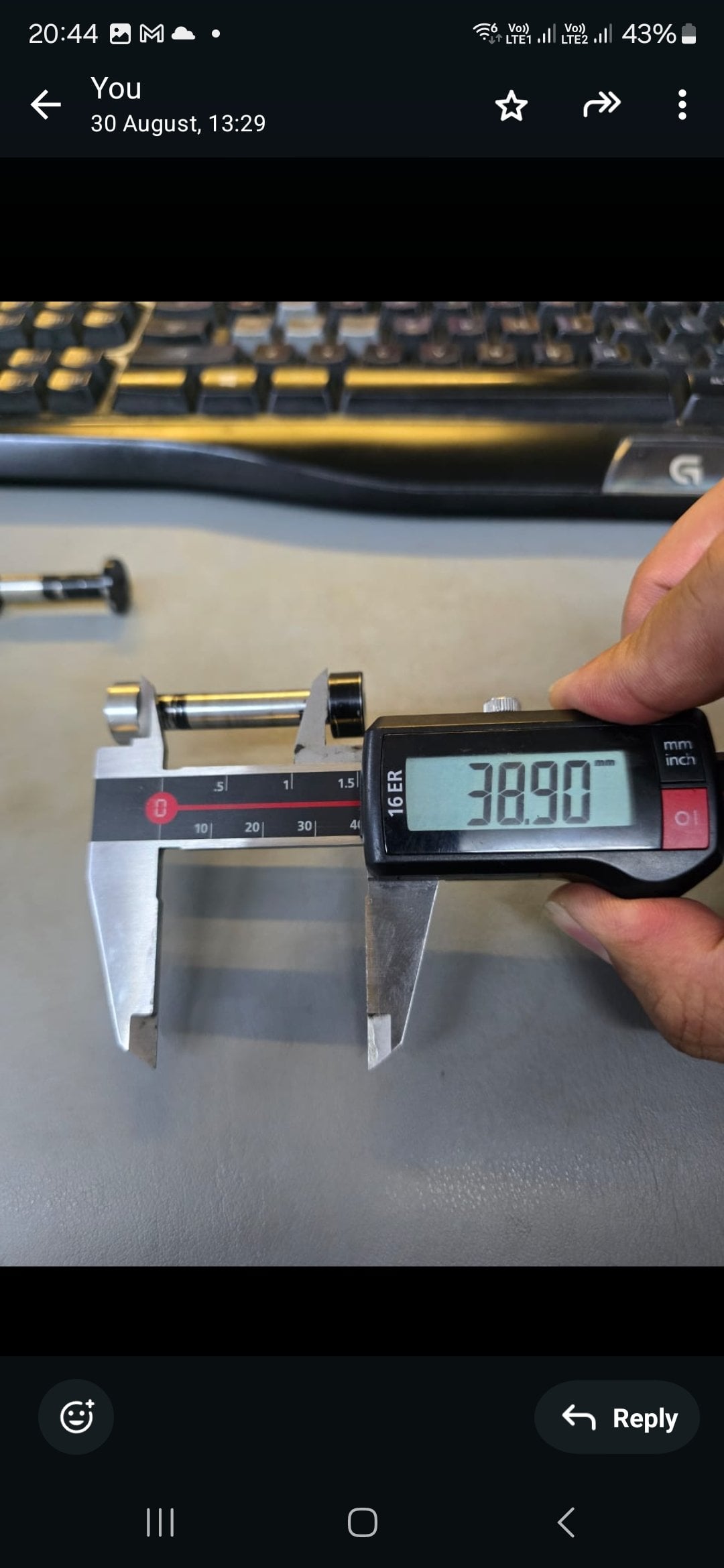

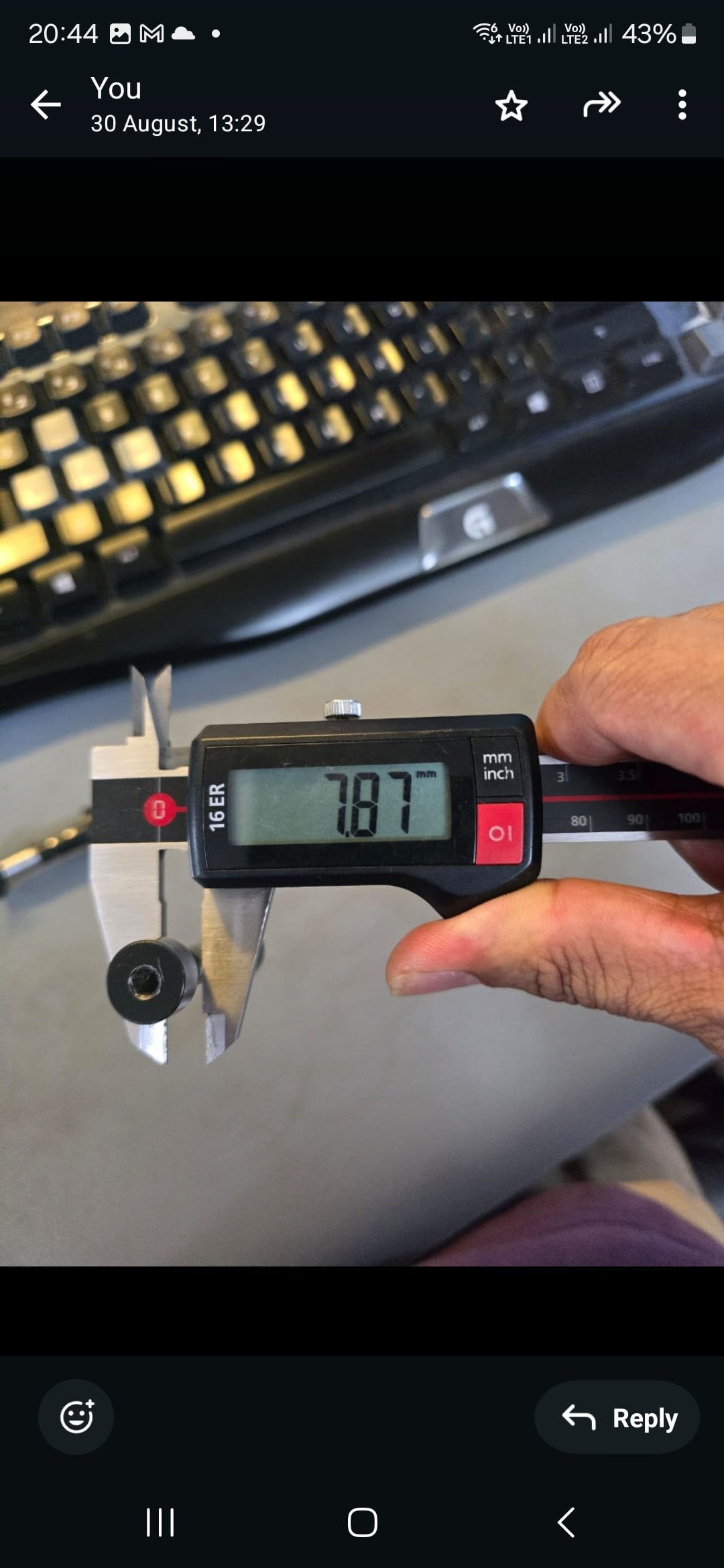

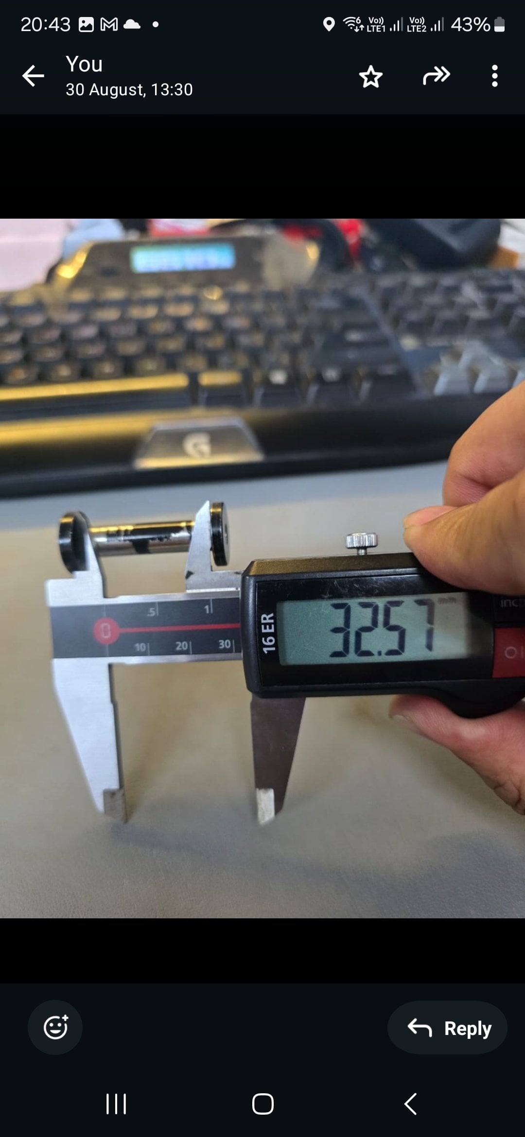

Sure:

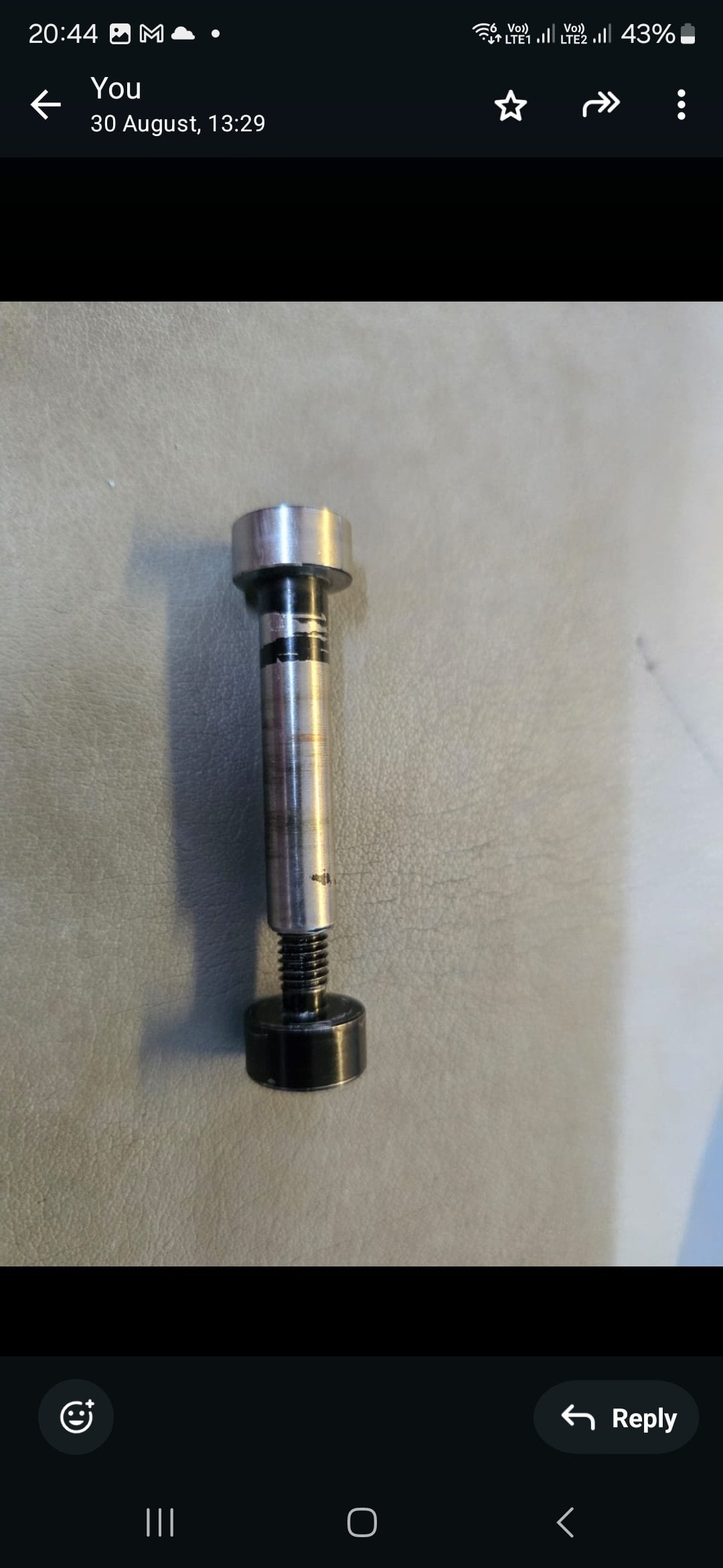

And in the meantime, I can see, why it was not obvious... I meant the bolts for the SHOCK - which should be clear - but I wrote the bolts for the SHOP... :D

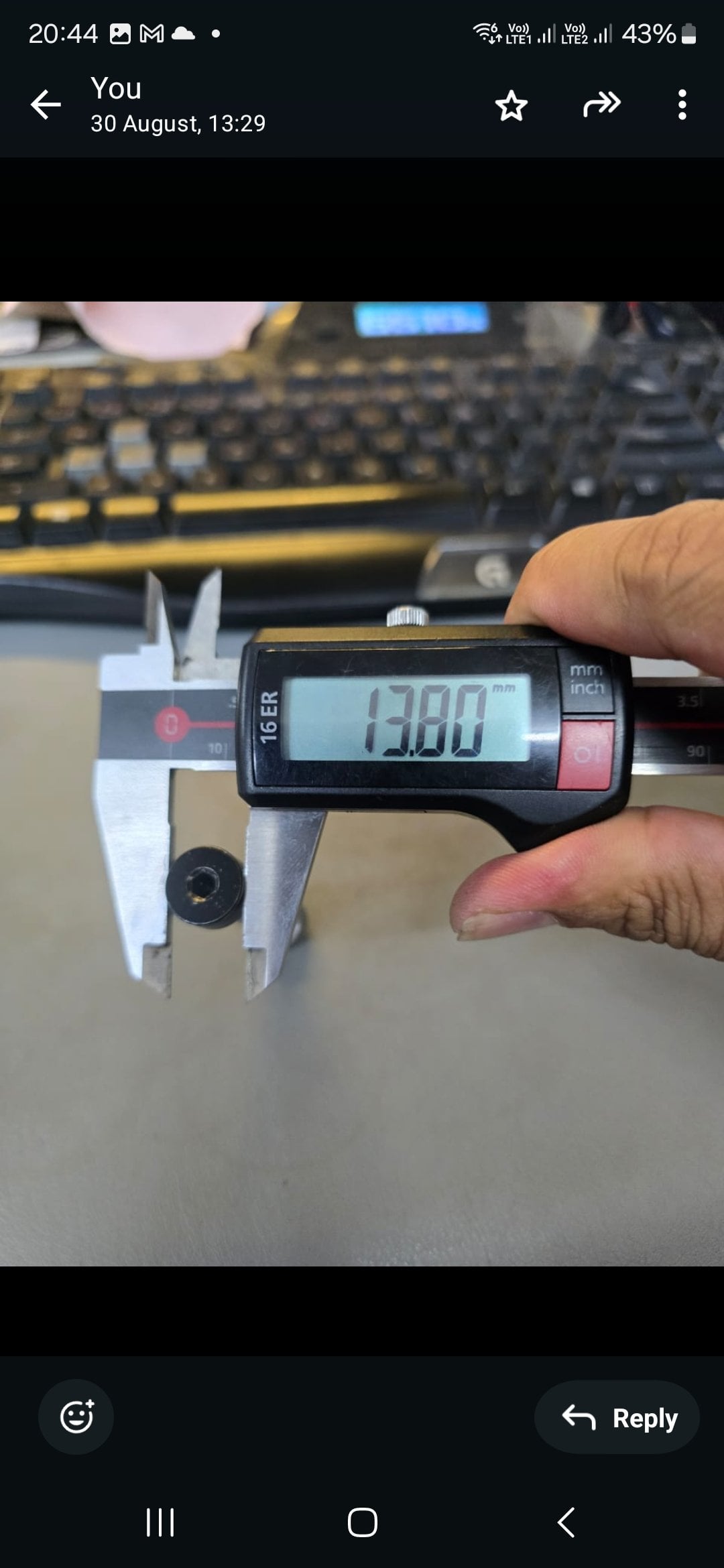

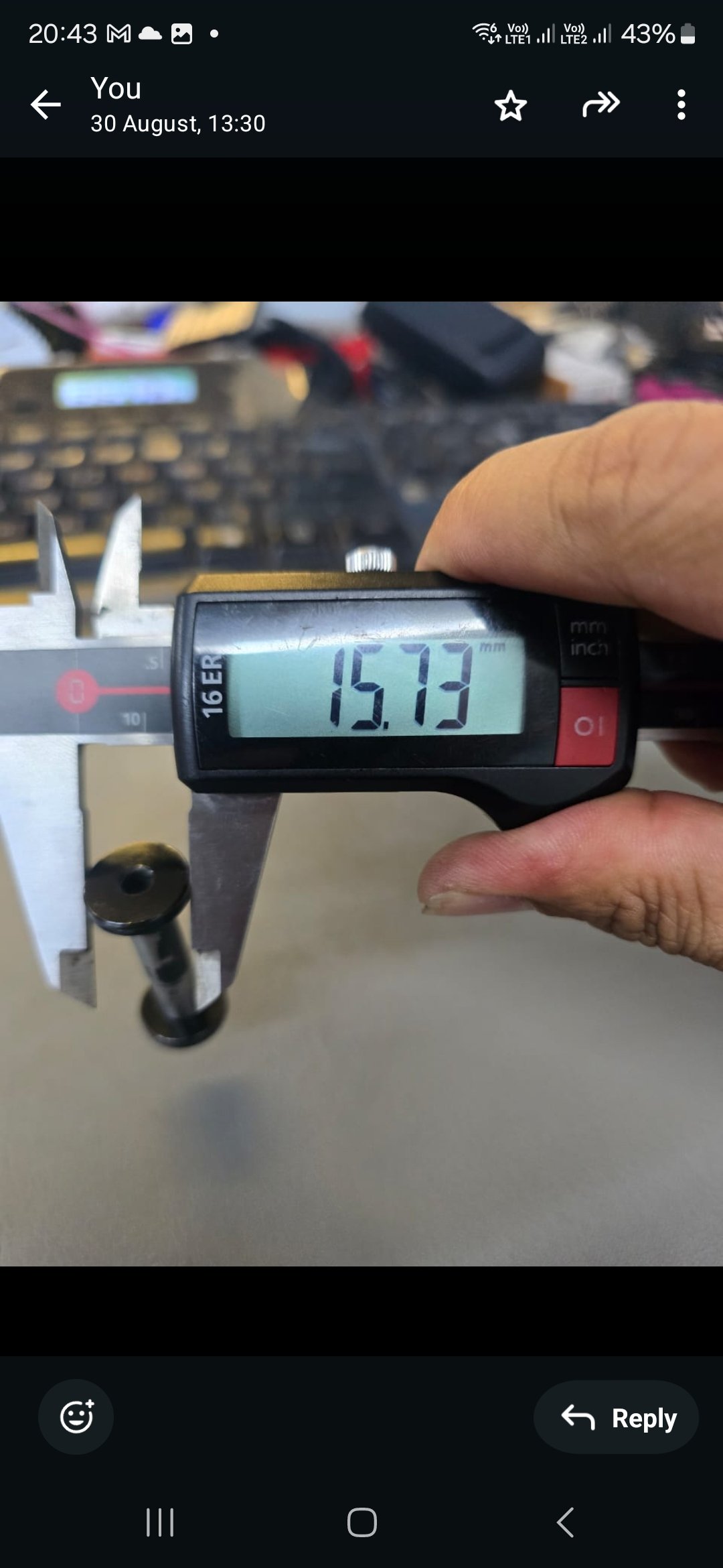

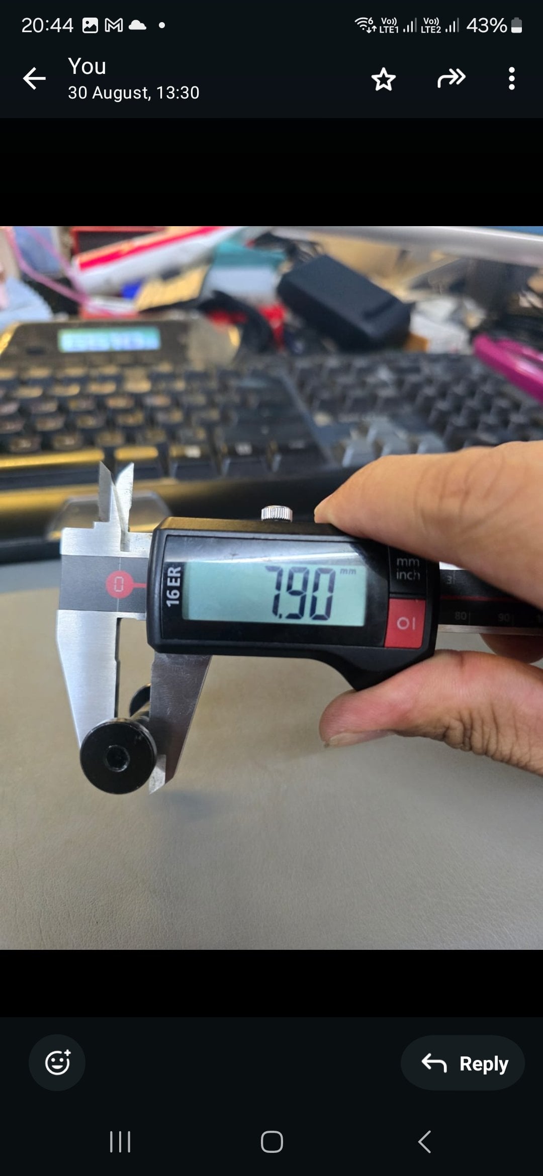

Contact Jean, she will sell you those shock bolts, if u lost the male bolts , just use your water bottle bolts, i lost my in trail and use water bottle until Jean send me a new bolt, it around 10usd. It's custom size , i try Google it but no luck.
Screenshot_20241001_204416_WhatsApp.jpg Screenshot_20241001_204412_WhatsApp.jpg Screenshot_20241001_204409_WhatsApp.jpg Screenshot_20241001_204405_WhatsApp.jpg
Thanks, I will contact her, but I fear, that the next bolts will be soft aluminium as well.
I would like to get bolts in titanium or steel...
Thank you!
BTW: I did not lose a part - I broke the Hex inside the bolt head...
So I will have to break it, to get it out...

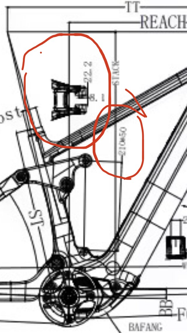

Hello, I have ordered a battery motor and a CEF 50 frame. I would like to know if this shock absorber is suitable for me. It says it is 210-50. The other measurement that is indicated on the geometry of the frame is 8* - 22.2. I also don't know if that measurement is the one that the shock absorber has.

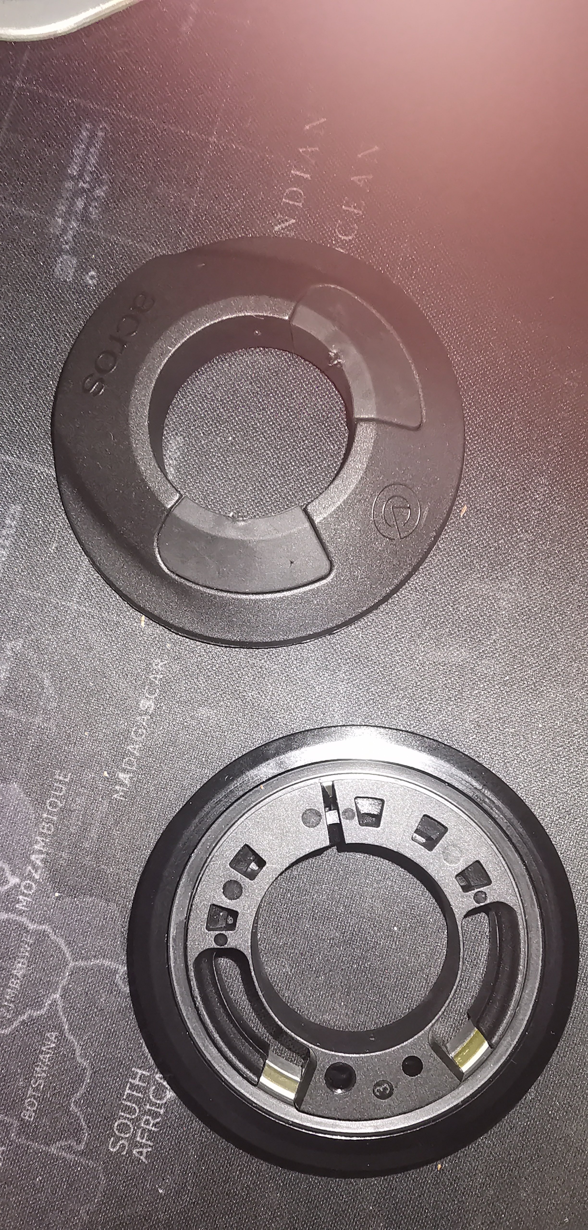

my headset creaks so bad, cant really get it tight always has slop. Is it the bearings, or do I need a different headset as the one with the bike is not great. THoughts?
i decided to buy replacement top and bottom headset fittings cannot give you on any feedback because still working on the frame and i have a problem with my motor or controoler not being found by the besst tool. these are the ones i got.
