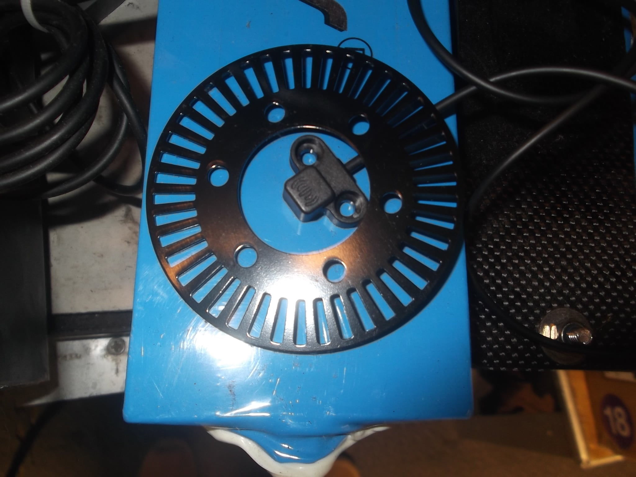

Does than new speed disc speed sensor send the same signal on the same pins as the old magnet sensor? I mean can I safely connect the old CANBUS Bafang motor to this sensor? Can it damage something on the motor controller, or can it be damaged by old Bafang motor, or it will just read wrong speed and nothing really bad will happen?
TQ, hard to tell now. There is a small box in front of new speed sensor. I guess it is a convertor to CAN bus? Or there can be also just normal signal with 42 signals per revolution.

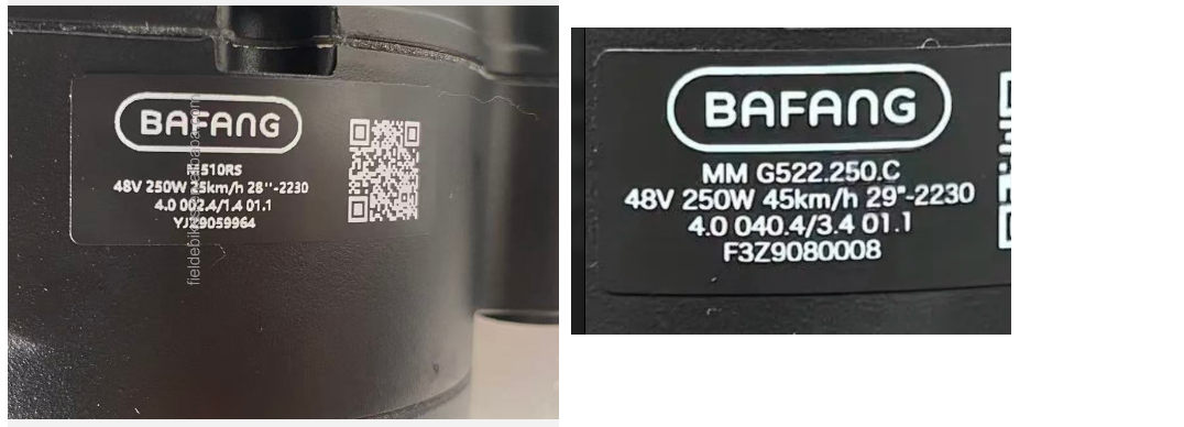

There is M510 FC4.0 motor available, I have ordered cef69 with it. On the left there is RS motor which also looks like is FC4.0.
Just wondering what would be the hardware differences in between them.

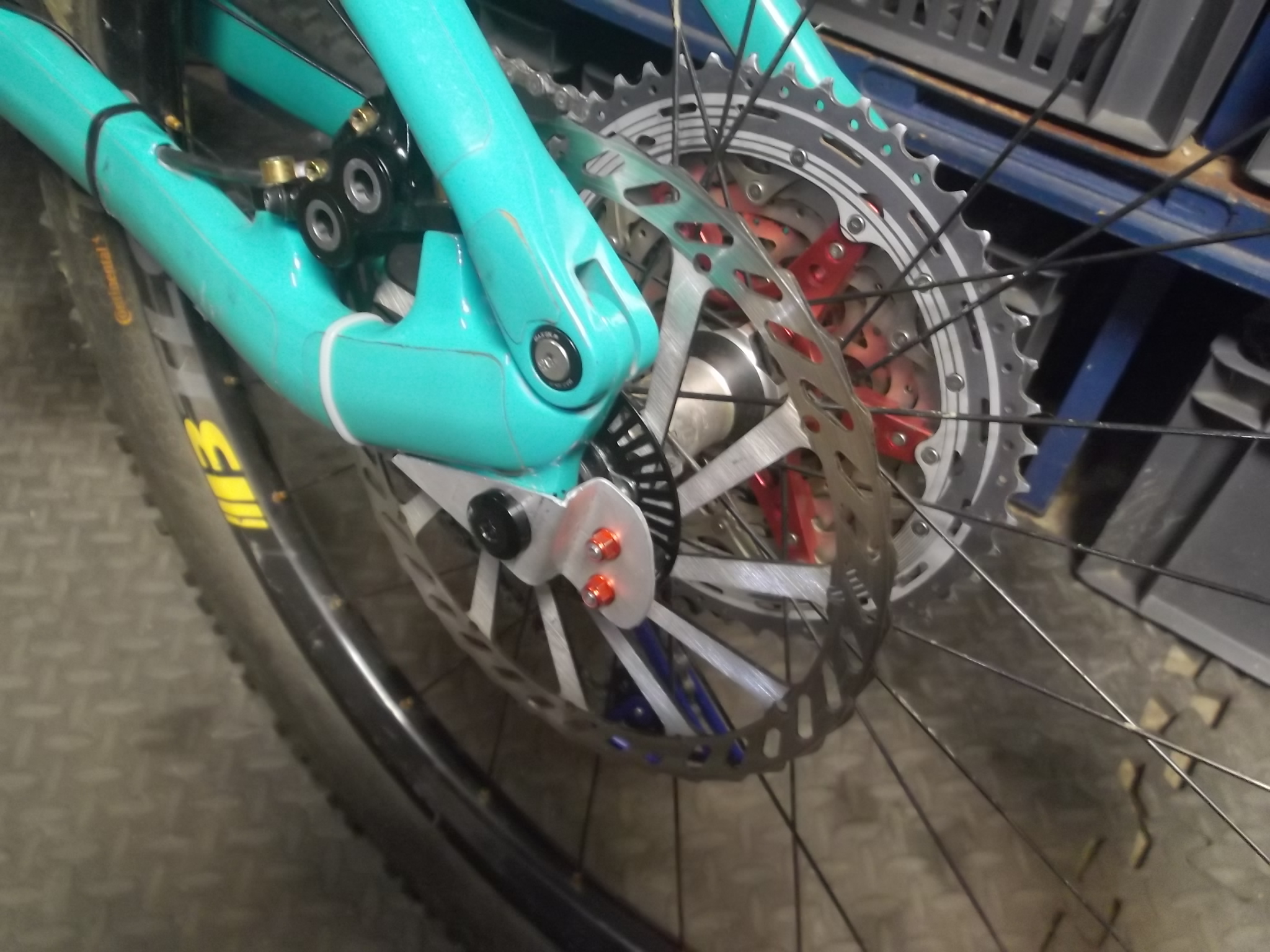

M510RS uses multi point speed sensor. It looks like this sensor might be able to detect direction of rotation (there is some small box attached to it).
So in therms of hardware two motors might be very similar.
Hello mate. HW will be with hight probability the same. Also 560RS is the same (different torque sensor).
On the right I see better torque sensor 3.4

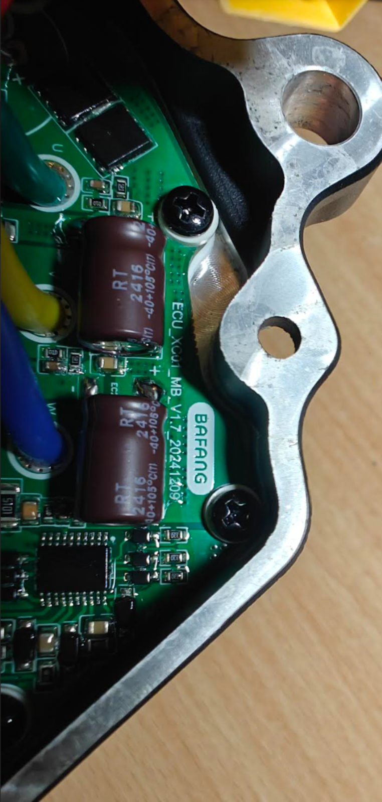

And you right there can be same versions of controller in both 4.0. Guess will be this controller, just they messing it with the labels
With that new speed disc and small box it is really starnge. When I was measuring it, it has output just on SPD1 pin signal. If you want to detect rotation you need 2 SPD pins. And this is how older sensors works (motor just ignoring SPD2 as no needed to detect backwards rotation). So looks like that funny box is spoiling it. First I thought it is converting speed sensor signal to CAN bus. But is not. Or voltage ramp up?
Was not measuring signal from sensor (after the box) as dont have that new small connector.
But there is a video with M510RS, where is working "hill holding" function. So means it must be detecting backwards rotation. Not sure if that box is included here.
In the new/disc sensor there are 2 sensors inside with phase shift so box must translating somehow two readings into one send only to spd1 pin. If you can scope spd1 pin forward and backward than it will be clear. Easiest way to translate 2 readings into one pin would be some kind of modulation, different forward/backward.
I did, only SPD1 has a signal and no modulation. It is just hole and no hole = 0/1

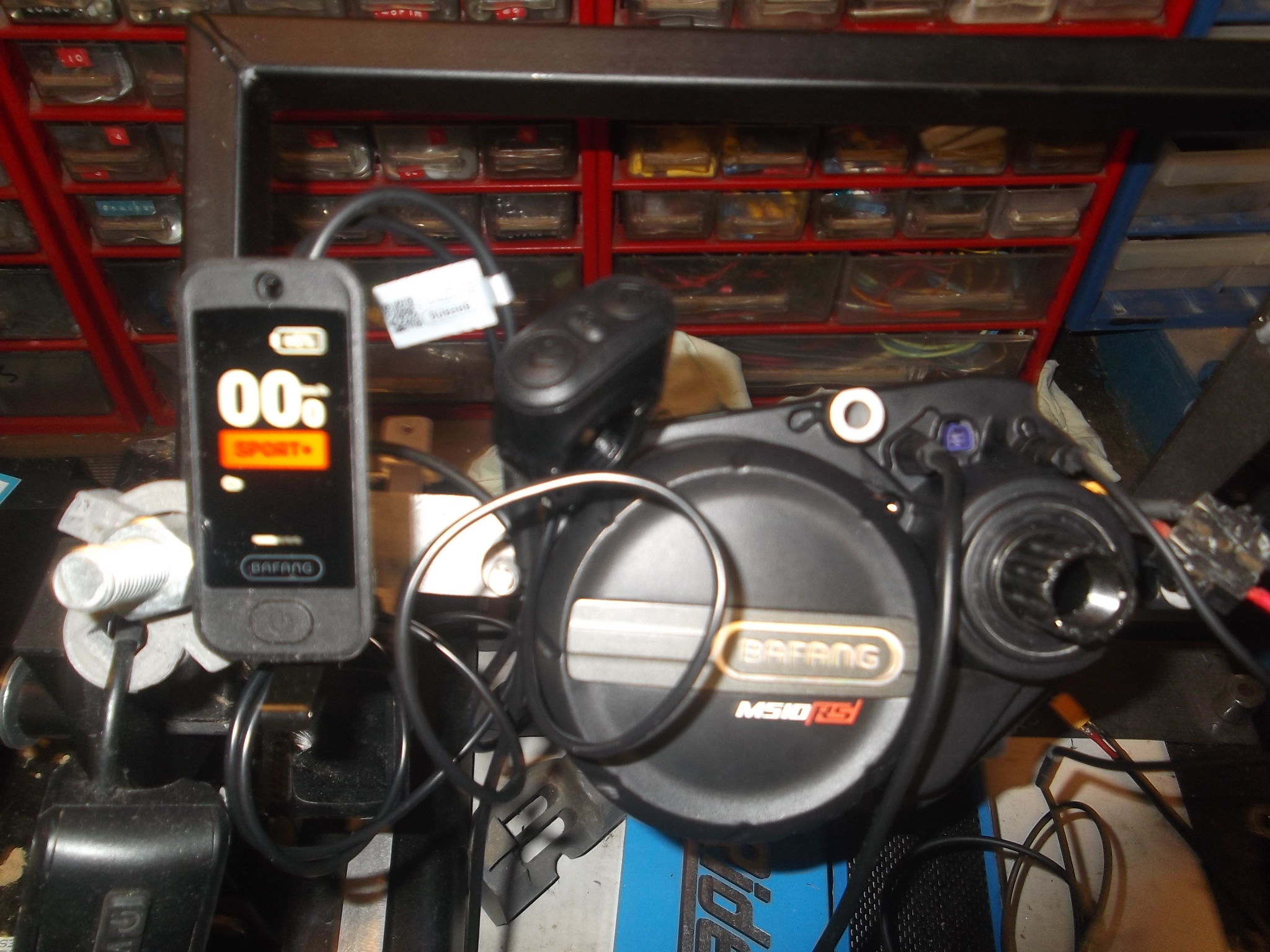

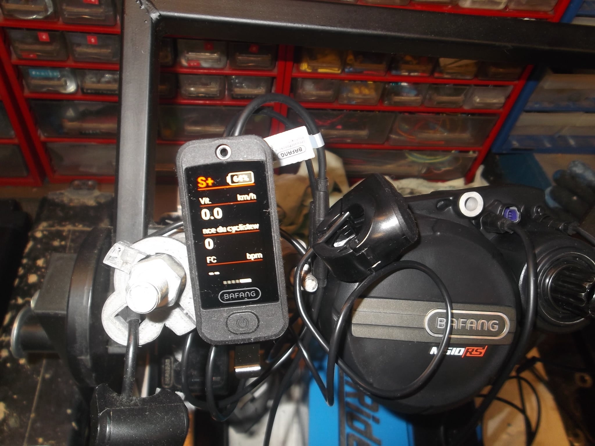

i add received one. HMI is an DPC030 -01, it seem able to diplaying human power (and also motor power) and heart rate. the remote switch is different than previous. It have 4 mode eco, tour, sport, sport+ (automatic mode ?) and boost. same crankarms assembly and wiring connections than M510.
i have checked in BEEST pro and i don't seen differncies on avaible setting than M510 rev2 ? just used the walk mode and it's seem lack of grease, i will check later. I can't test it for the moment (i'm injured) and i need to adapt the multipoint speed sensor

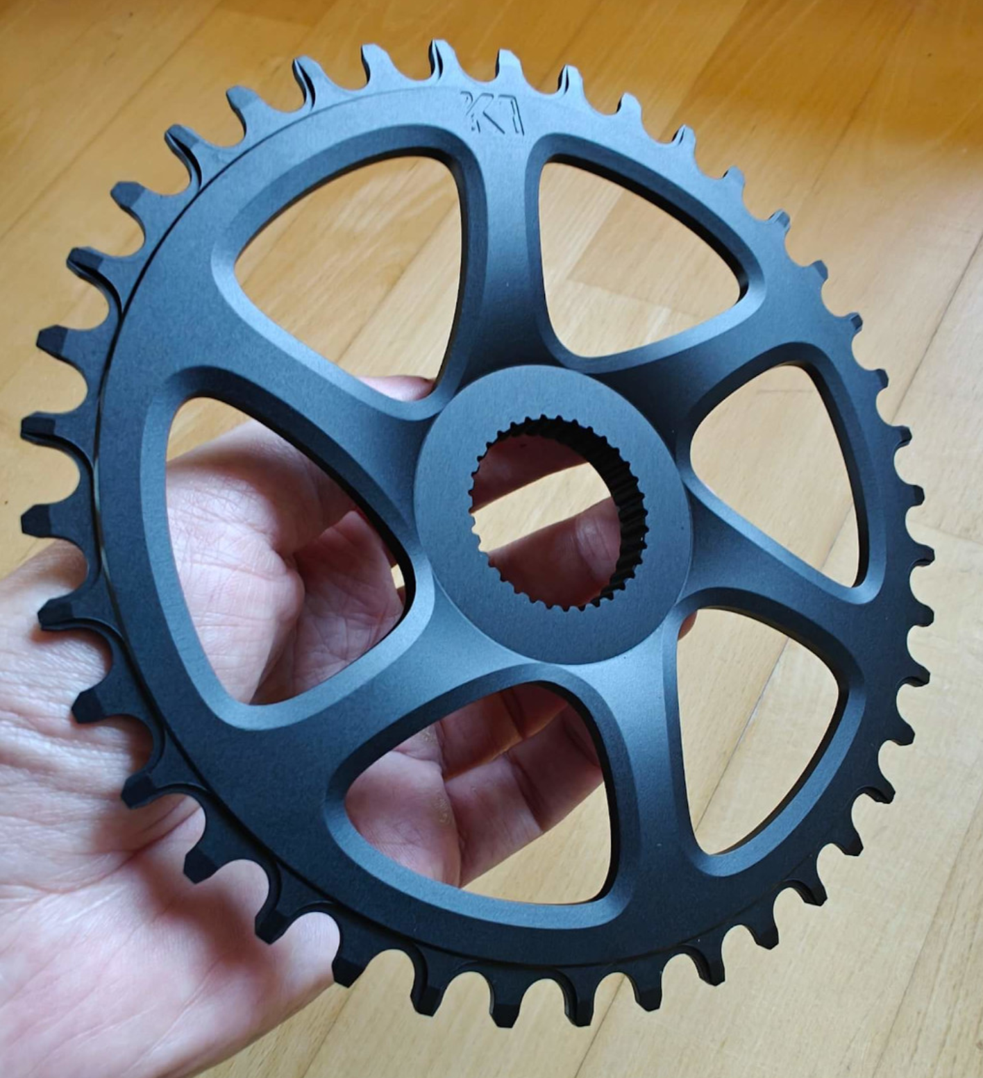

Does anyone know where to buy a 510 direct mount chainring narrow wide like Raceface do

Hello. You mean single piece?
It is all with spiders.
I have draw one and have produced. But too expensive - that splines on inside.
Yes that’s what I was after, I haven’t checked if Bafang is the same spline as Bosch yet.

installed.
The throttle don't functioning (alike the M820)
the walk mode going forward at 5 KM/h, regardless of the position on the rear gear.
i need to build an bracket for the speed sensor and i could able to test it outside
