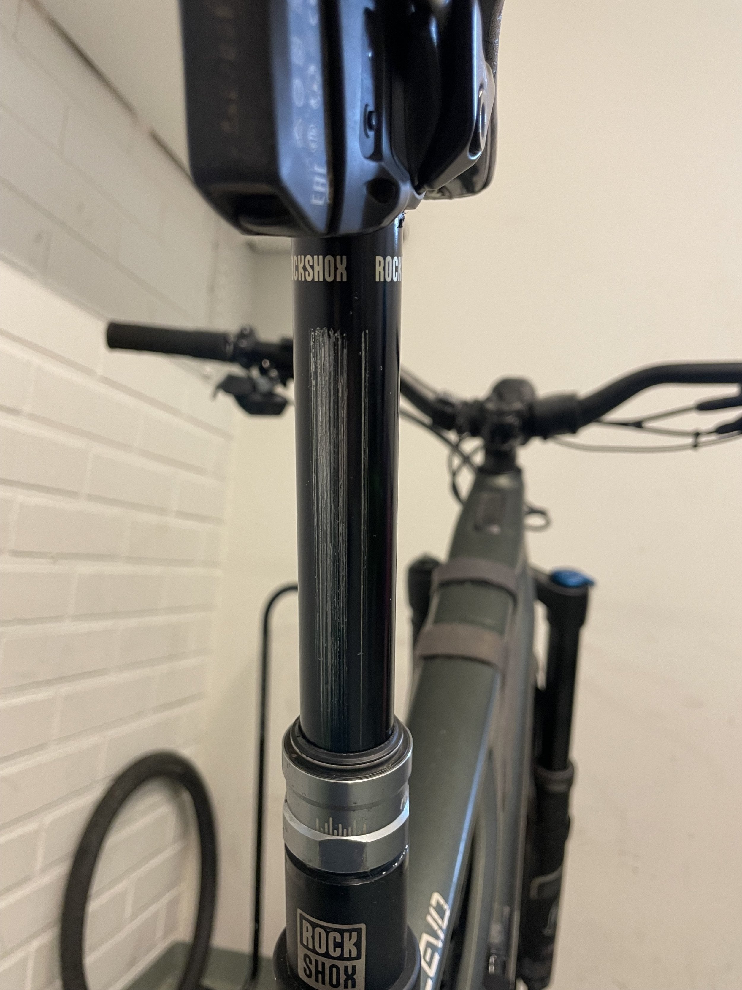

That is totally false, Reverb AXS requires 50H, 200H & 600H services.
50H service is basically just clean & apply new grease, but 200H & 600H services have a service kit with parts to replace.

Interesting. I guess I’ve just been doing the 50H for 2 years and it feels as good as new. Do u have links to the 200H and 600H services? I bet they are still much easier to do than servicing on a regular dropper?

Yes. And those service kits are sometimes hard to find.
