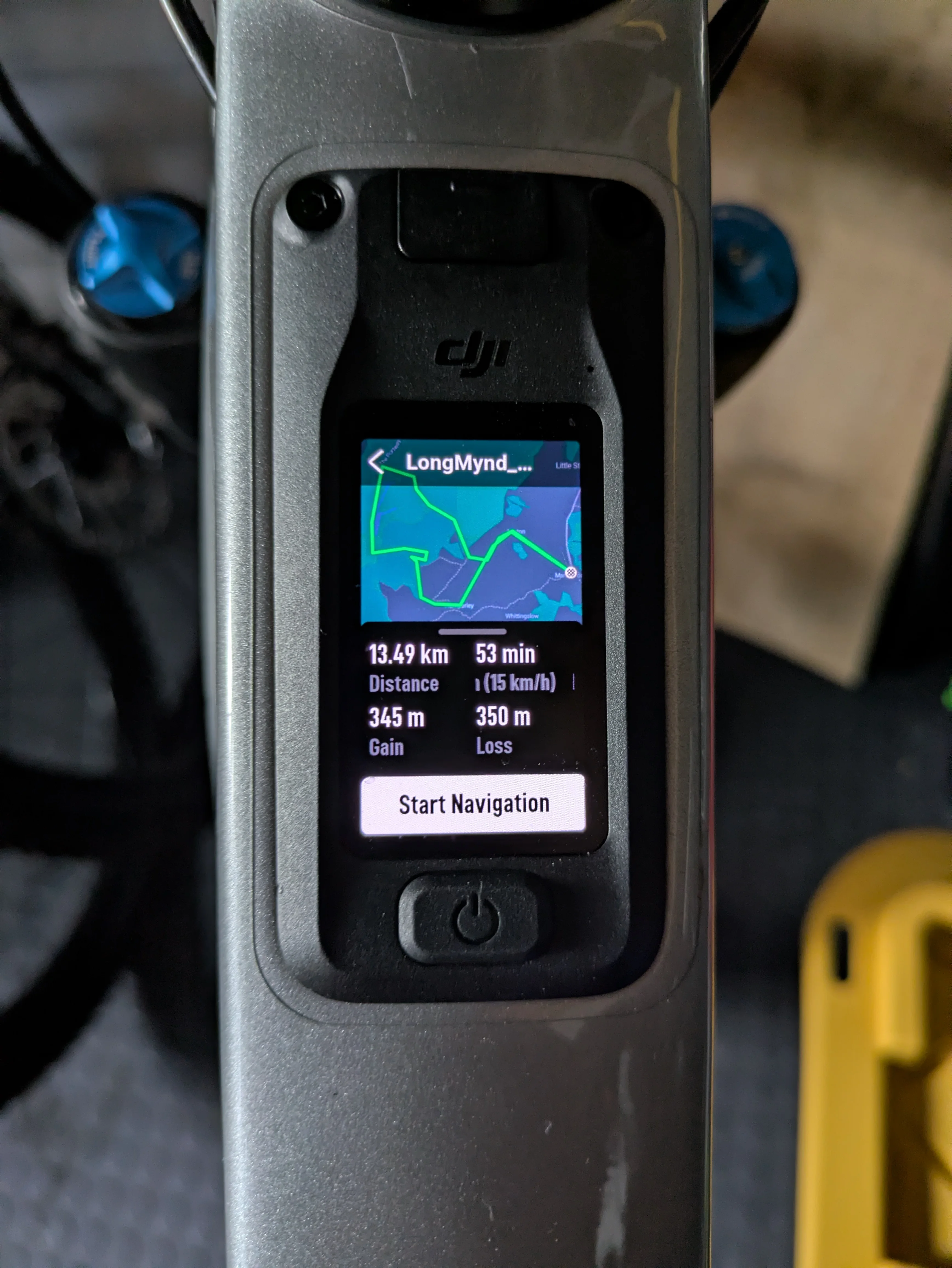

I have just transferred a 23km circular route (Android app v1.3.30) and it has worked OK. Pressed to start to navigate (will get confused as I'm miles away from the start) and seemed to work other than error about lack of GPS signal. I'll try the same thing later when I'm well away from any buildings or anything else to interfere with GPS.

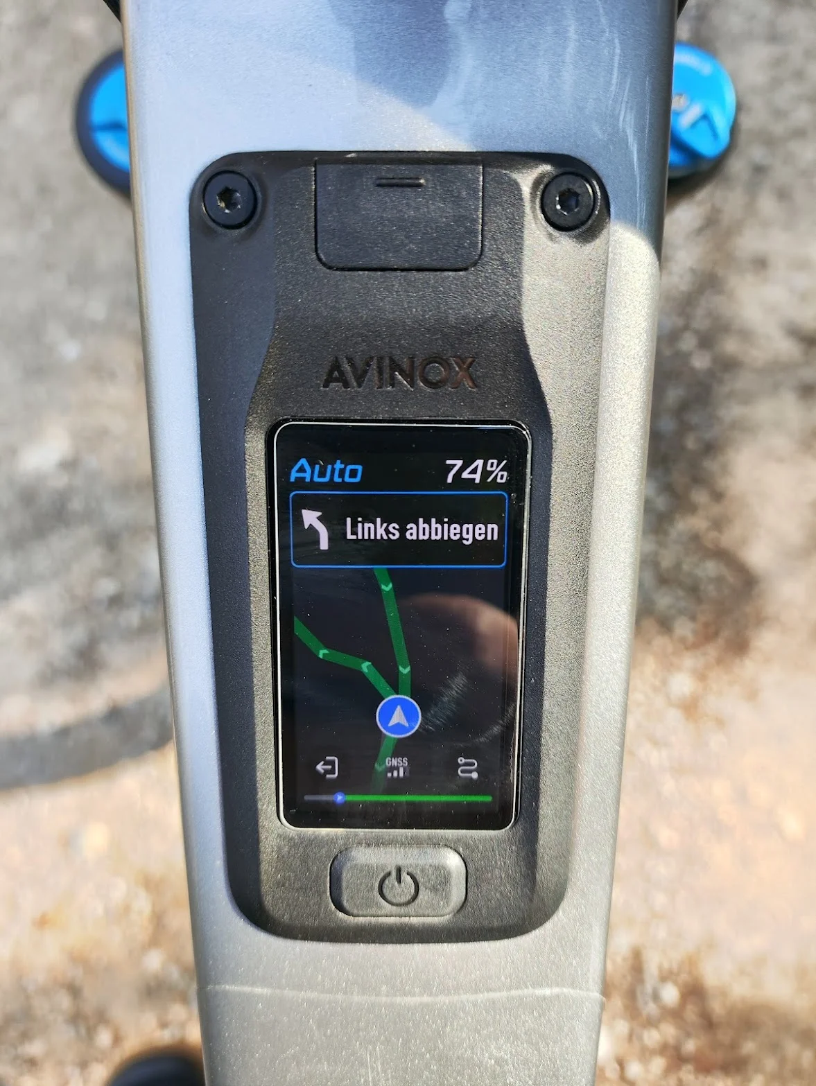

The navigation itself is really good - it extracts turns out of the GPS data. Here is a picture of it during my ride:

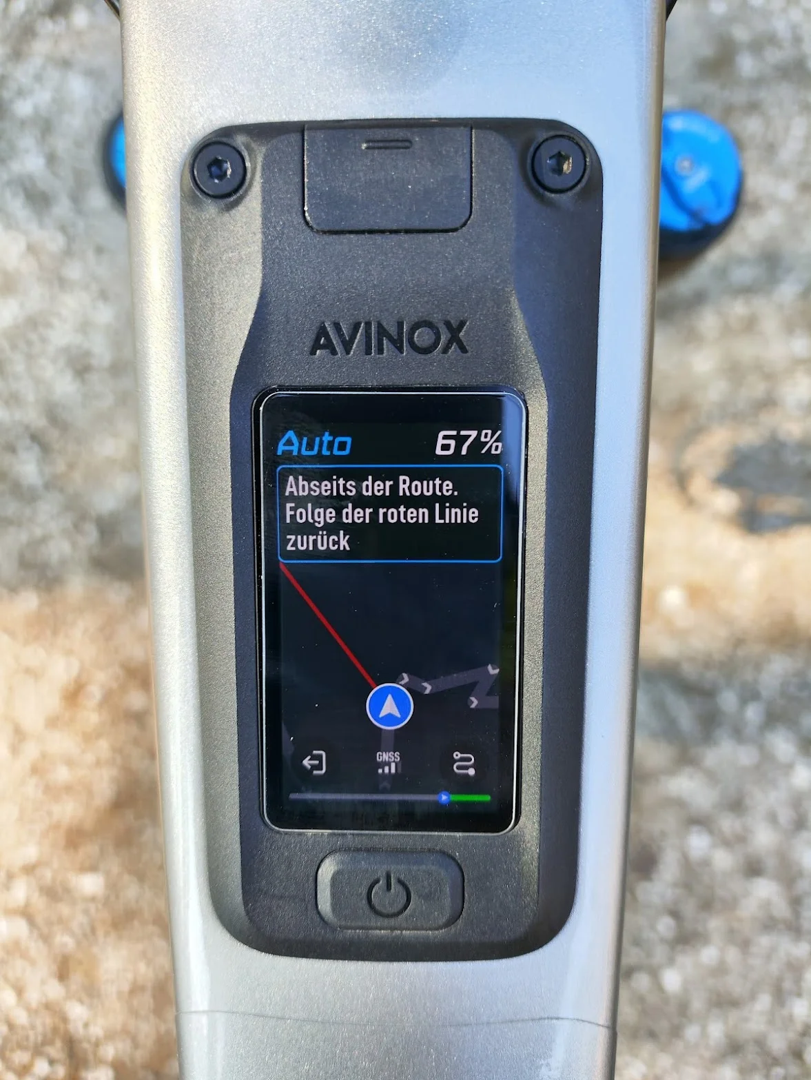

I had one problem during the run: it does not continue as soon as you get off the track a bit and get back on it. The navigation always says to get back where you left off the track (even though you are on the track again):

  • Good navigation with cool features!
  • Very cool that it can extract turns out the GPX infos - this works really well.
  • You cannot switch to the other screens with your remote - you have to swipe on the display. You can get back to navigation from the control center screen.
  • Small issue: the navigation cannot get back on track once you got off it.
