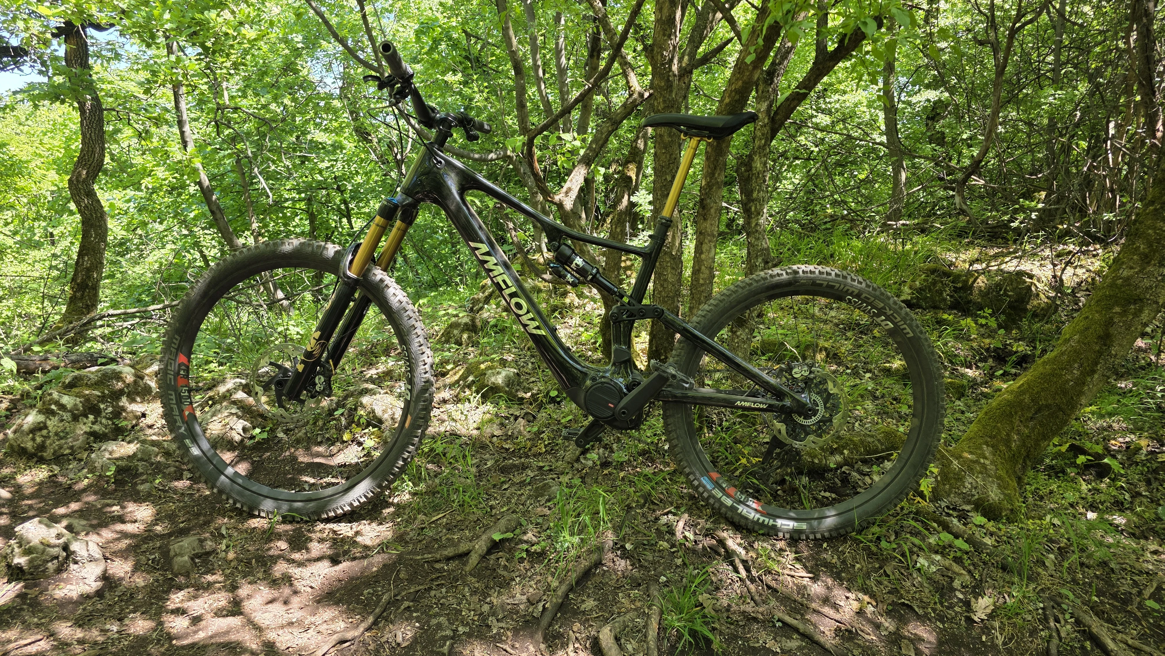

800 miles m2s px pro.
I have some more noticeable raspy noise that i dont think was there before in gears lower than 6 on steep climbs, but no real rattle still. Nothing like the rasp in the video, but nonetheless something I am keeping an eye on. Almost whisper quiet when gear 7 or higher in auto and on relatively flat ground/mild fire road climbs.
I did, however, manage to coax a similar-to-reported rattle noise out by peddling hard under full load at roots before immediately coasting. Very specific, but here is about a half a second window between the overrun finishing and the motor going chill while coasting. In this window of time I can reliably replicate about 1 big slap of that M1 rattle by hitting something chunky, but continuing to coast downhill afterwards there is absolutly nothing more for kms once i'm coasting - silent.

Check your chain stretch and cassette.

Not pointing to you specifically, but it might be worth separating out other potential motors issues for the specific topic of this thread, which is M2S motor rattle. Already on this thread there have been conflations between rattle and rasping issues. The true controversy here - of which we are still trying to assess the scope of it and which in the end may be quite limited - is the possibility of a motor specifically designed to address motor rattle that is not working as designed. Any intel on actual first hand broken-in (150 miles +) owner experiences with the presence (or absence) M2S rattle/float and consequent warranty handling where specific rattle exists are of greatest epistemic value, as in separating the signal from the noise.
Fair enough. Essence of my post was "still no rattle".
Thats the data point as one of us with a higher mileage count on the m2s. Well and truly broken in at this point.
