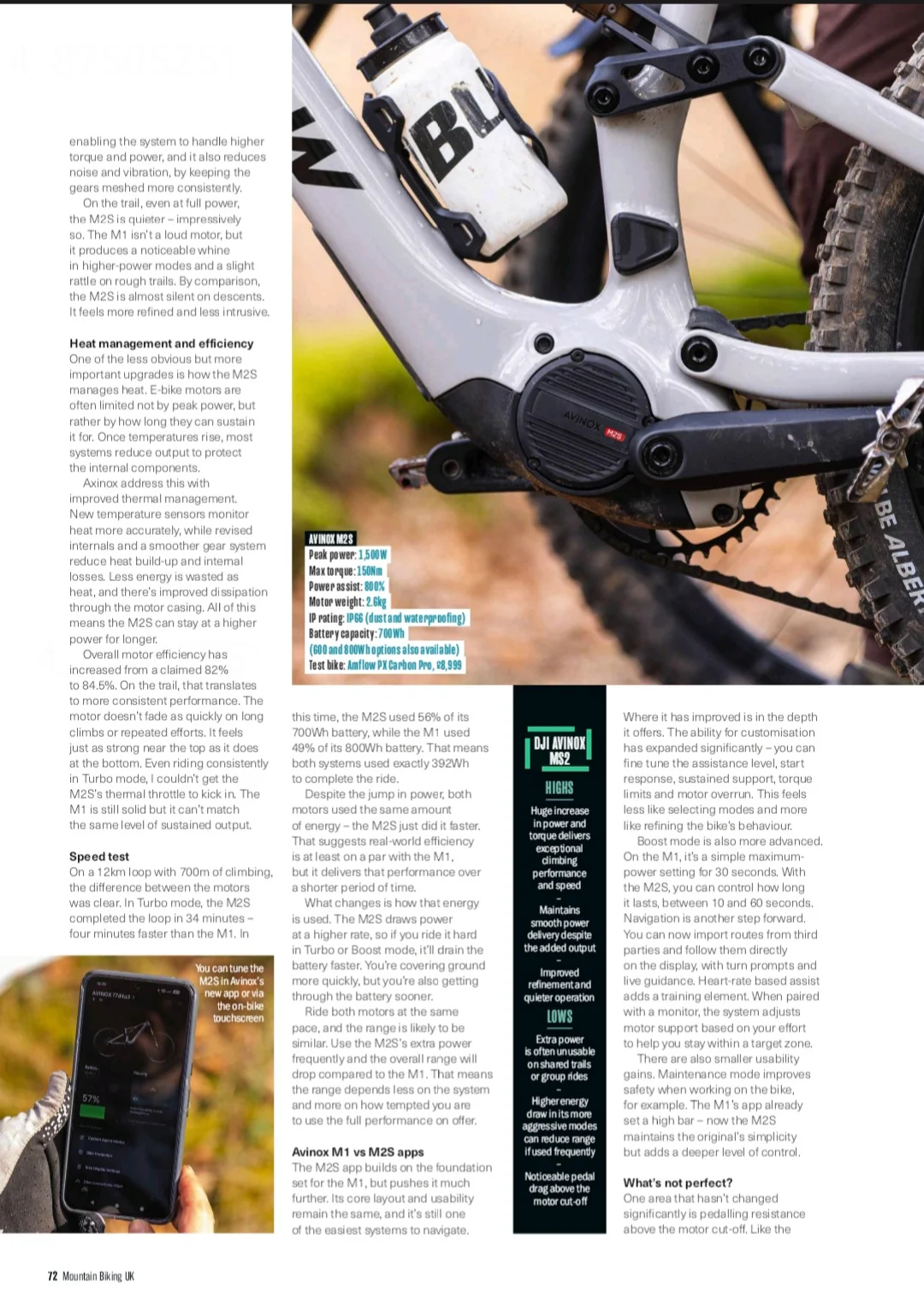

Gearing differences
Another signi�cant change is in the motor’s gearing. The M2S uses helical gears with a dual-engagement design, rather than the straight-cut gears in the M1. That does two things. It increases load capacity,
enabling the system to handle higher torque and power, and it also reduces noise and vibration, by keeping the gears meshed more consistently.
On the trail, even at full power, the M2S is quieter – impressively so. The M1 isn’t a loud motor, but it produces a noticeable whine in higher-power modes and a slight rattle on rough trails. By comparison, the M2S is almost silent on descents. It feels more re“ned and less intrusive.
Heat management and efficiency
One of the less obvious but more important upgrades is how the M2S manages heat. E-bike motors are often limited not by peak power, but rather by how long they can sustain it for. Once temperatures rise, most systems reduce output to protect the internal components.
Axinox address this with improved thermal management. New temperature sensors monitor heat more accurately, while revised internals and a smoother gear system reduce heat build-up and internal losses. Less energy is wasted as heat, and there’s improved dissipation through the motor casing. All of this means the M2S can stay at a higher power for longer.
Overall motor e…ciency has increased from a claimed 82% to 84.5%. On the trail, that translates to more consistent performance. The motor doesn’t fade as quickly on long climbs or repeated e‘orts. It feels just as strong near the top as it does at the bottom. Even riding consistently in Turbo mode, I couldn’t get the M2S’s thermal throttle to kick in. The M1 is still solid but it can’t match the same level of sustained output.
Speed test
On a 12km loop with 700m of climbing, the di‘erence between the motors was clear. In Turbo mode, the M2S completed the loop in 34 minutes – four minutes faster than the M1. In this time, the M2S used 56% of its 700Wh battery, while the M1 used 49% of its 800Wh battery. That means both systems used exactly 392Wh to complete the ride.
Despite the jump in power, both motors used the same amount of energy – the M2S just did it faster. That suggests real-world e…ciency is at least on a par with the M1, but it delivers that performance over a shorter period of time.
What changes is how that energy is used. The M2S draws power at a higher rate, so if you ride it hard in Turbo or Boost mode, it’ll drain the battery faster. You’re covering ground more quickly, but you’re also getting through the battery sooner.
Ride both motors at the same pace, and the range is likely to be similar. Use the M2S’s extra power frequently and the overall range will drop compared to the M1. That means the range depends less on the system and more on how tempted you are to use the full performance on o‘er.
Avinox M1 vs M2S apps
The M2S app builds on the foundation set for the M1, but pushes it much further. Its core layout and usability remain the same, and it’s still one of the easiest systems to navigate.
Where it has improved is in the depth it o‘ers. The ability for customisation has expanded signi“cantly – you can “ne tune the assistance level, start response, sustained support, torque limits and motor overrun. This feels less like selecting modes and more like re“ning the bike’s behaviour.
Boost mode is also more advanced. On the M1, it’s a simple maximumpower setting for 30 seconds. With the M2S, you can control how long it lasts, between 10 and 60 seconds. Navigation is another step forward. You can now import routes from third parties and follow them directly on the display, with turn prompts and live guidance. Heart-rate based assist adds a training element. When paired with a monitor, the system adjusts motor support based on your e‘ort to help you stay within a target zone.
There are also smaller usability gains. Maintenance mode improves safety when working on the bike, for example. The M1’s app already set a high bar – now the M2S maintains the original’s simplicity but adds a deeper level of control.
What’s not perfect?
One area that hasn’t changed signi“cantly is pedalling resistance above the motor cut-o‘. Like the
M1, the M2S still feels draggy once assistance cuts out. It’s not a dealbreaker, but is noticeable, especially on atter terrain where you’re riding above the limit – which is easy to reach with the M2S’s immense power.
Battery indicator accuracy at low charge could also be improved. The bike showed around 12% remaining, but this dropped quickly to 5% and the M2S then entered a reducedpower mode. I didn’t experience the same behaviour with the M1.
