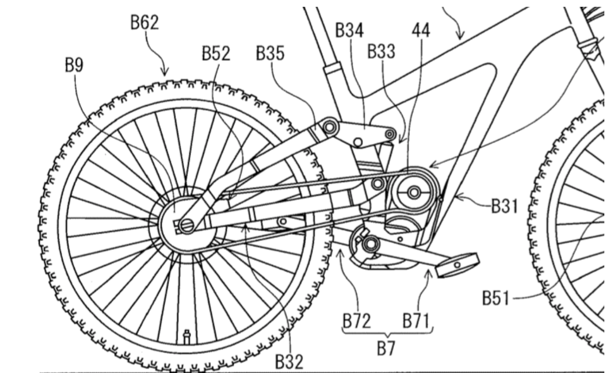

I read somewhere the new Shimano will came with a integrated automatic 13 speed gearbox on the motor ... too good to be true or too bad for reliability depends how you see it
They filed a patent for an internal gearbox design, that didnt specifically mention a motor, but in the drawings it looked like it was attached to a Steps type system.
