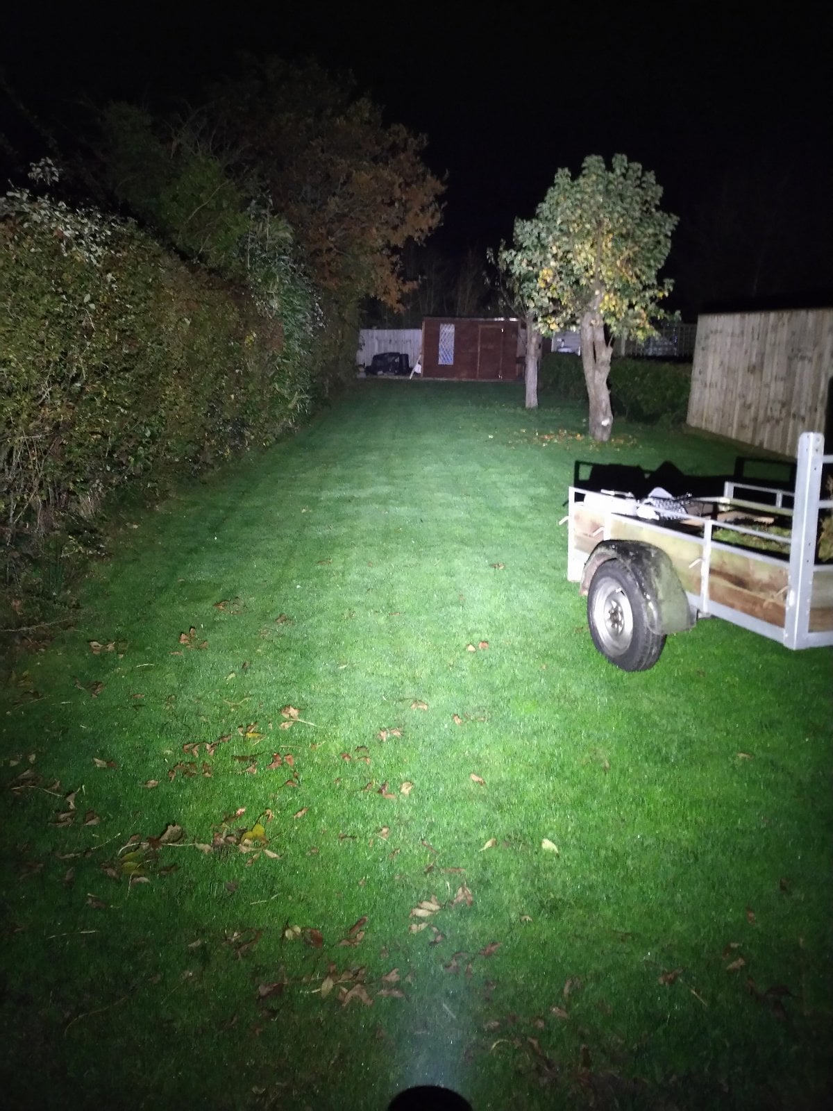

This is the best of the cheap generic Chinese lights I've seen. It comes as just a light head, you need to pick a battery and charger from the same website. Still wouldn't charge it in my house though.

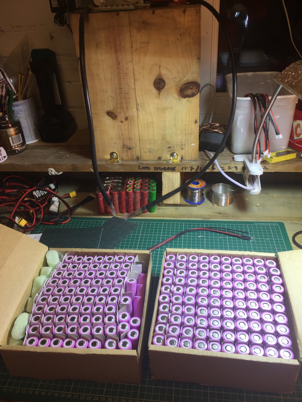

I’ve had Kentucky fried fingers quite a few times building large battery packs for DIY ebike builds. From reclaimed laptop cells, to high discharge 18650’s to even more volatile lipo packs. Last pack I built was 84v 27ah. As stated somewhere above by another….. Over a decade of learning and reading on my own in the man cave. I still have a home made spot welder too….. but I ain’t got a lathe.

Haven't measured it. But at 3000 lumens from an XHP 70.2 it'll be doing around 150 lumens per watt. With driver losses etc 25W to be really conservative. So roughly 3A from a fully charged 8.4v pack at full tilt.
I've used one for a couple of weeks, the middle setting was more than enough to get you to the trail head. I know I said buy a battery pack from the same website, but any 8.4v lipo pack will work just fine with it.

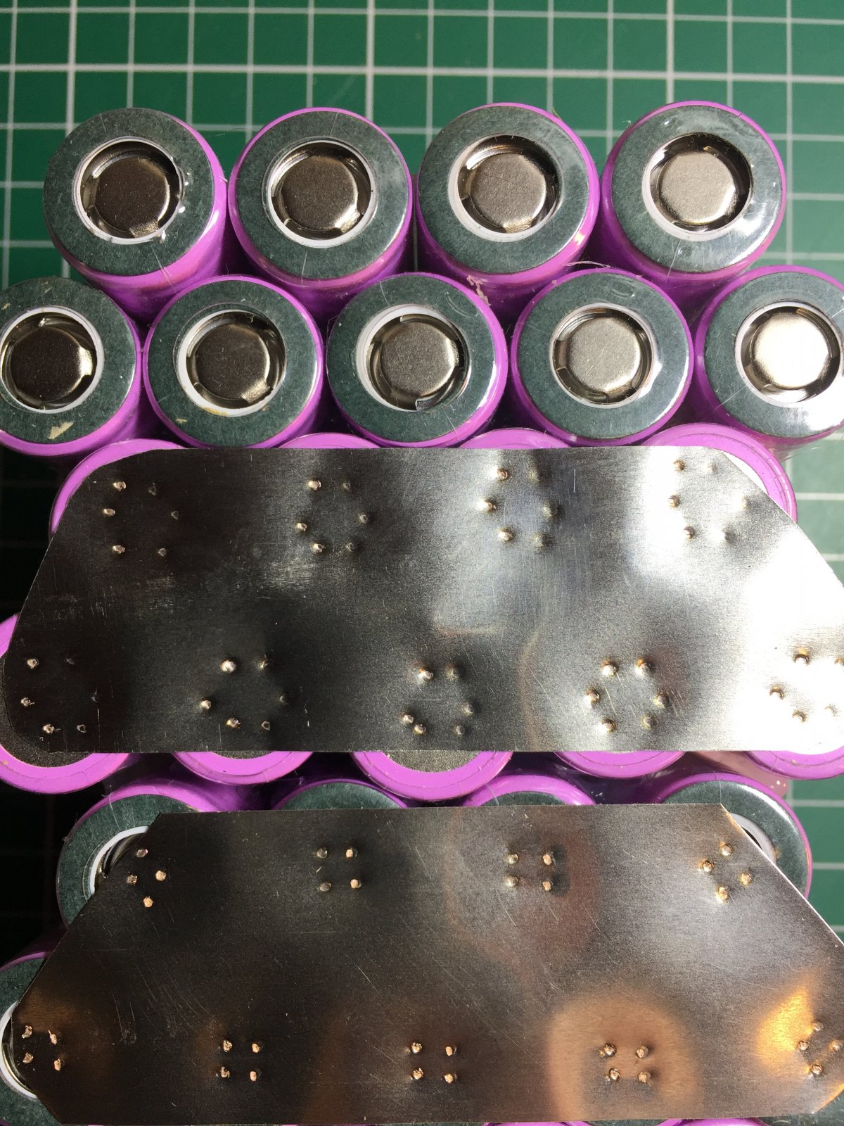

Scary when you come to spot weld the other side isn't it? 🤣
I just put them in parallel groups first to get 4.2v strings of what ever Ah, and then add together these in series. It can get a bit sparkly along the way for sure. 😮

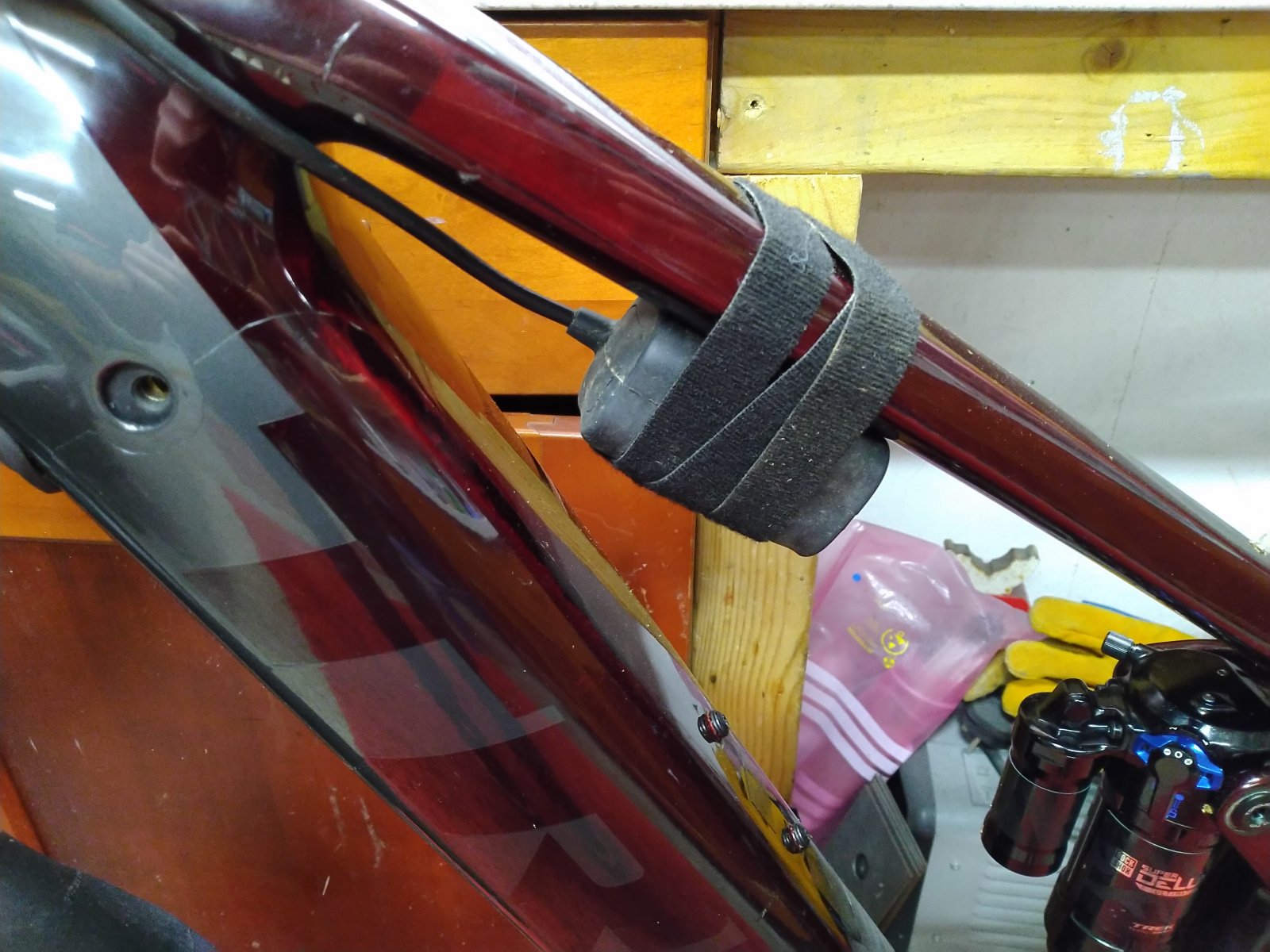

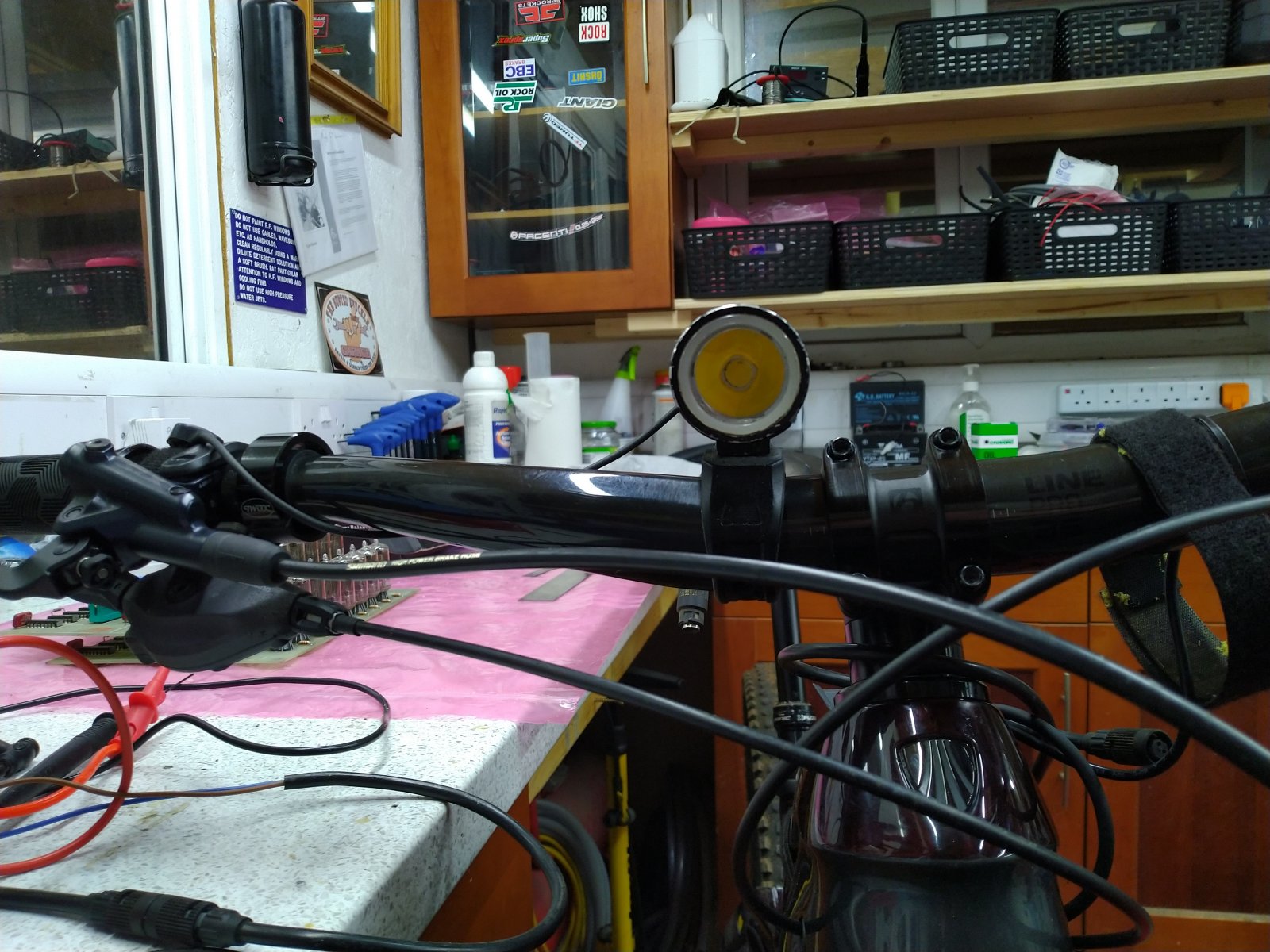

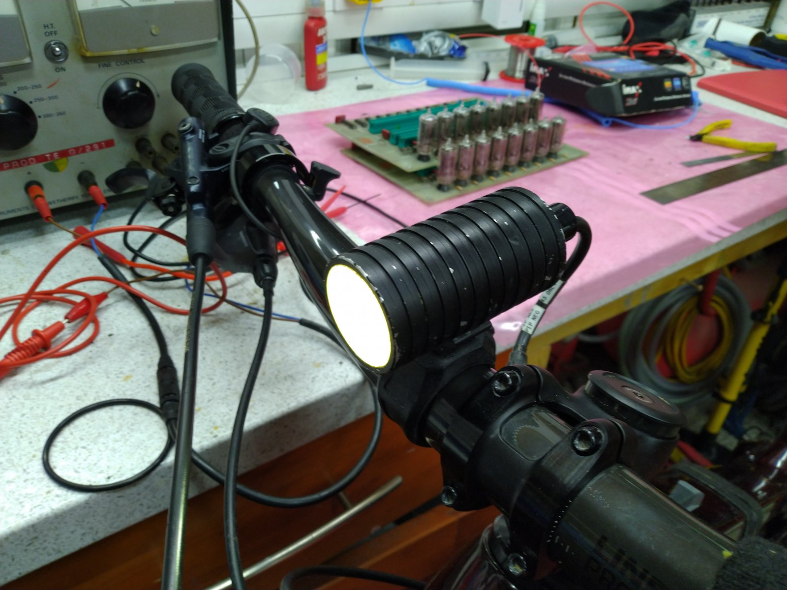

I tried to put a budget light set together using the XHP70 with off the shelf aliexpress parts last year.. It worked, but battery box & wiring let it down. Also light was too heavy for the rubber band mount. The cost was about £70, more now and + vat. My Hope light has developed a wiring fault . So the XHP will get used while that's away at Hope. Luckily it plugs into the Hope battery and I've sourced a bolt up mount now. The Chinese connecting plugs are sometimes skinnier. I'm waiting for a Sofirn Q8 pro to arrive, they are similar to exposure front lights in style and have a camera tripod thread to bolt clamp to. £53 in the sale. Could be a good budget back-up, we'll see.

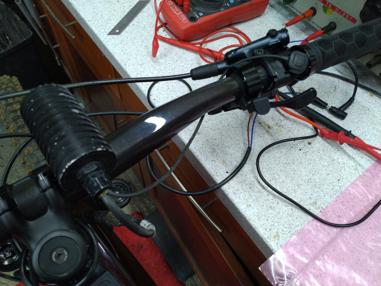

Be careful with plugging directly in to your EBike as a comparison. The Bafang series of motors have a limit of 0.5amps on their wiring, we suspect ( without actual testing ) the Levo’s are the same and thus you cannot get full power from your lights. Certainly the more powerful lights tested will be pulling well into 2 amps to get the luminance they get.

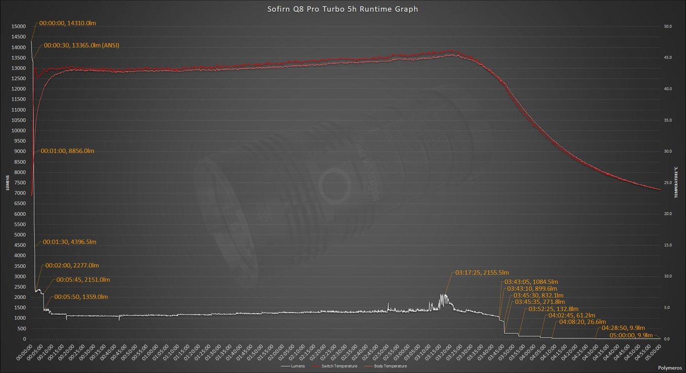

The lumen graph look's diabolical. It cooks itself after 30 seconds and thermal throttles down to a very low level. Id take a Halfords advance light over it with a warranty for a similar price. Although in the lower power levels around the 1500 lumen mark, where it's stable, it makes for fantastic run time. Their numbers seem to break physics as well :cautious:

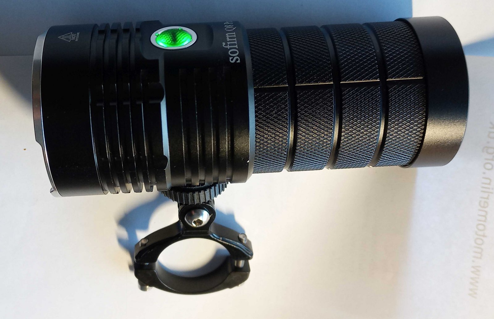

I've a couple of smaller Sofirn lights I use as a head torch. Work well, but exhibit similar characteristics, I find a battery swap at half time helps...
The Q8 has the basics - self contained batteries & (hopefully) easy rigid mount. I'm hoping the Andruril 2.0 UI will allow some tweaking.

The Sofirn Q8pro china light arrived in 8 days. Silly bright for 1 minute, then ramps down. Switches up/down power + turbo for the headline 10 snillion lumens.... Built in charger. Added camera mount & gpro bar clamp. The only downside (so far) is the weight - 600g on yer bars. Will test later in the week.
