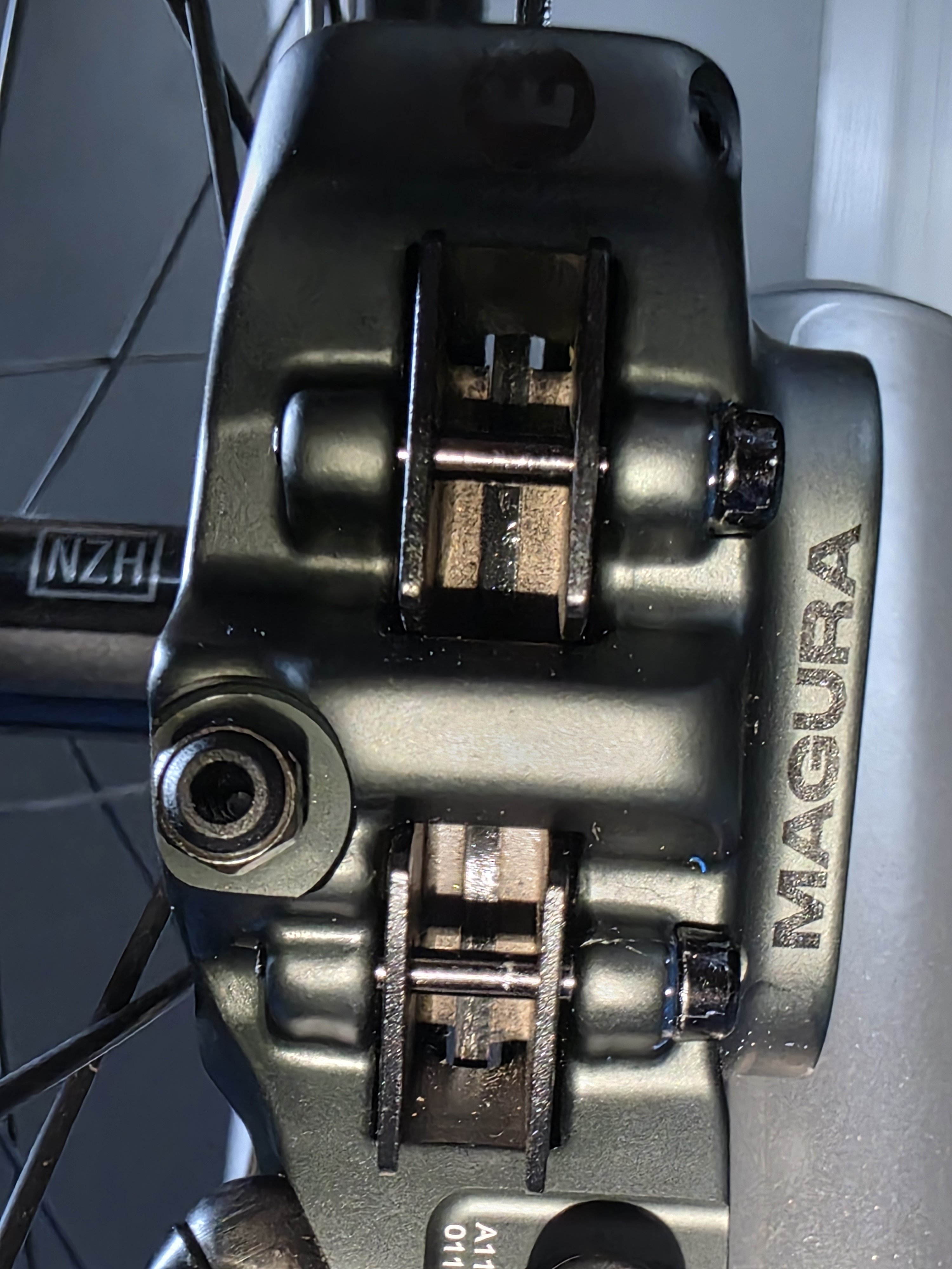

I just installed mine, but they're dragging on full wheel rotation, annoyingly. I think I probably need to remove the pads and open the lever bleed port and push the pistons all the way back in. Is that right?
There seemed to be plenty of room before installing the wheel, but the lever went right back to the bar. I pumped the lever a few times to get the pressure up and now the pads rub round the full rotation of the wheel.
I'm struggling with fitting these, not sure if I'm missing something.
I fitted them and the pads were rubbing the full rotation of the disc, so I removed the wheel and pads, opened the bleed port on the lever and pushed the pads back in. I also did a piston massage on all the pistons and used a cotton bud to apply Royal Blood to the piston sidewalls. Then put the wheel back in and... Still rubbing full rotation. I had the caliper loose and pulled the lever whilst I tightened them down, but the caliper ended up just touching the disc on one side and still rubbing full rotation. Then I straightened the caliper out so the disc was more central and it still runs both sides at once for the full rotation.
Weirdly, these calipers don't seem to have any sort of pad spring to push them apart when you let go of the lever, so I guess they must just rely on the magnetic pads following the piston back in. But that seems like a bit of an ask...
Any help from those who managed to get them working properly would be very well received. Thanks!
Are your rotors the ones that came with the brakes, or a different make, as it looks like the pistons are all the way back and no clearance?
The pads don't need a return spring; they are magnetic. works really well once the calliper is set up straight using the little yellow alignment tool for the brakes.
Yes, it's the rotors that came with the brakes. Though TBH, I'm not sure that anyone else does rotors thicker than these. The Gustav Pro uses 2.5mm rotors!
Yeah, I know the pads are magnetic, but you're then relying 100% on the calipers pulling the pads back with them.
When I took the pads out I pulled the lever and the pistons didn't move in at the same rate. Usually just one side would come in. Even after putting some royal blood on the sidewalls of the pistons and pushing them in and out 10 times each they still don't move out anywhere close to uniformly. I'm not sure if that's normal or not. Either way, it doesn't really matter when it appears to be dragging both sides at once for the full rotation!
I'm at a loss.
