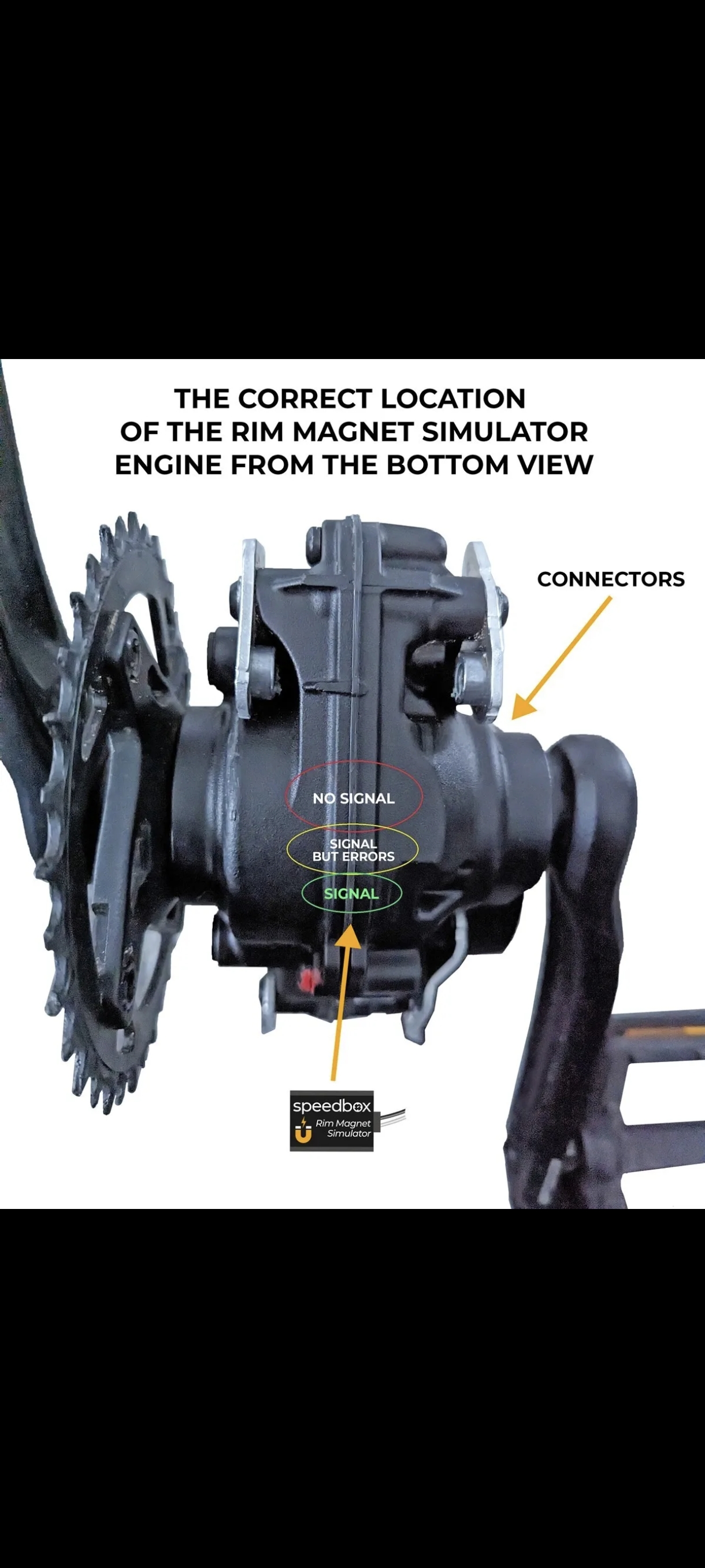

Anyone received their Speedbox 1.2B (Bosch rim magnet version) yet?
Did u see this picture yet ?

I tried to give the 1.2B every chance and spent approx. 8 hours taking the motor out, move, ride, out, move, ride etc.
after a while i didn't bolt the motor fully back in to enable minute adjustments in position with tape. I got it working a handful of times (always in the same position) but it quickly went into fault. I estimate i tried 20 minutely different positions around the area indicated, always returning to that one successful location.
I spoke directly to the development engineer who provided that same diagram and we swapped photos, magnetic flux readings and conversations.
In the end he admitted to me that i should get someone to convert the firmware to wheel magnet setup and use one of their simpler setups. The distributor took it back without question as she was aware of the effort expended and admitted that i wasn't the first.
I don't hold any grudges, my conclusion is that at one stage it did work with the early firmware. Bosch have done a better job than most at creating an anti-tamper environment that monitors a variety of parameters to identify tampering.

Received my Speedbox 1.2 today.
Spent approx. 2 hours fitting it to my Canyon Strive:On, but getting error 523003 (speed sensor not working correctly)after trying 3 different signal generator positions. This involved repeatedly taking the motor out of the frame.
I suspect that the positioning "sweet spot" for the signal generator is so sensitive that its going to take a couple more hours of moving it around. What isn't helping is that the Strive:eek:n has no display, so you cant spin the wheel and look for a response on the display.
I ran out of patience and will have another go tomorrow, after that will speak to Speedbox help.

  • The pictures suggesting the installation position of the signal generator are poor and could be clearer and consider that the Bosch motor is fitted in a number of frames and orientations. This would avoid so much experimenting.
Hi Dom , I'm having similar issues , keep getting error 523003 , taking motor out repeatedly. Did u see bikespeed.de , they have a working solution it seems a bit easier with a display included still cheaper than the speedbox .. thinking of trying it out myself .

I actually went with the speedfun for rim magnet instead , will post back with results . Speedbox 1.2B not working for my bike/frame etc, tried for 2 weeks straight ..
Any news?
Just make sure to take out motor and it can only fit in one position , use double sided tape to stick on place , I used gorilla tape, working great no issues , just follow the guide and worked first time .
Hey , works a treat , and near half the price 👌🏻

Does it involve placing a electromagnetic coil on the case of the motor?
On my strive-on i have limited room in the frame.
Could i trouble you for a photo of the instructions or a photo of the location of the fitted coil on your bike?
